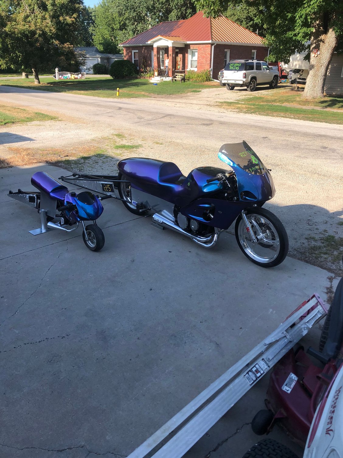

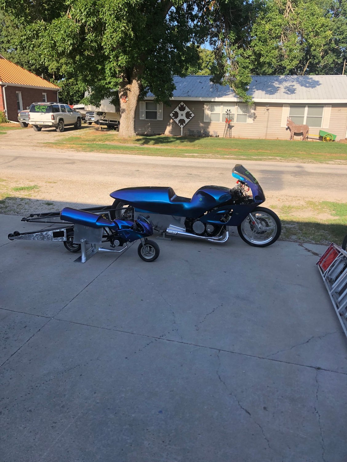

You running NHRA Pro Stock bikes? Who are you?

Not nhra bikes

Originally Posted by S10 ls
Not nhra bikes
Gotcha. Still your a rockstar to me. Freaking awesome acceleration!

not a rockstar just a normal guy who works 8-5

Which bike do you ride? Kidding bro. Nice stuff man.
