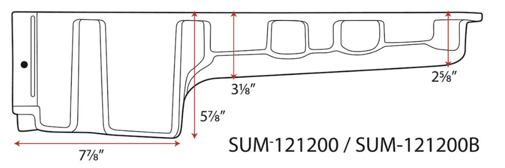

Btw, what oil pan and engine mounts do I need? I cant find any swap parts for gm b-body 65-70.

Thank you for thinking of choosing our SUM-8701 camshaft for your project. This camshaft will provide good mid-range and top-end power. It will also have a slight lope depending on where the idle speed is set. LS6 springs are not required but it would be a good idea to go ahead with new springs since you will have the engine apart for the cam swap. We would recommend to go with the SUM-8701-2-BHV camshaft kit. This will come with the 8701 camshaft, LS6 beehive springs, valve seals, harmonic balancer bolt and gaskets and o-rings to help complete the cam swap. For lifters we would recommend the SUM-HTLSKIT LS7 style lifters and lifter guides.As far as pushrods we would recommend to check for pushrod length once the camshaft is installed with a pushrod length checker and we offer the TFS-9501 to do so.
We see that your also looking for recommendations for an oil pan and motor mounts. For the oil pan we would recommend the SUM-121200 oil pan kit. This includes a new LS swap oil pan, pickup, gasket and hardware. For the motor mounts there are options depending on the stock style mounts you have and the placement of the engine that you would prefer. Follow this link to view the options we have available for you.

Is that pan flush to the crossmember? Im putting air ride on it and dont want any troubles regarding the clearance of the pan.

We cannot confirm if it would be flush to your crossmember but we can show you the dimensions of the pan to give you a visual reference.

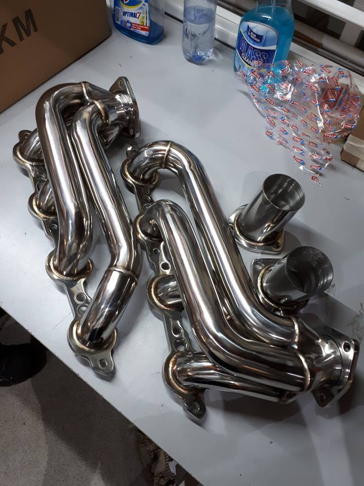

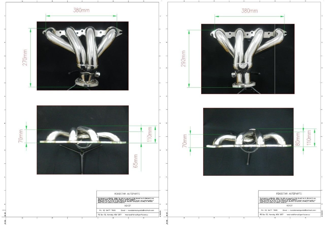

So I almost got everything for the engine, I've got the cam bearing tool along with the cam bearings from summit racing today. I've started looking at headers, do you guys think some of this two would fit the 65 B-body?
