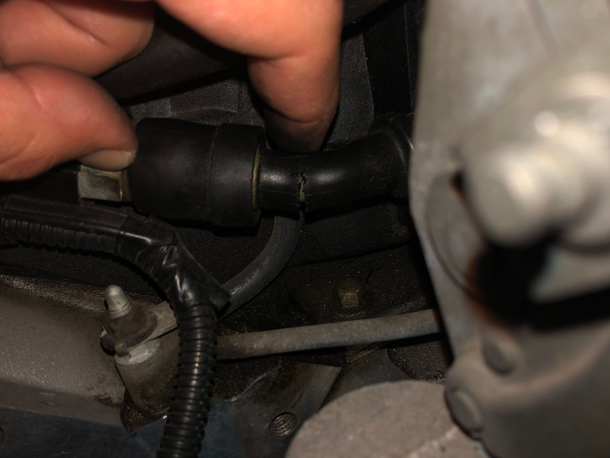

Beyond that I did find that the return line after the PCV valve is in extremely bad shape and is ready to crumble any minute. You can see the large tear below!! I wonder if that leak after the MAF would suck in unmetered air at WOT. I didn't feel any suction at idle or 30% throttle (again it was late Sunday night).
Crack found in line after PCV valve going into intake manifold.

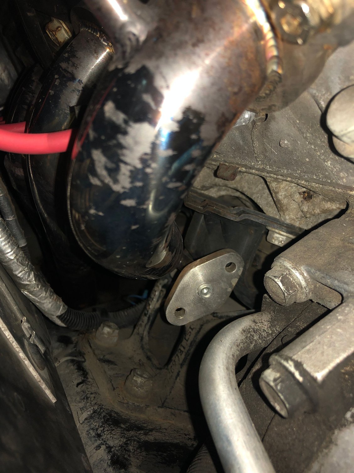

I also noticed my passenger side header has some sort of accessory pipe off of one of the runners that is maybe 1 cm away from what looks to be the engine mount? Maybe I can remove that plate and leave the tube capped to ensure it isn't knocking against anything at WOT causing false knock.
There's a little pipe that comes off of one of the header runners that is a pinky finger thickness away from contacting what I think is the engine mount.
I'll follow up once I fix the PCV valve if it fixes anything. Now might be my opportunity to install a catch can while I'm repairing the PCV line.
