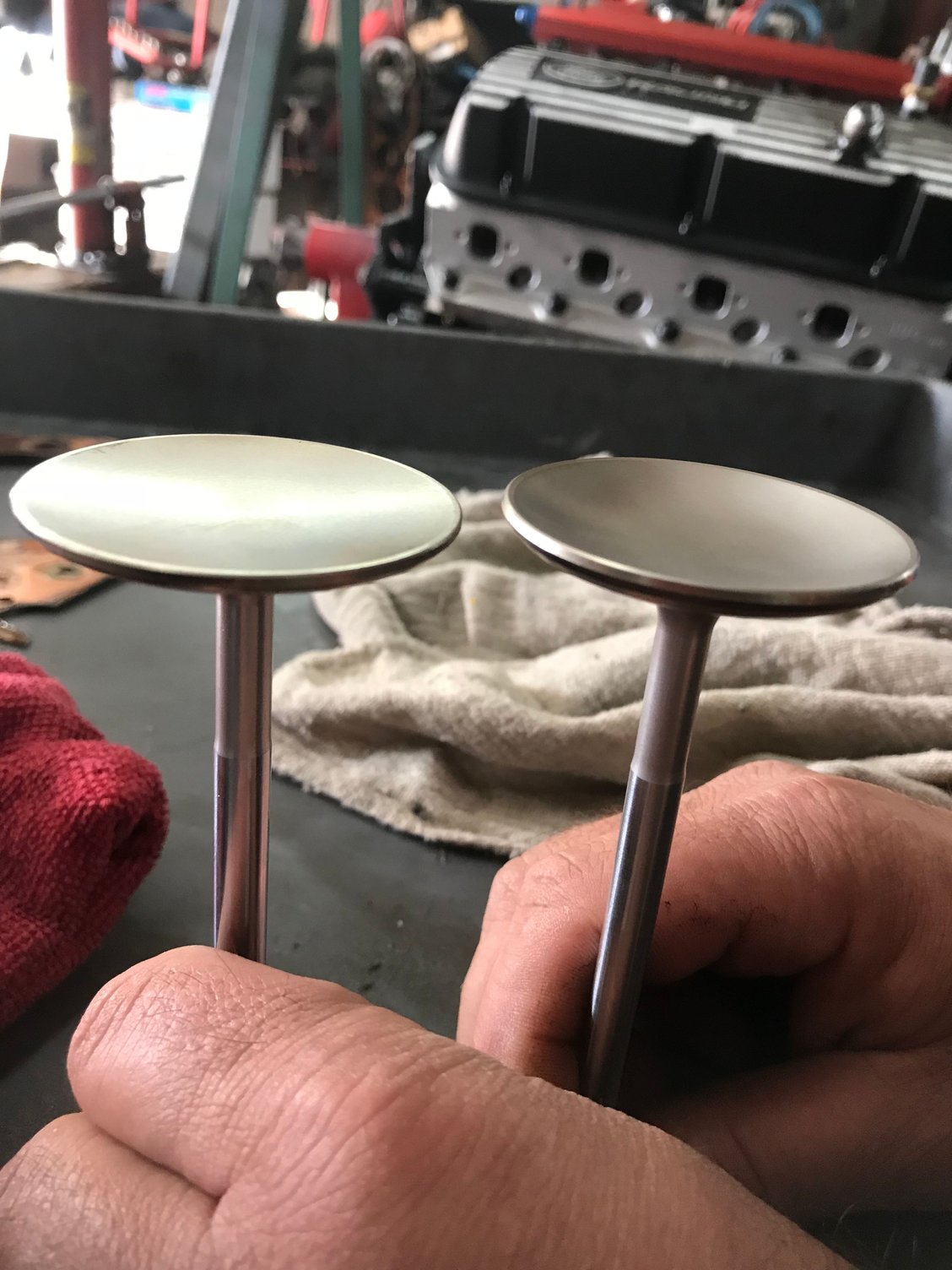

Ive seen multiple trick flow castings broken in the same spot along with now 2 customers that got trick flow ls3 heads and had the valves taco because as tfs put it when i talked to them
"were they running a helluva lotta boost?"
"How much is a helluva lot?"
"Over 15lbs"
They were running in the 20s and apparently you have to upgrade them to the manley severe duty valves but they dont advertise that anywhere on the site etc. Thats at least $320 more on top.

Here are a pic of the tuliped valves. Customer had to get the severe duty from manley for $360 or so. He was definitely not happy.
That was when i verified and called tfs and they said what i said previously. its definitely not advertised anywhere either.
