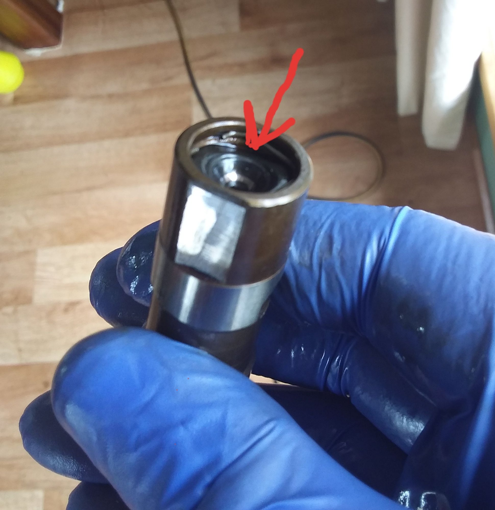

Hi I was a little concerned that I would encounter the same issue with my 2148 SE lifters so I asked Hylift about it this was the reply below in blue.
​​​​​​On this subject previously when I ran my stock LS1 lifters with a BTR 219/224 .551 lift cam I didn't check my preload and noticed on disassembly it took five to six turns of rocker to take up preload and this below in pic was the result after running it for about 7000 miles. There was no ticking or sign that anything was wrong.
The cam was sold to me as one that could use stock pushrods, the motor was stock. After this I'd rather have too little preload than too much and just check it more often. Although this was on a stock lifter.
I was just lucky the cam was still in perfect condition and the lifters didn't self destruct.
