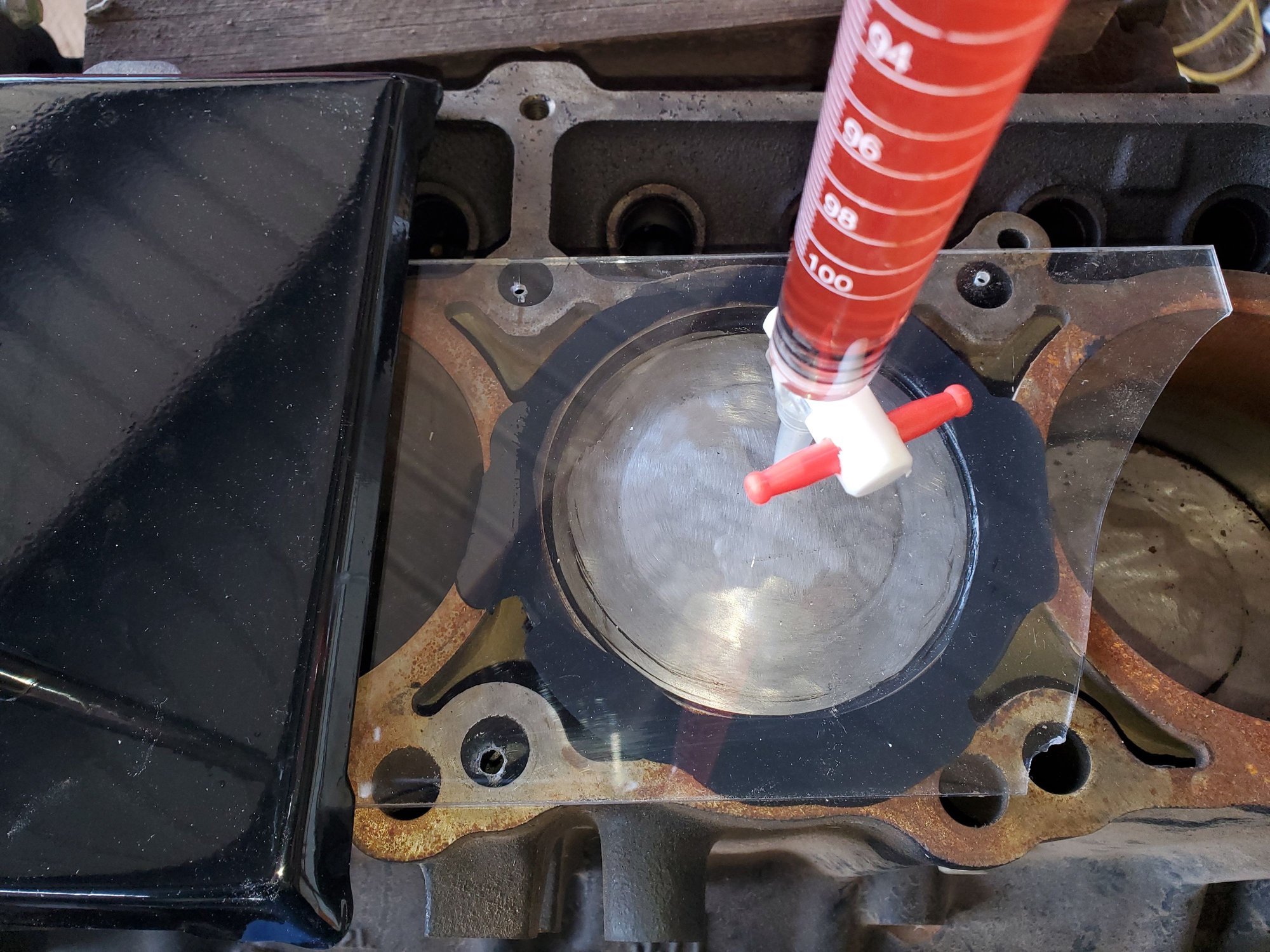

Depends on valve size but likely -2cc to -3cc avg.
I have this tool to measure to the .2cc also to get a good idea
Or clay also but its more hassle
Also thats me sciencing the heck out of a G3 hemi.
