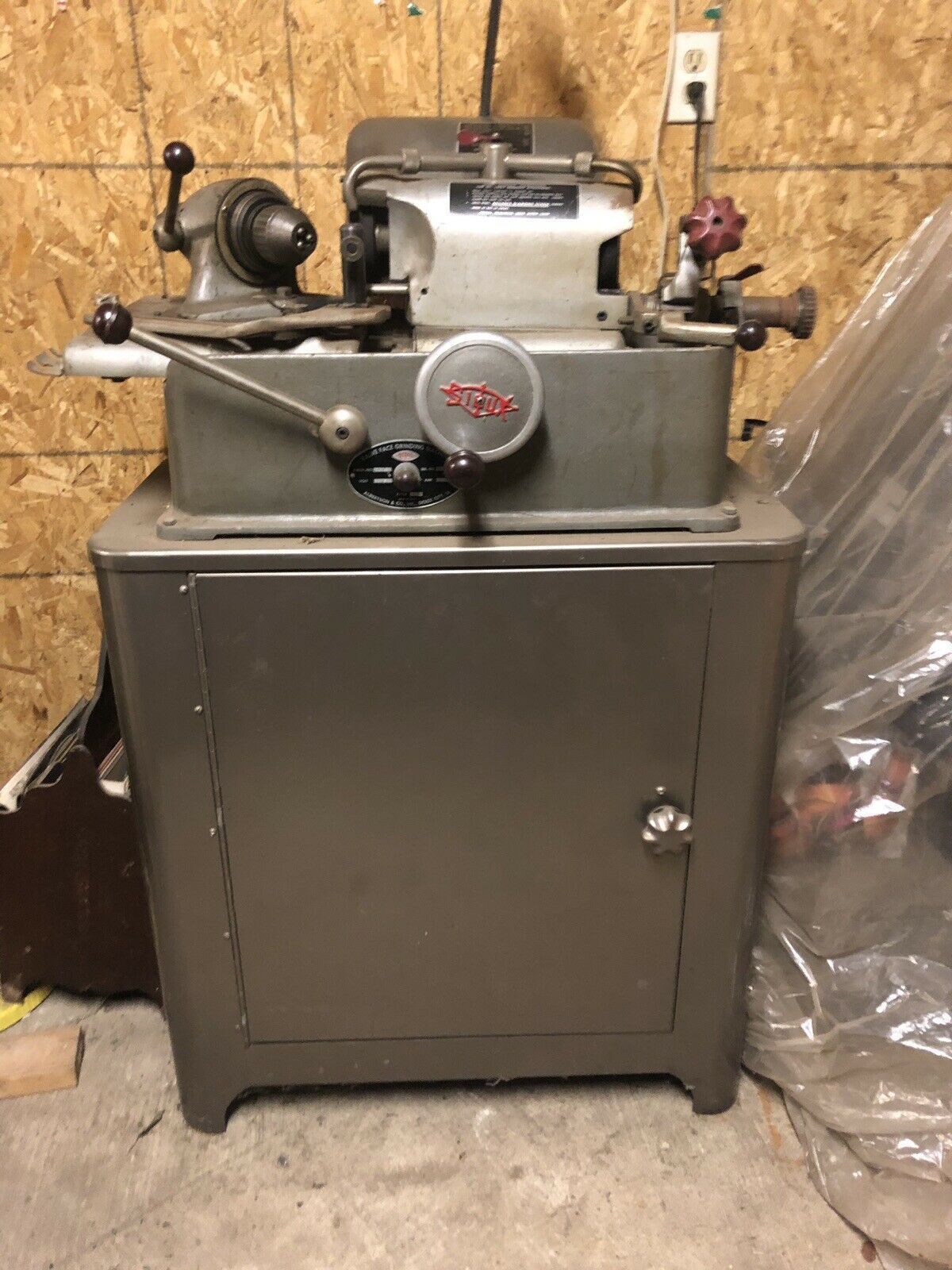

I chuck everything like valves and pushrods up in my old Sioux valve grinder, and give them a spin...
