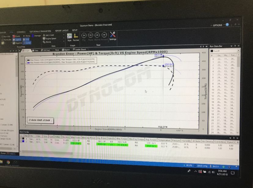

I have the SNS Stage 2 and PRC 225s on a SBE LS1. That + fast 102, Warr 102, TSP headers, Hooker Black Heart duals produced the graph below on a rushed tune. I dont get hung up on numbers, but that torque curve speaks for itself. The times are different at the moment, but I didnt have any problems with TSP answering questions when I bought the heads. Tick also was very helpful. Heads look and perform great, in my opinion. Recommend Manton 11/32 pushrods as well, fits perfect with these heads. Be prepared to push your tuner to focus on the idle, or buy hp tuners and do it yourself, which is what I ended up doing. The overlap on this cam requires time and patience to get idle and return to idle to where its not a pain to drive. the graph tops out at 6k (rushes tune), but it pulls to 6600-6700 no problem.
