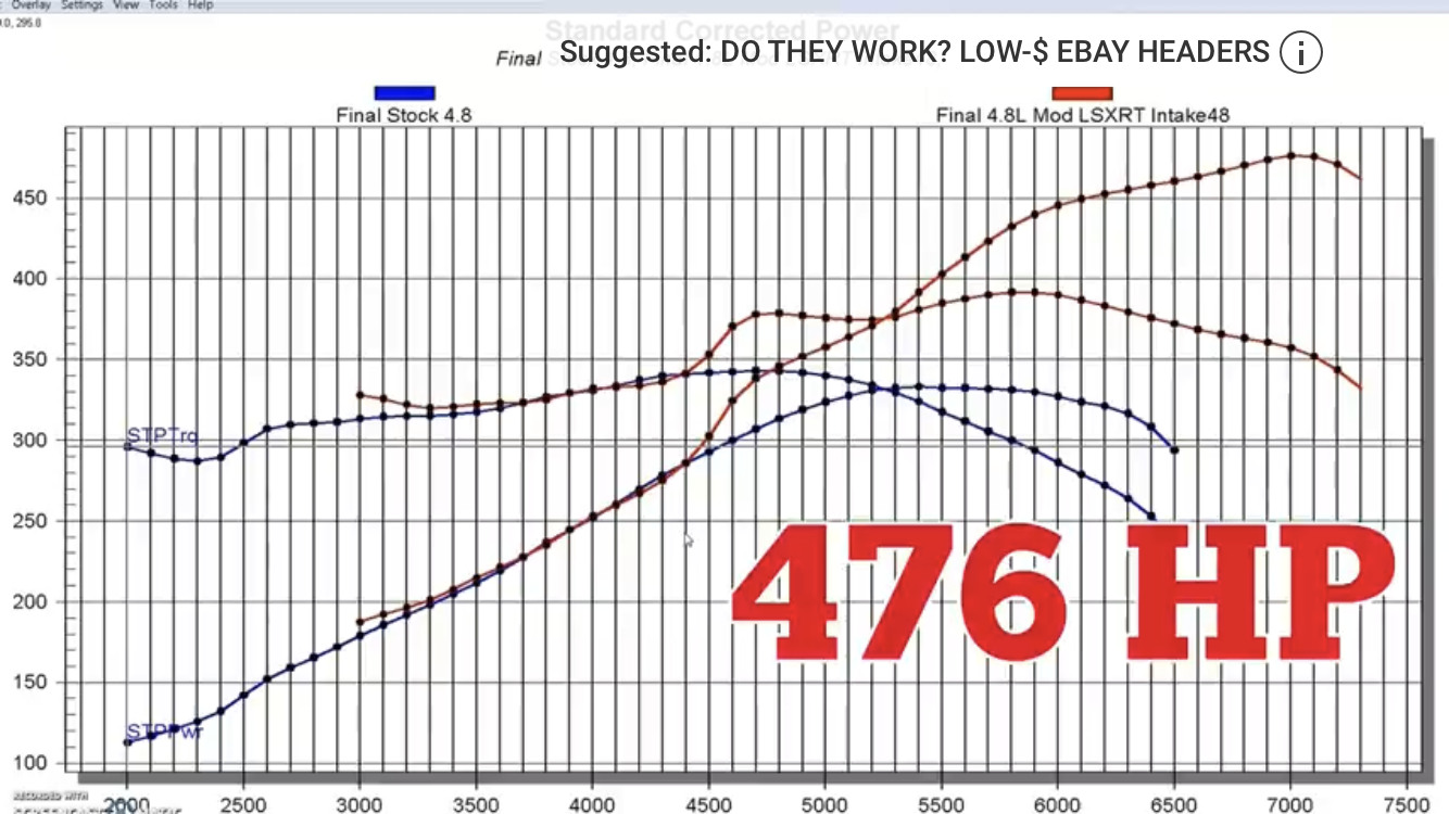

In that dyno I posted above that was a 4.8 that Richard Holdener ran. It had a Fast LSXRT manifold.
That quick drop at the tail end of the run......is that because of the manifold or the cam?
Ive gotten tons of mixed feedback on manifolds and I was almost convinced to go with a Holley Sniper (tall version). Knowing this was going to hurt mid-range I was skeptical but I’ve gotten quite a bit of feedback saying that even on a small engine it’ll stop breathing at 7k
Im far from knowledgeable on this so it’s frustrating
Was the cam in that holdener dyno the same cam in your OP?
manifolds are a whole other topic. I don't think the LSXRT ran out of breath up top so much. The runner length plays a huge factor in what RPM the engine will do its best. Long runners will bring the rpm band down. You can cheat it with cam up to a point, but eventually the intake dynamics will take over. In my own testing, I had a fast LSXR long runner on a 5.7 that hit 6300 rpm and carried clean to 7000, but the power peak was at 6500, and it was very flat. I put a MSD on, and the peak power moved to 6900, and the power carried out to 7500. But i was down on torque below 6400 rpm.
BUT -- a smaller engine with the same top end will generally make the same power at higher RPM, which is what you see in that dyno -- it peaked at 7200. More often than not, when I see a sharp drop after peak power, it comes down to two things:
1. overlap - overlap helps carry power past peak. At nine degrees of overlap, on a 310 CI motor, it should have plenty.
2. valvetrain stability -- valve float, lifter pumping delays, flexion in the pushrods, all these things contribute. As RPM goes up, the weight of that valve goes up exponentially. At 8000 rpm, that valve instant weight can exceed a ton, and it's being supported by that rinky-dink steel tube and a tiny spiring under the lifter cup with an assist from oil pressure. Don't fool yourself about the oil pressure. it maintains zero lash, but it's not overcoming 1-ton of force. This often collapses lifters that are not designed for the RPM and valvetrain weight.
Regarding overlap, i really do think there is enough in either cam to help carry the power past peak. Valvetrain stability is the main reason I like solid valvetrains. You take the lifter pumping out of the equation. Run a beefy pushrod, and you eliminate flexion - or at least move it to a higher RPM. both allow you to run higher springs for increased stability.
Another way to compensate for the lifters is to run something like johnson 2126 short travels. These will take you to 8K while staying hydraulic. you'll have excellent valvetrain control.
Sorry, that post was longer than I meant for it to be when I started.

No that dyno was with a 224/232 .590/.590 114LSA cam.
The one in my OP was recommended by him to get at the power I’m hoping for with a 4.8 (a little bigger @5.1 in my case)
On manifolds......Against the judgement of most for this kind of engine I’ve considered a TBSS intake even.
I thought it may actually be “OK” on this small engine in those upper RPM’s.
The FAST is on the radar for sure and the bright side is it seems used units sell for almost new prices.....If it doesn’t work like I’d hope I can always get most my money back.
