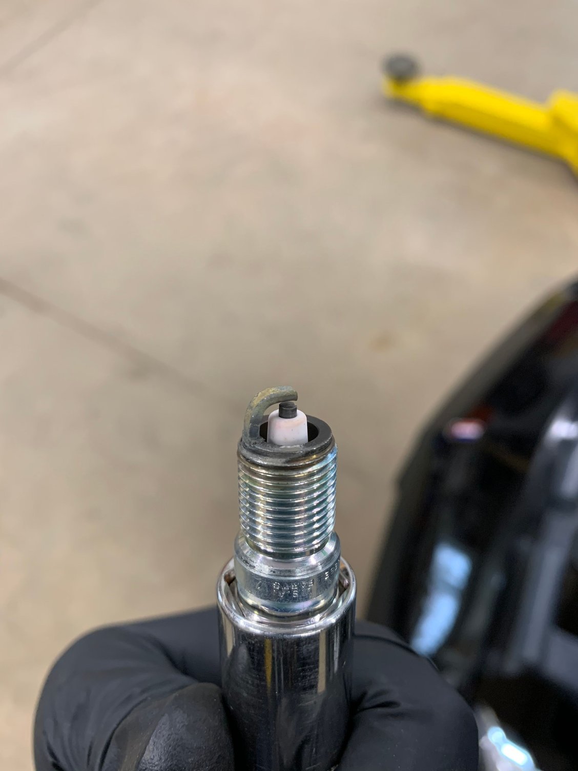

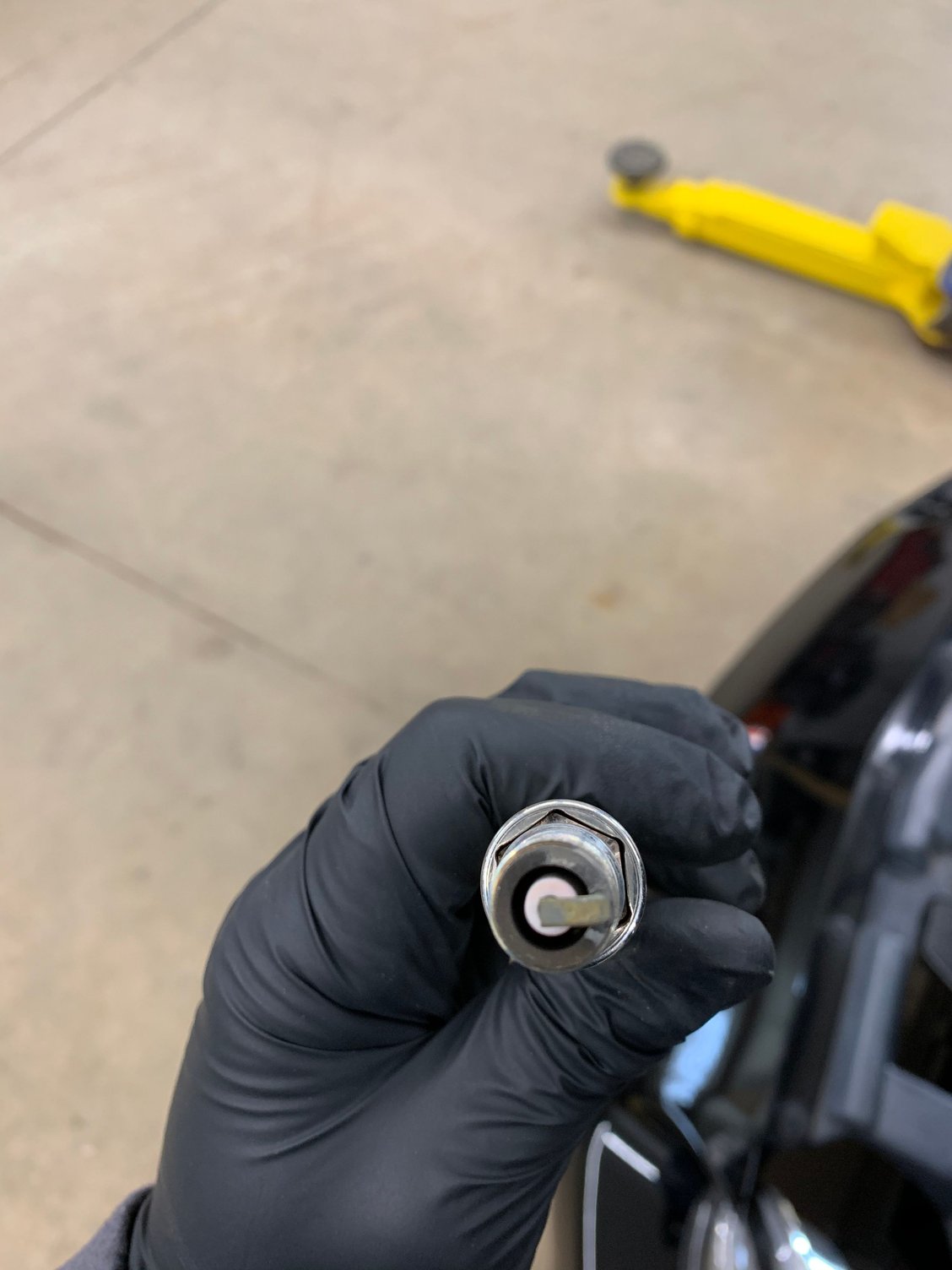

Do these tr6 plugs look too hot? Should I switch to a tr7? This is a n/a 12.75:1 large ci stroker running on e70. Wot fueling is perfect, 28 degrees timing no knock.

You have more than 1 turn of color in the threads so I would say yes by those pics. Should be able to swap and try a 7 and see how it does, pretty easy to do.

I had a feeling they were too hot, but wanted to here it from someone with more experience with them. I'll order some 7's and try those. Thanks!

I ran br7s in my big compression e85 motor.

I ordered some tr7's the day I posted this, I'll throw them in the day I take it to the track and see what they look like.
