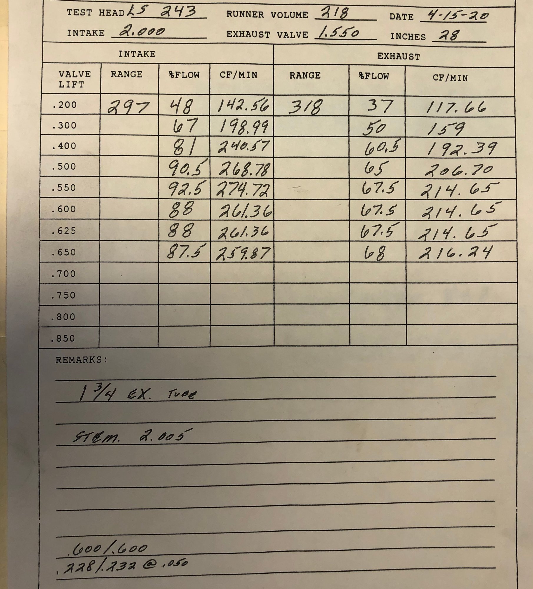

Local guy did a comp valve job and some slight bowl work to a set of stock 243’s...not really “ported” or hogged out. Intake is ok, exhaust looks really good.

Intake flows well at 550 lift, so bolt them on and run 'em.
Those look like pretty good results from just a vj .Did he reuse stock valves , do you know the angles he used on the intake

Nice! Do you have pics of the work? Did he blend the valve seats in?
Look good to me! Should be a great setup with that cam spec I see at the bottom of the sheet there.
