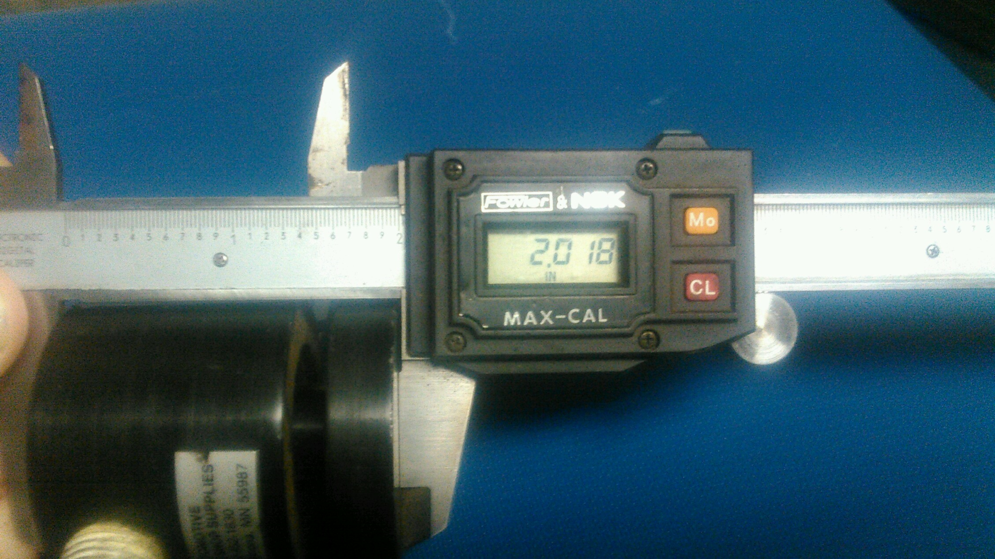

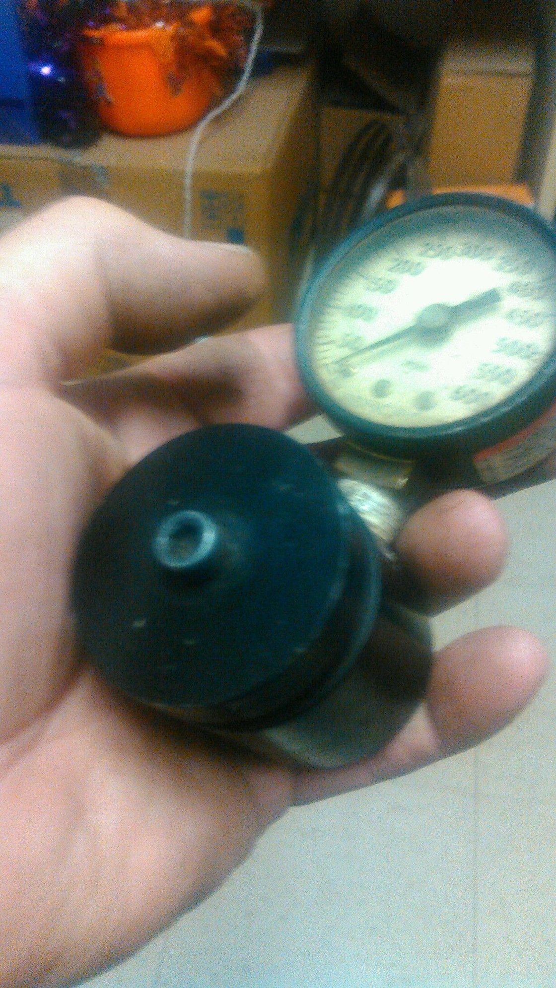

I have an old Goodson I've used for years...don't know exactly how accurate it is....I think it's pretty close. it's a good tool to check consistency across a set of springs.
Size...

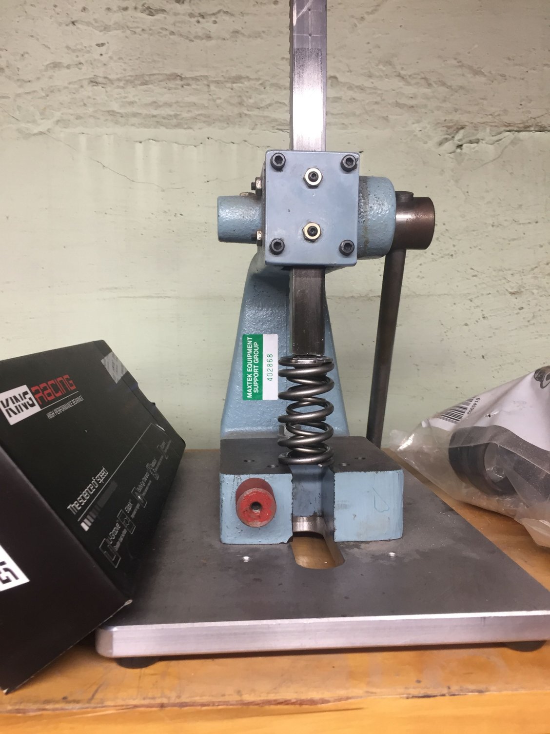

Thanks! So if the length where the spring sits is 2” or so, it would work.
Here is my cute little arbor press.
Looks like it should work...I can measure it tomorrow, I'll let you know.
I use an adjustable table drill press. Set to whatever height measurement I need.
My old Goodson is right at 2"...

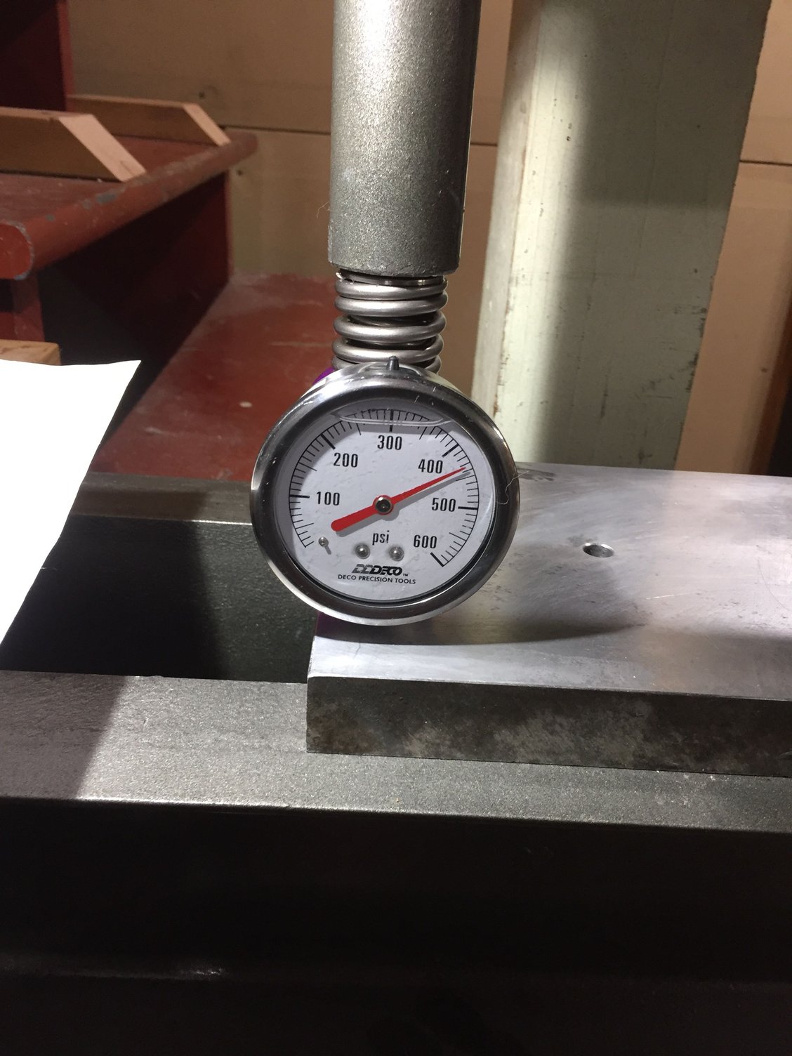

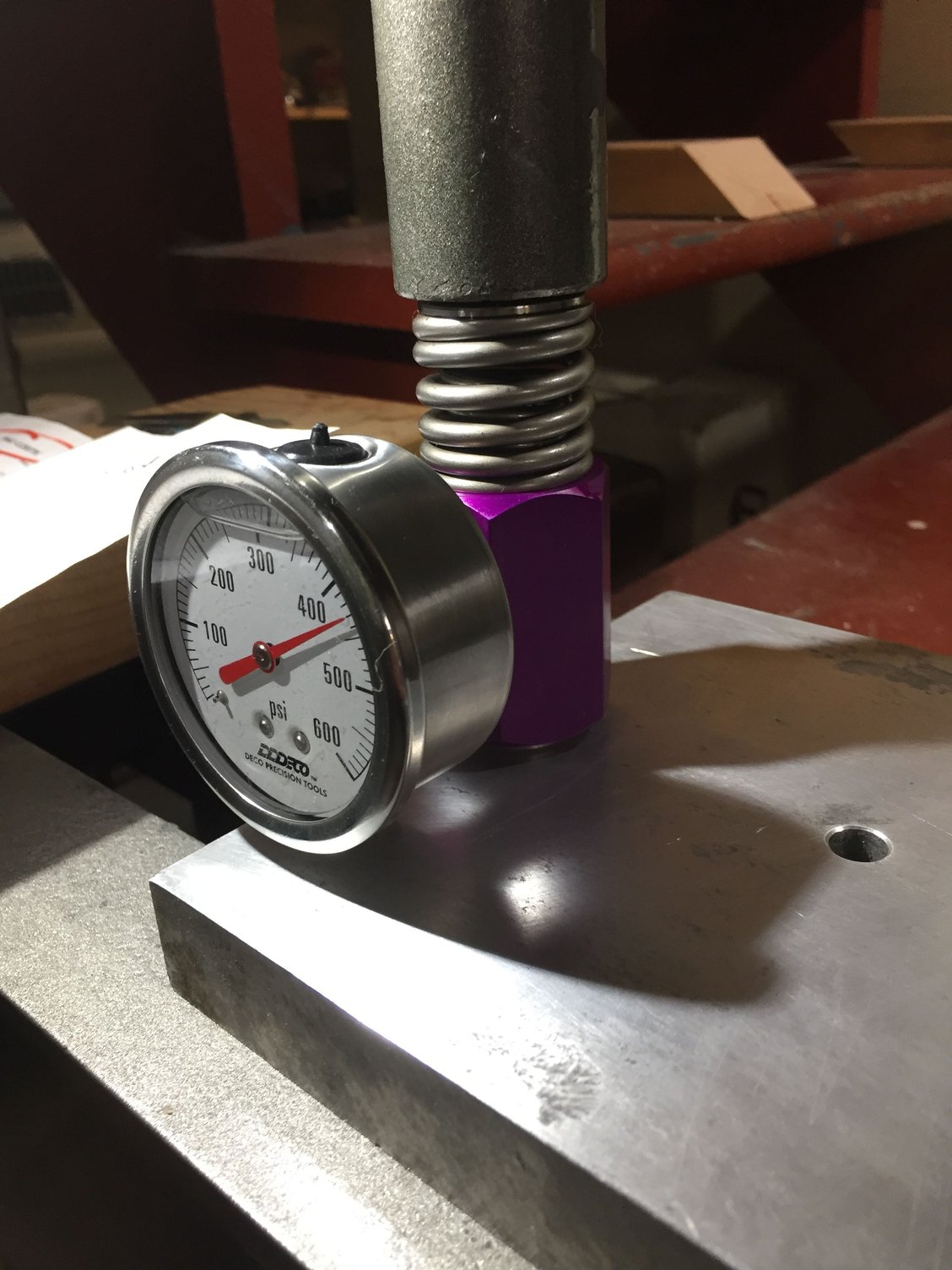

So got the Speedway Motors checker yesterday. $54, but $15 to ship. We get spoiled by that free shipping!
Set it up in my Horrible Fright hyd press and tested a couple springs.
First spring was the AFR that I’ve been running. 20k miles.
1.80” was 135 lbs (spec 155)
1.20 was right at 400 lbs (spec 425)
So tried a new PAC 1207x spring
1.80 was 155 lbs
1.150 was 435 lbs
These numbers are right at spec.
The tool not only works, it appears to be quite accurate.
Ron

I try to follow up with results, good or bad. I know how frustrating it is to end up at dead ends when looking for info.
I rechecked the AFR spring specs, and I was correct, they have lost 20+ lbs.
These PAC 1207x Springs are good to .700” lift. I think they will work fine at .610” lift. With the heavier valves and ultra heavy YT rockers, needs good springs.
