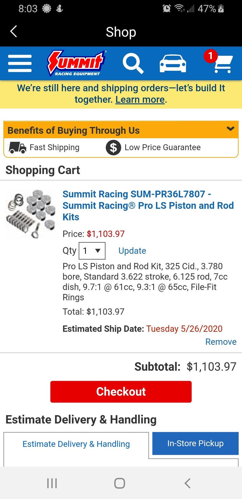

Summit piston rod combo. Any one run them

any luck. Tou guys all do a rebalance with these. I heard people just bolt up and go
