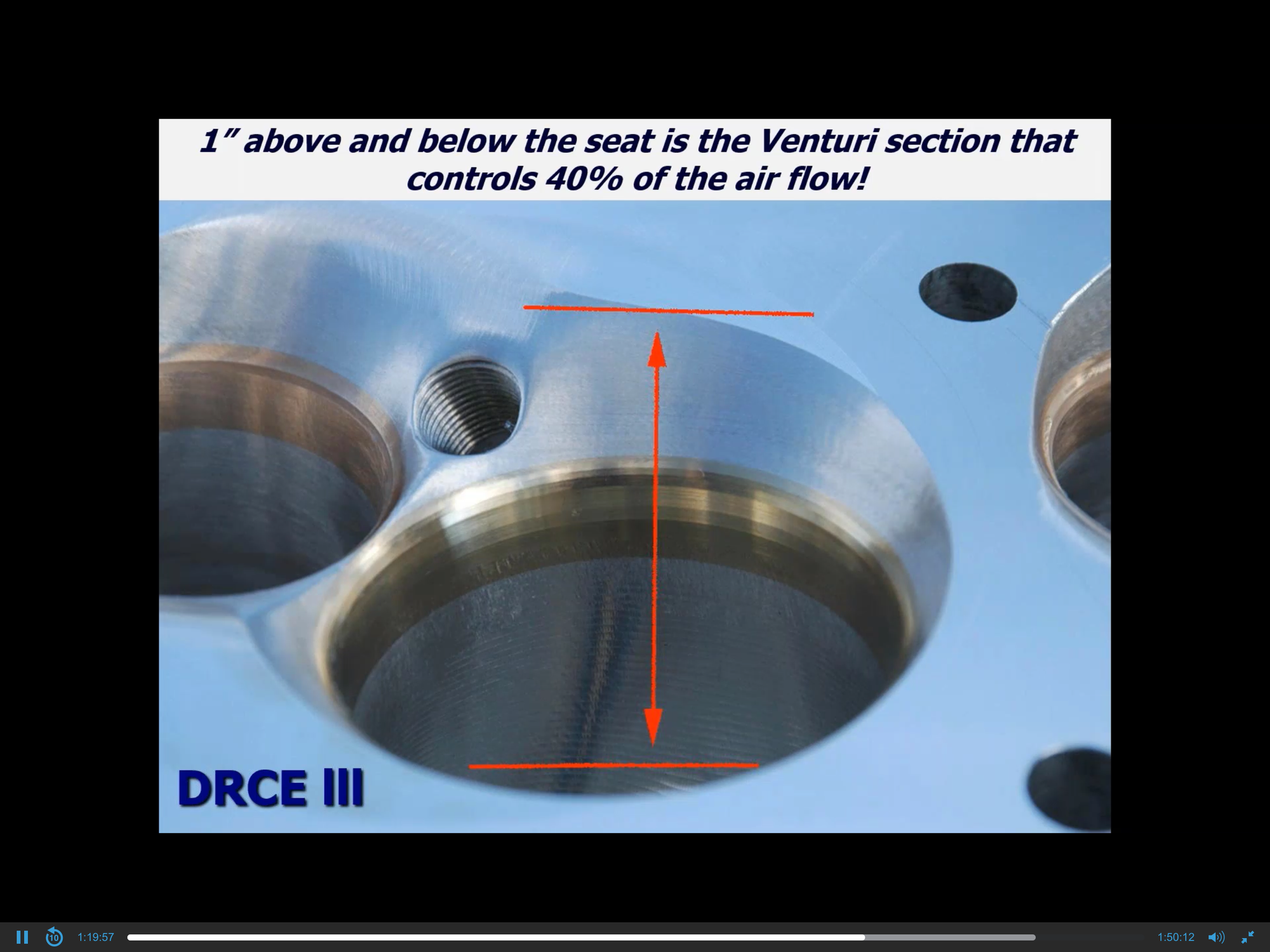

It isn’t that small chambers hurt flow, if the chamber was designed that way. What hurts flow is cutting a chamber down significantly in such a way that you disturb the Venturi effect. The area of the port 1” above the valve seat and the the area 1” below the valve seat (into the chamber) is what makes up this Venturi area. This area is designed and tuned by the manufacturer, so in some cases milling will hurt performance. And in other cases, unless it’s a high end casting, a nicely done CNC port and chamber blend job really wakes up the casting. Cutting the chamber down by milling enough material away to disturb this Venturi will hurt flow. But you’d have to cut the head down significantly as in like .125” to make a noticeable difference that you’d feel or see on a dyno. Will show up on a flowbench, but what’s on a flowbench doesn’t always equate to a dyno or track, with either losses OR gains.
Of course there’s a trade off here, as in every aspect of performance mods. The smaller chamber (via milling) equates to more compression (given all parameters are equal) which can often make up for the flow “defficiency”. Compression makes torque and often times the increase in compression more than makes up for the ever so slight flow losses that are present.
Here’s a random pic I found for reference of Venturi area...compliments of Darrin Morgan of course...
 Michael S. Palmer
Interesting, thanks for that.
