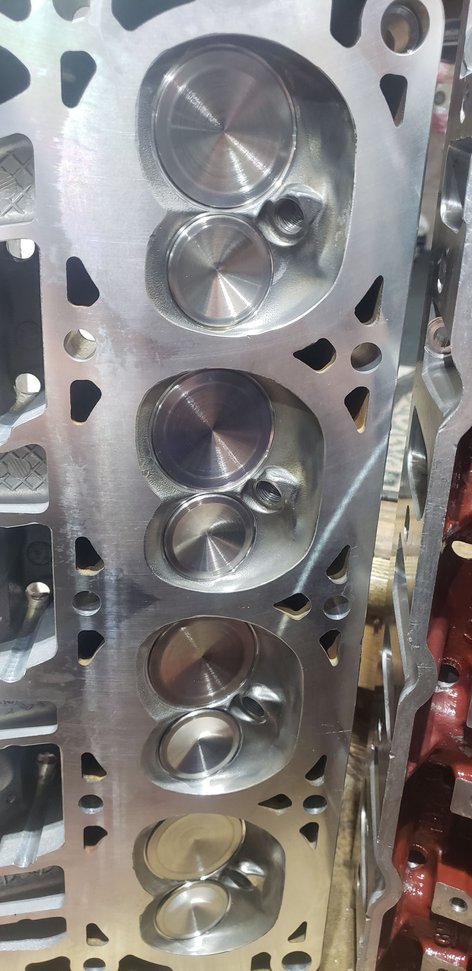

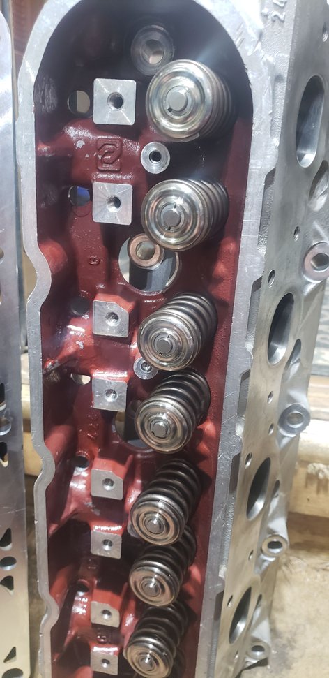

They are not stuck. Just the tips are demolished. The heads are at Unleashed Horsepower getting stainless valves installed. Never dealing with titanium again.
There is nothing wrong with titanium when you use lash caps or hardened tips.

l agree with you but for what l'm running l will just pay for stainless as the price difference is a lot.

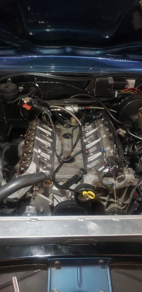

Heads are here and bolted on. Runs A ok and lm on the road again!!

Nice work!! Time to gape nerds
