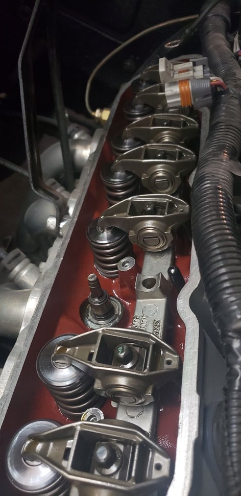

I have a lq4 motor with 243 heads and a TSP CAM with a 228/232 cam with .600 lift. Engine has less than 500 miles on it. Valves are supposedly Titanium. Started engine the other day and it ran like crap after hearing a ticking noise. Opened valve covers and found this mess. Heads were checked and springs set up by G&G machine shop in Houston. Car is now in Anchorage and l have no idea where to begin. Oil pressure was good up till failure of valve keeper/retainer failure. Wtf is going on here??

Looks a bit like not enough spring. Coil bind.

Titanium valves? Did you have lash caps?
Old Jun 27, 2020 | 12:00 PM
Darth_V8r's Avatar
Moderator
Joined: Jul 2014
Posts: 10,451
Likes: 1,873
Did you run lash caps with the titanium valves? If not, we're the tips hardened? If the answer to both questions is no, then there is the issue.

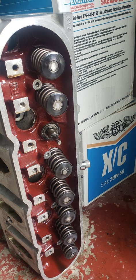

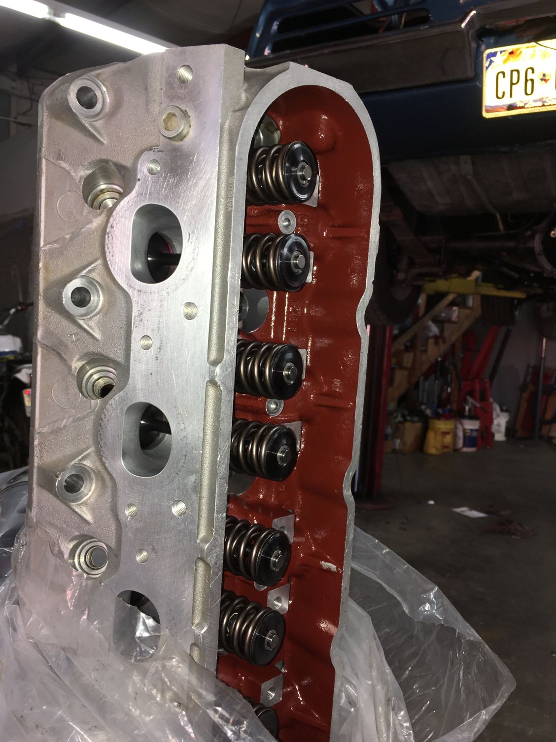

Here is a picture of the heads before install. It appears there are no caps on the tips

I just want to know why there's red paint inside the cylinder head?
l think it enhances the oil flow back to the oil pan is what l read. Bought the heads that way l did not order it done.
Lash caps are a MUST with titanium valves unless they are made with a custom hardened tip such as ferrea does. Stock ls7 heads use titanium valves with lash caps.
Rockers eat away at titanium valve tips. Rapidly. As you see.

You could probably run the springs themselves again. New retainers and locks are a must though. Valves too of course.
Looking at your pictures on my phone it's hard to tell but there might be caps there. The one of the damaged head standing on the floor there are two valves that look unaffected/ maybe have a cap?

The red paint is glyptal and its an old trick commonly seen on gen 1 stuff.

Well, after taking the heads to the machine shop l found out that the valves did not have caps inatalled on them. Going back to good old stainless as the heads are still good the shop told me.

Glyptal is a paint used on electric motors, and many other applications. If applied correctly, does not peel.

Are the valves stuck in the guides?
Glass beading a titanium valve stem will destroy a guide.
