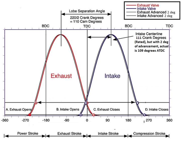

Thanks for the info. I tried the same calculator but I am too new to finding valve events to input like the abdc closing and all that so I know I made an error. I think that cam will be great too. Especially for retaining the best street manners it should haul ***. I've never had a aftermarket cammed car and always thought I wanted the chop that comes with them, but I am now reconsidering. I believe I can still get a small amount of chop from the ghost cam through tuning which may be nice, just don't care for anything extreme any more. Either way, I need to get learned up on valve events.
This chart helped me to initially understand valve events.
There is a lot of great info on this forum, lots of reading to do. Pay attention to the experts here. I'm sure you recognize who they are.
That does help to understand a little more so thanks for posting it. Yeah, I hear you, I've learned so much on here in the past couple years and have seen the posting patterns and have determined who knows their ****.
