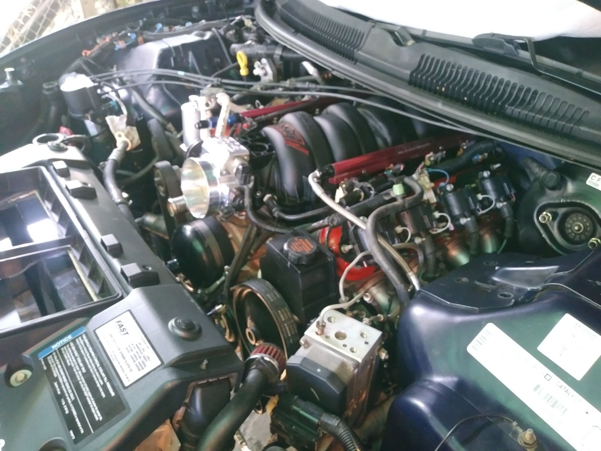

I fired up the Ws6 today and it started fine. I did the 2 cycle heat and cool then went out to like a 20 mile drive and would let it go up to 70 at one point and bring it down to 20 down shifting as I went to keep rpms healthy.
i then came back and changed the oil and I am now on the 500 mile break in stage.
I am currently going through 2 issues:
1. Car sometimes starts fine at first and others the Rpms are all over the place and I have to accelerate to keep it on. After about 20 seconds of the car being on it stays idling at 900-1000 rpm for as long as I let it. I have a feeling it might need the Tune ASAP, I’m lucky it still even turns on I’ve heard some only turn on once and never again until it’s tuned.
2. The battery gauge goes under 13 volts and at one point it died at a red light because it got to low. But lucky for me, it started right up after like 1 min of cussing lol.!I am currently running a 600 watt amp to the composition speakers and have the big three upgrade and just added the Hotwire kit to the fuel pump. I’m thinking of ordering a new High Output alternator, like a 160 amp one; would that be safe? Has any one had this issue after Hotwire install?
and definitely regretting the 6 pluck clutch right now, maybe after the tune it will get better.
A simple thing you can do to help it out until you get it to a tuner -- unplug the TPS. Adjust the screw one full turn to crack the blade open a bit more. Key one for sixty seconds, but don't start the car. Key off, plug in TPS. That should rezero your throttle position a bit more open to help it hold idle. If it won't settle down, then close the blade a quarter turn at a time, resetting the TPS each time, until you find the right blend of enough start up air and not too much for warm idle.
I run a powermaster XPS 160 amp. Perfectly safe. The battery only drains what it needs. In other words, the alternator doesn't force 160 amps down the car's throat. I also run a hotwire kit.
6-puck clutches don't generally like to be slipped. The more you beat the **** out of it the better it drives. Try to be all smooth about it, and it'll start to chatter. Tune won't help it. But sometimes, about 500 miles and some heat cycling will help it smooth out. That's been my experience. I learned a while back I'd much rather have a twin disc than a really strong grip strength single disc.
Thank you for your response, VERY HELPFUL.
I did the TPS reset and idle is super better.
I also double checked the battery and one of the post was loose. I guess with the vibrations.
Now the issue is piston 3 spark plug wire keeps hitting on the header, I ripped right threw the protector and messing up the wire. I’m on my third wire. Thinking of cutting it to avoid contact.
As for the clutch I’m getting the hang of it.
I really appreciate it.
