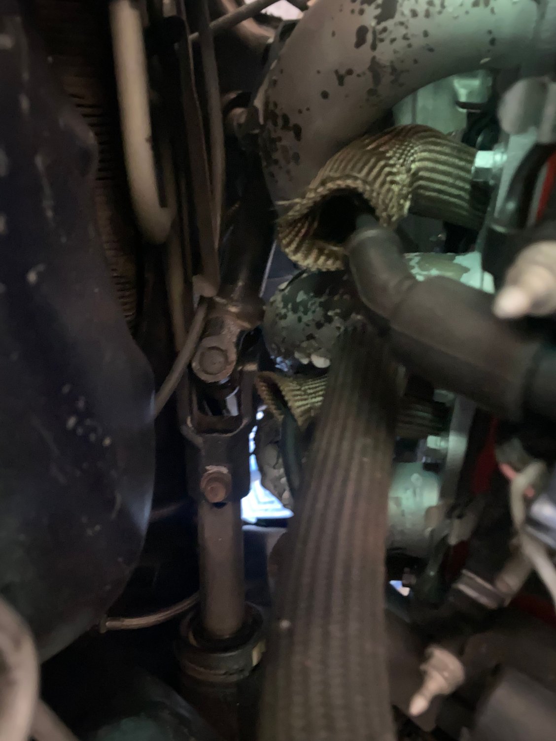

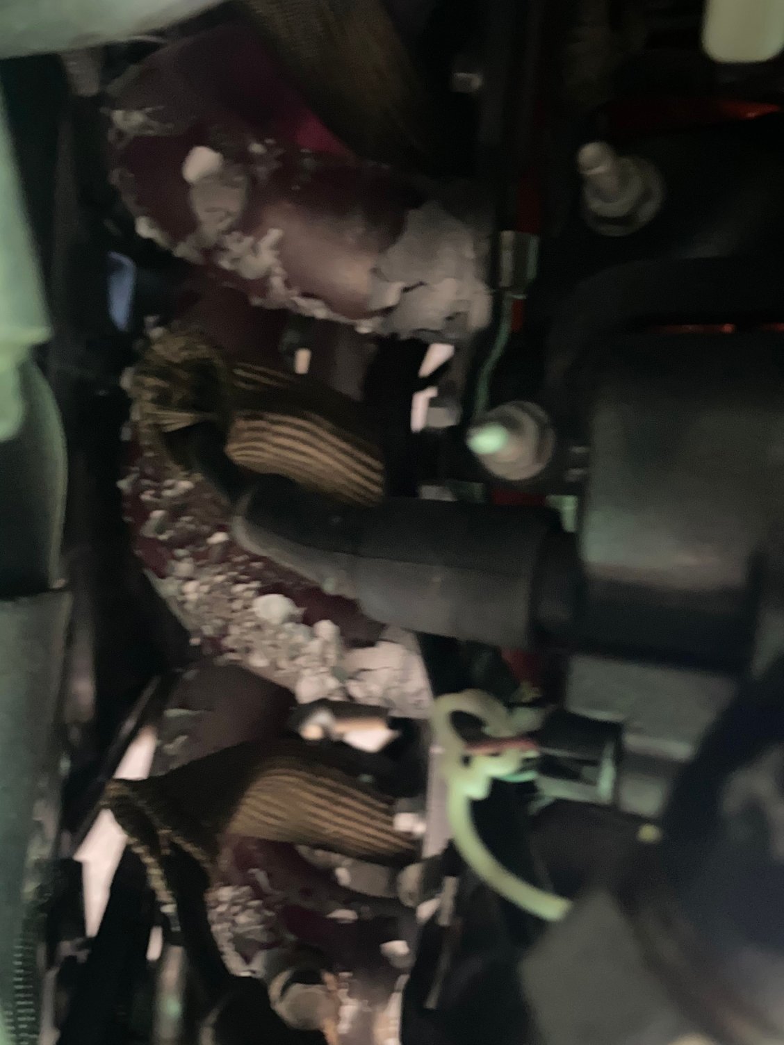

Oh ok I see, they got really red at one point as you can see with the picture above; so I wouldn’t doubt that they are, should have gone with long tubes. Will make the change once I sort this out.
When I took off the cats I could see really blue flames come out the header. I did the Open ram air and Ssra upgrade after the tune, so it’s definitely sucking in more air than when I got it tuned the first time.
