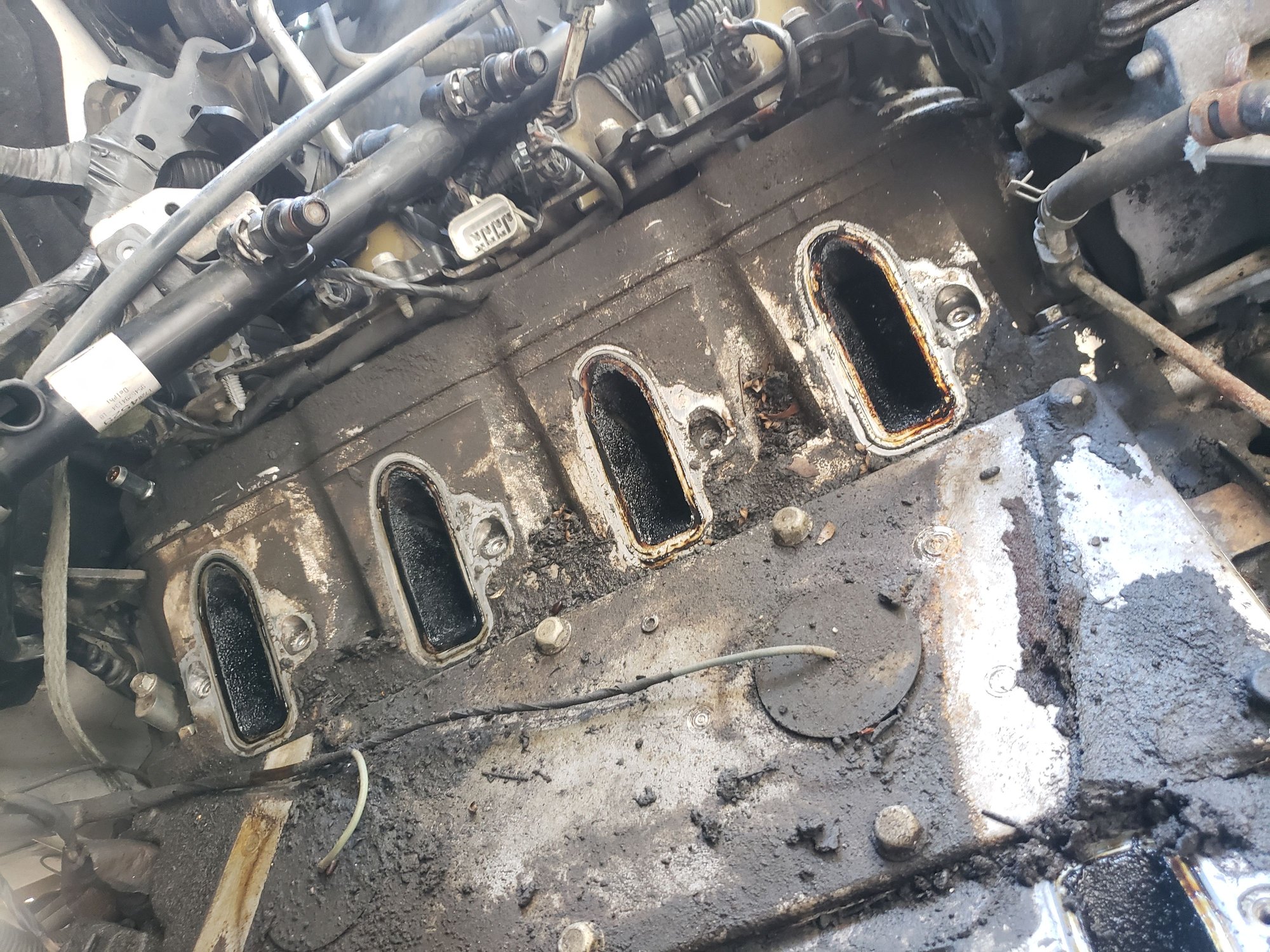

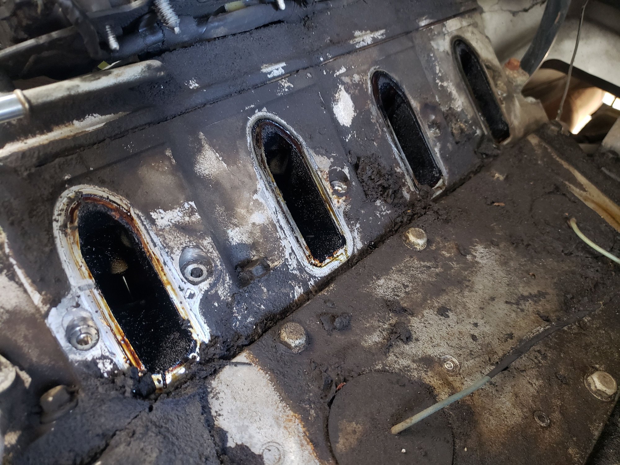

Yep that was me. After that I re did the comp test and it came out about the same. I pulled the intake and the heads look dirty AF. Here's a pic. Also one of the injector grommets was underneath the intake.

EEEEEEeeeeeeeeeeewwwwwwwwwwwwww...
A serious case of long-term neglect.
Good news is, your valley cover bolts look to be the 13mm head. Which most likely means, not for certain but most likely, that your motor has the later-model floating-pin rods.

When I tore down my 74 camaro after it had been sitting in a field for 2 years, it wasnt even close to this bad. They are 317 heads, though too. I feel like I should pull the heads too and just take them in for a complete overhaul.

Not a bad idea; or trade em in at Texas Speed or some such for a pair that are potentially a bit less ... experienced.

Yes do all new pcv lines and hardware. Bypassing a lot of oil it looks like to me. Possible vacuum leaks due to oil soaked and rotted lines.
