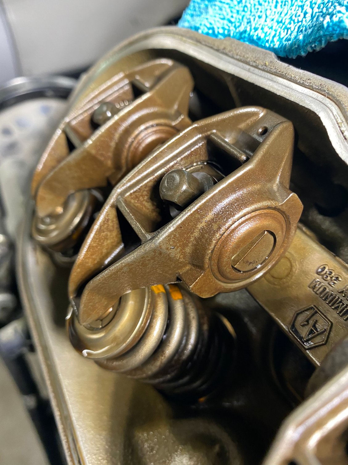

Hey guys, My motor apparently had a cam and springs, however the springs have these yellow marks on them which I assume are factory marks? Motor is an LS1 from a Holden. Any gurus able to confirm?

I would be more worried about what looks like rust on the springs. That is a failure waiting to happen any moment.

Yeah those springs look kinda factory to me... when in doubt, REPLACE.
What are you REALLY asking? WHY are you asking that? What cam is in it? That would help us guide you in the correct path, better than "what springs are these" will.

Yellow stripes early LS6 springs ,they have not made those for a long time.

If memory serves, the Hot Cam kit from GM came with LS6 springs...

somehow i thought these were blue (ls6).

They changed the LS6 spring color at some point from yellow to blue.
