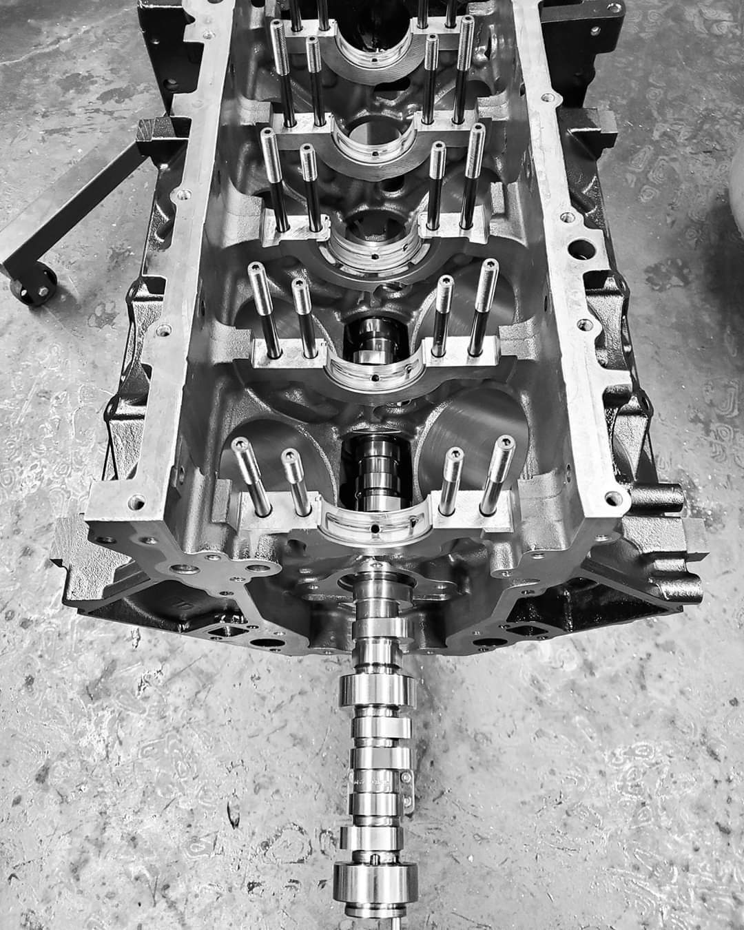

Hows it going guys, wanted to start a thread on my build its almost done, let me know what you guys think.

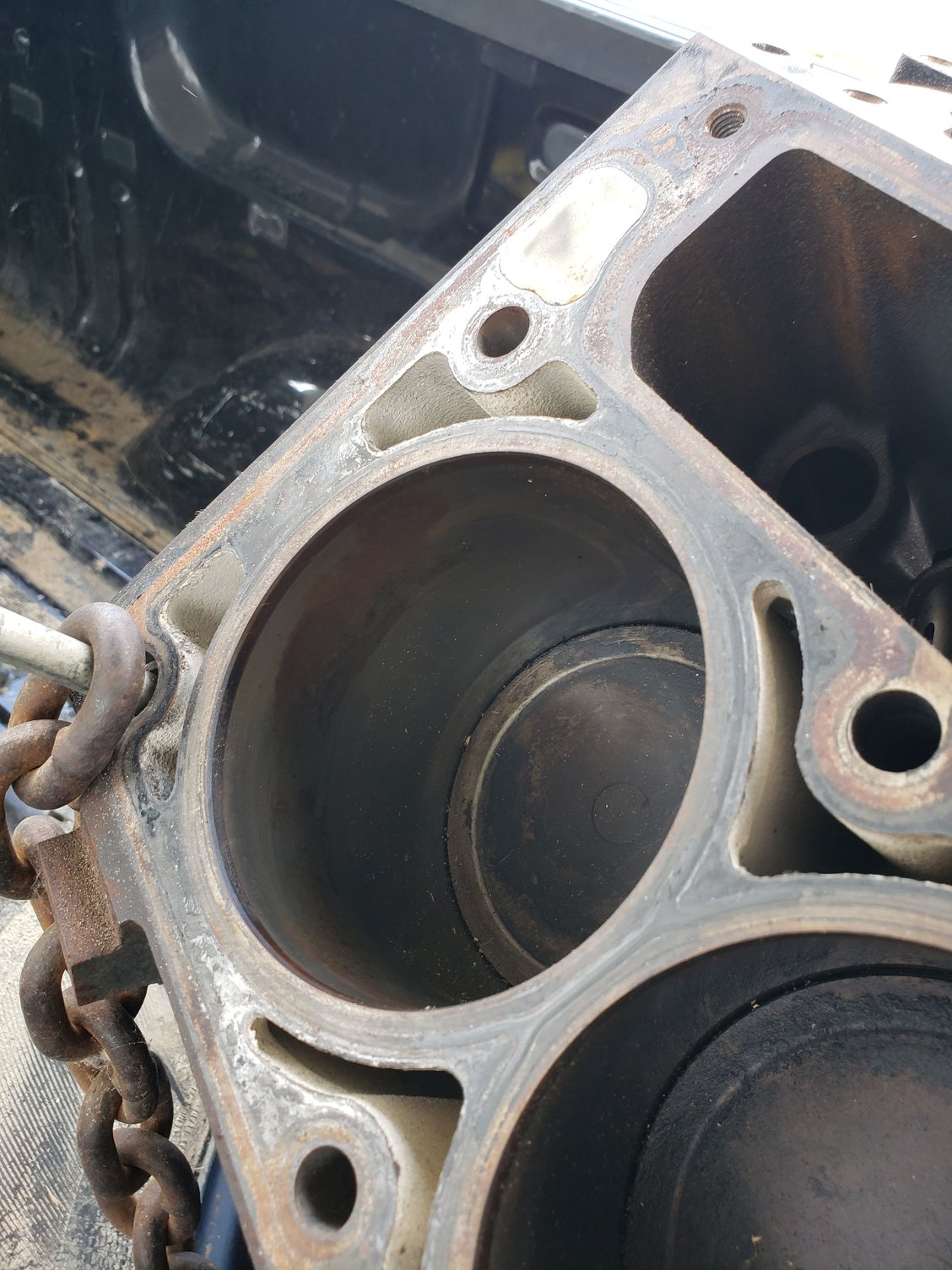

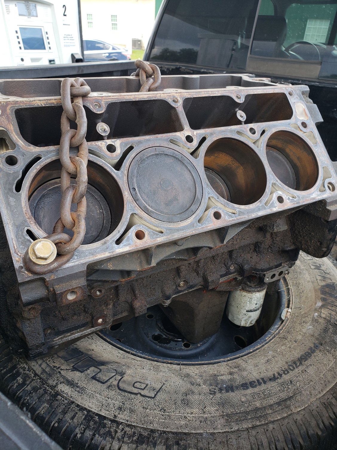

Day i picked it up.

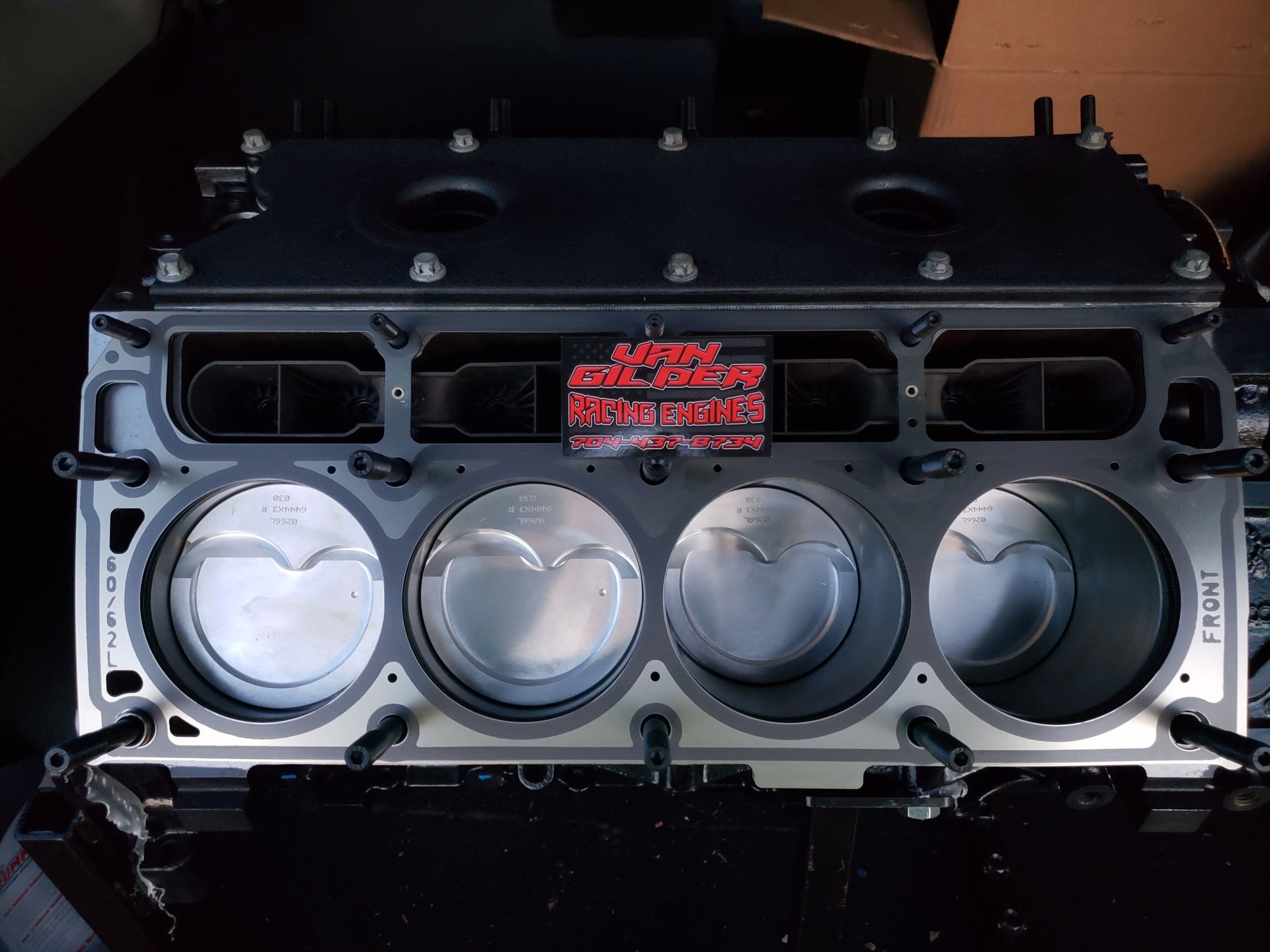

One of the best cylinders.

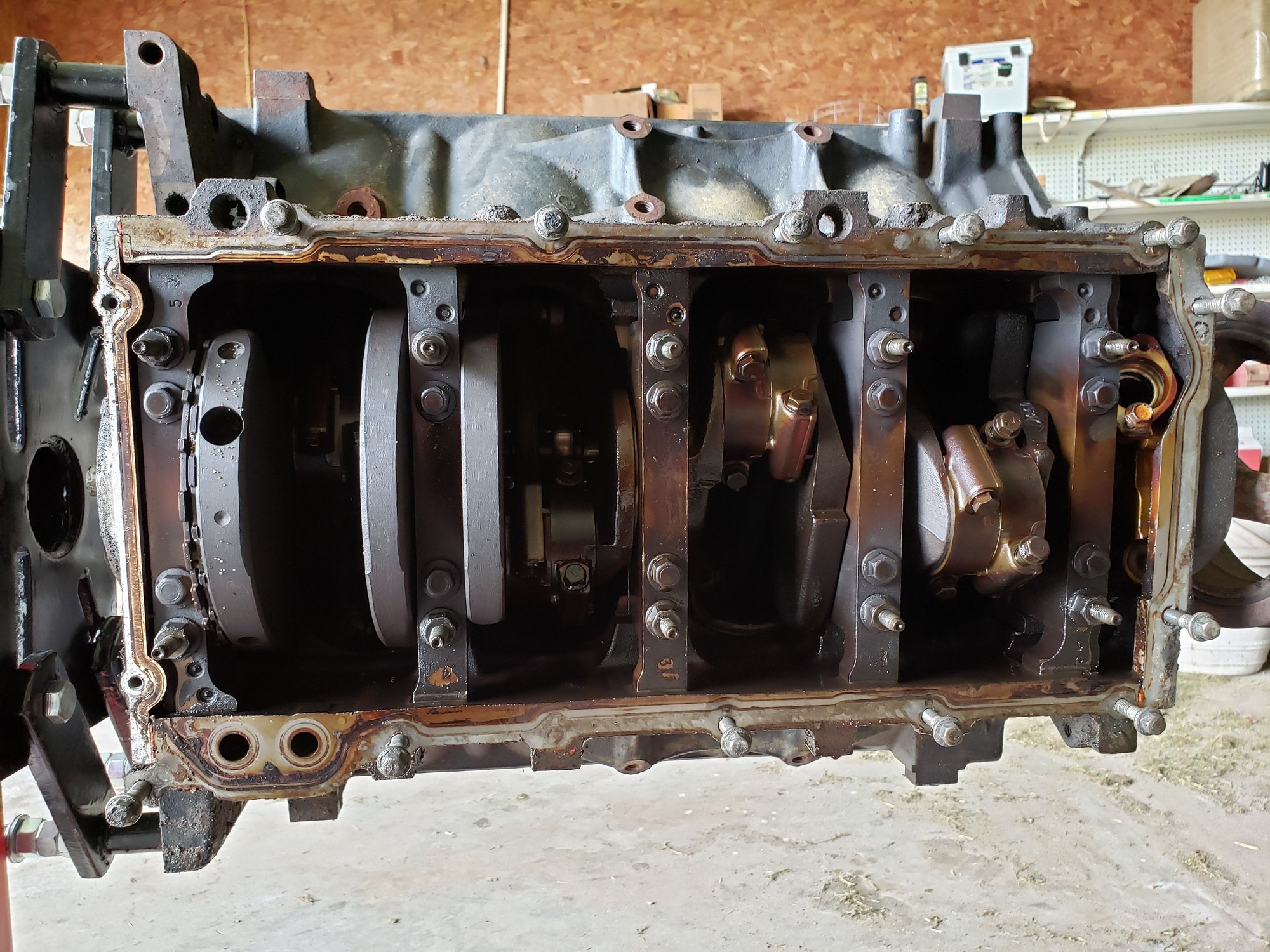

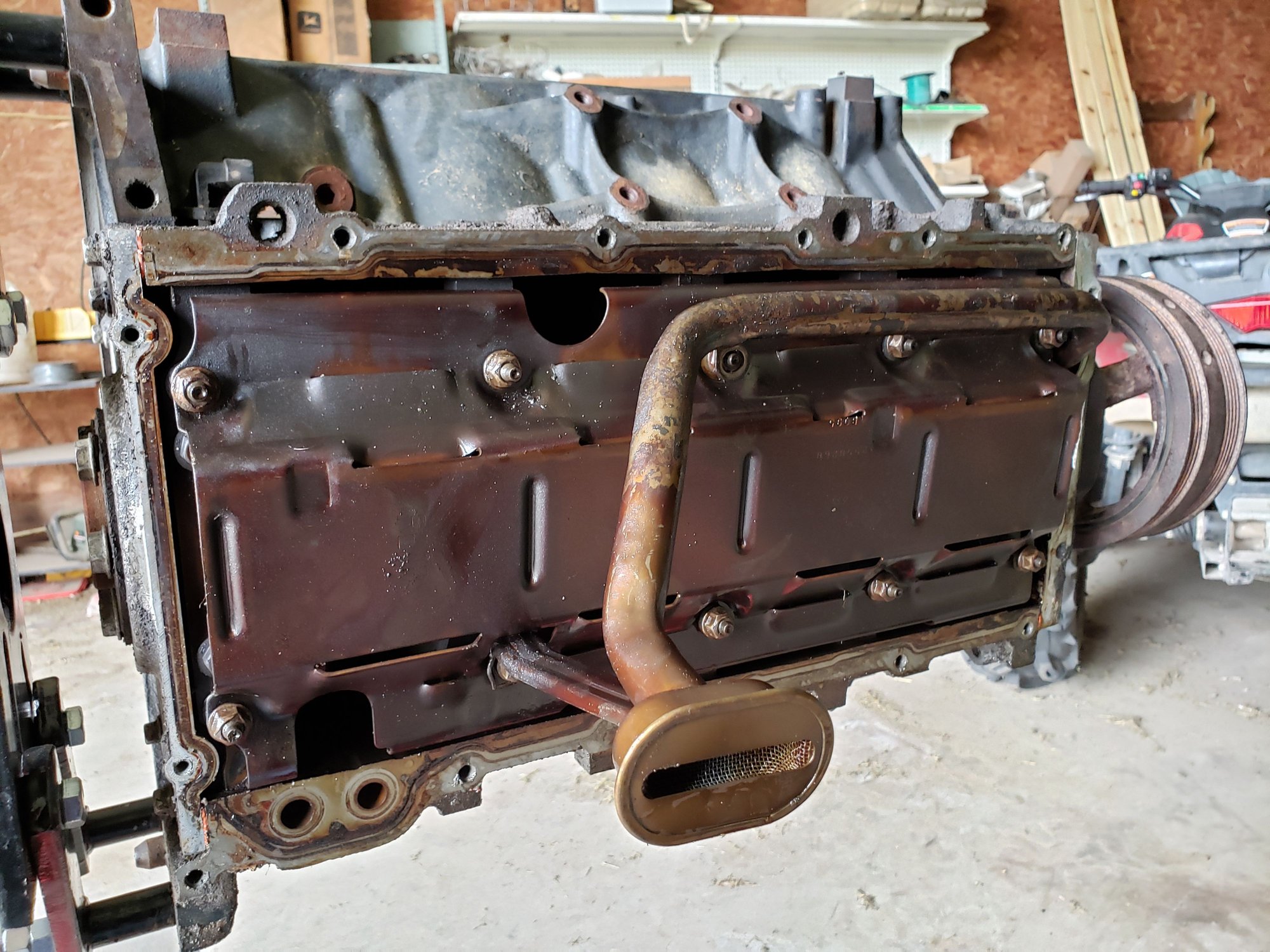

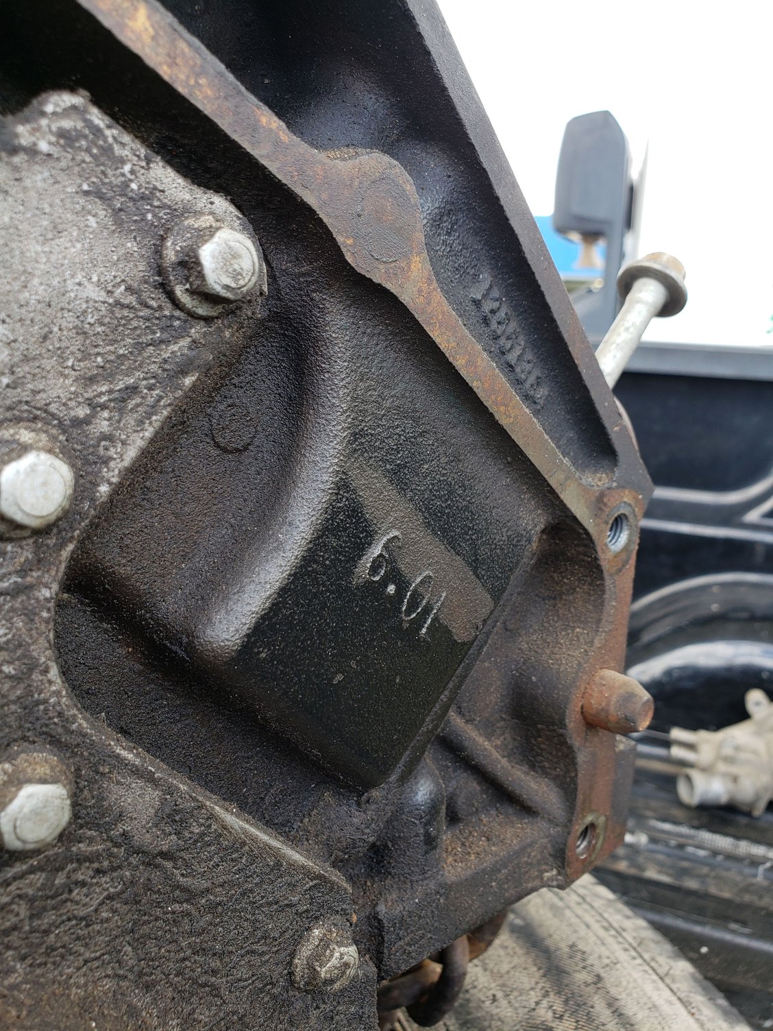

6.0 lq4

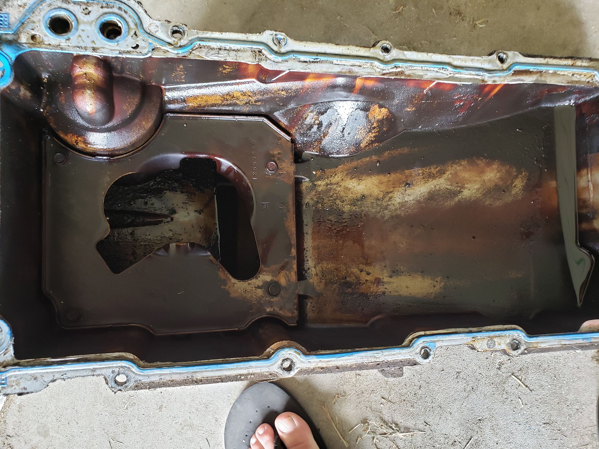

It had some miles on it.

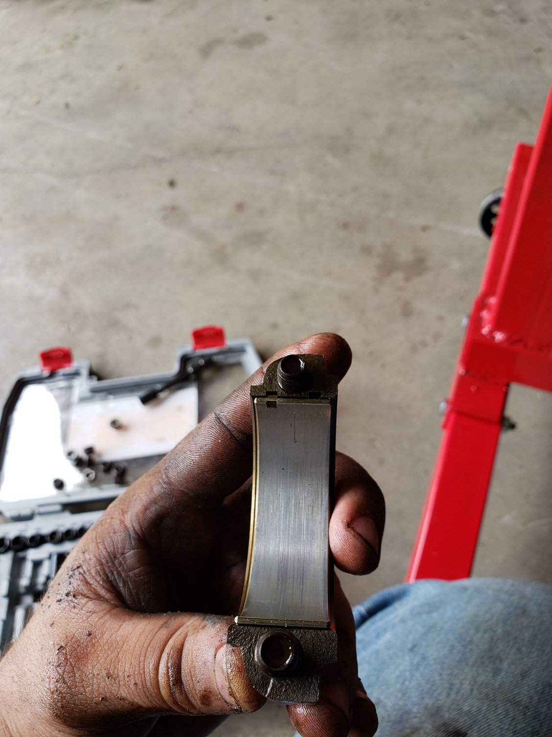

Bearings looked good, i untill cylinder 3 and then the rest was junk, glad i decided to peak.

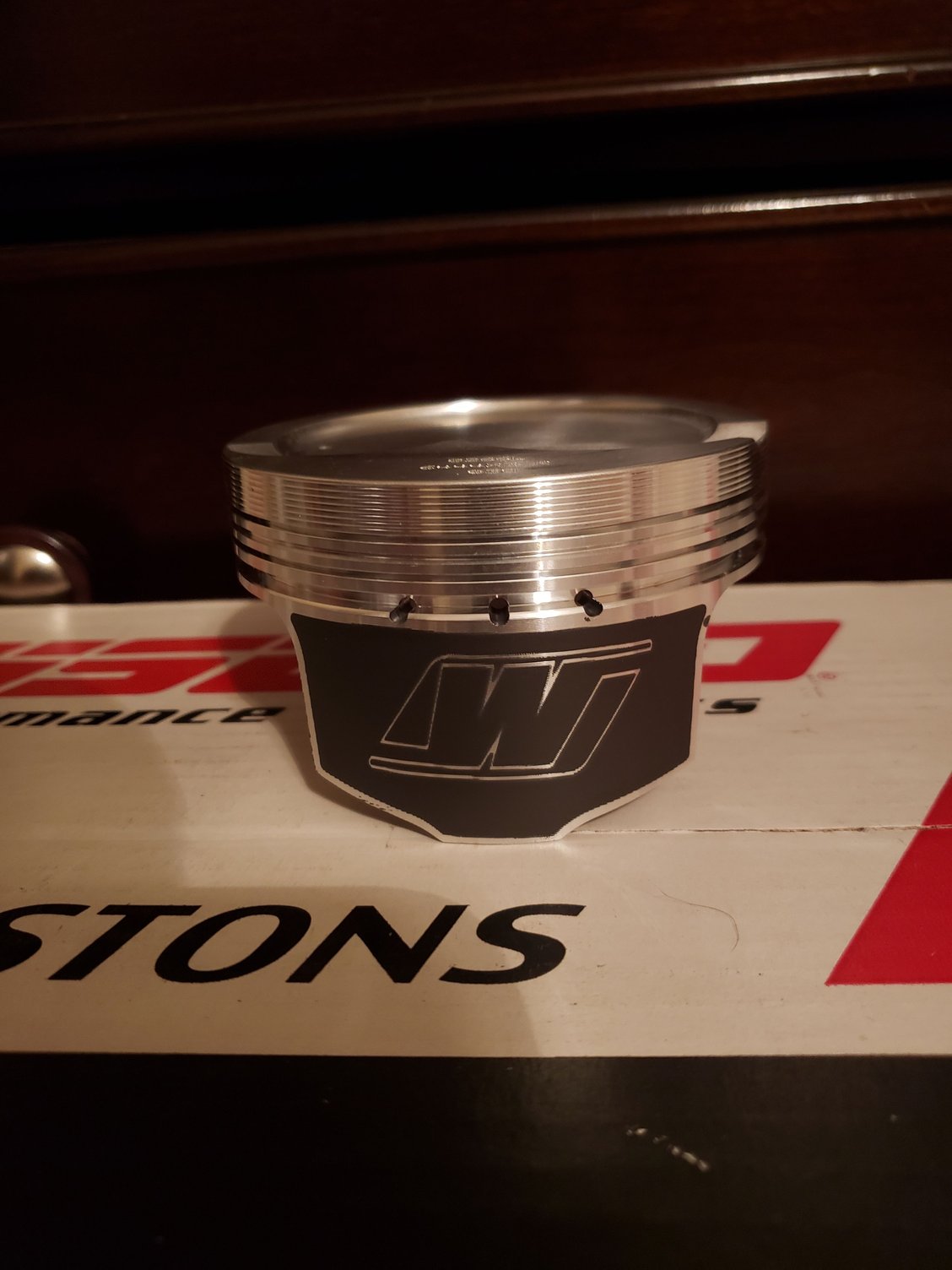

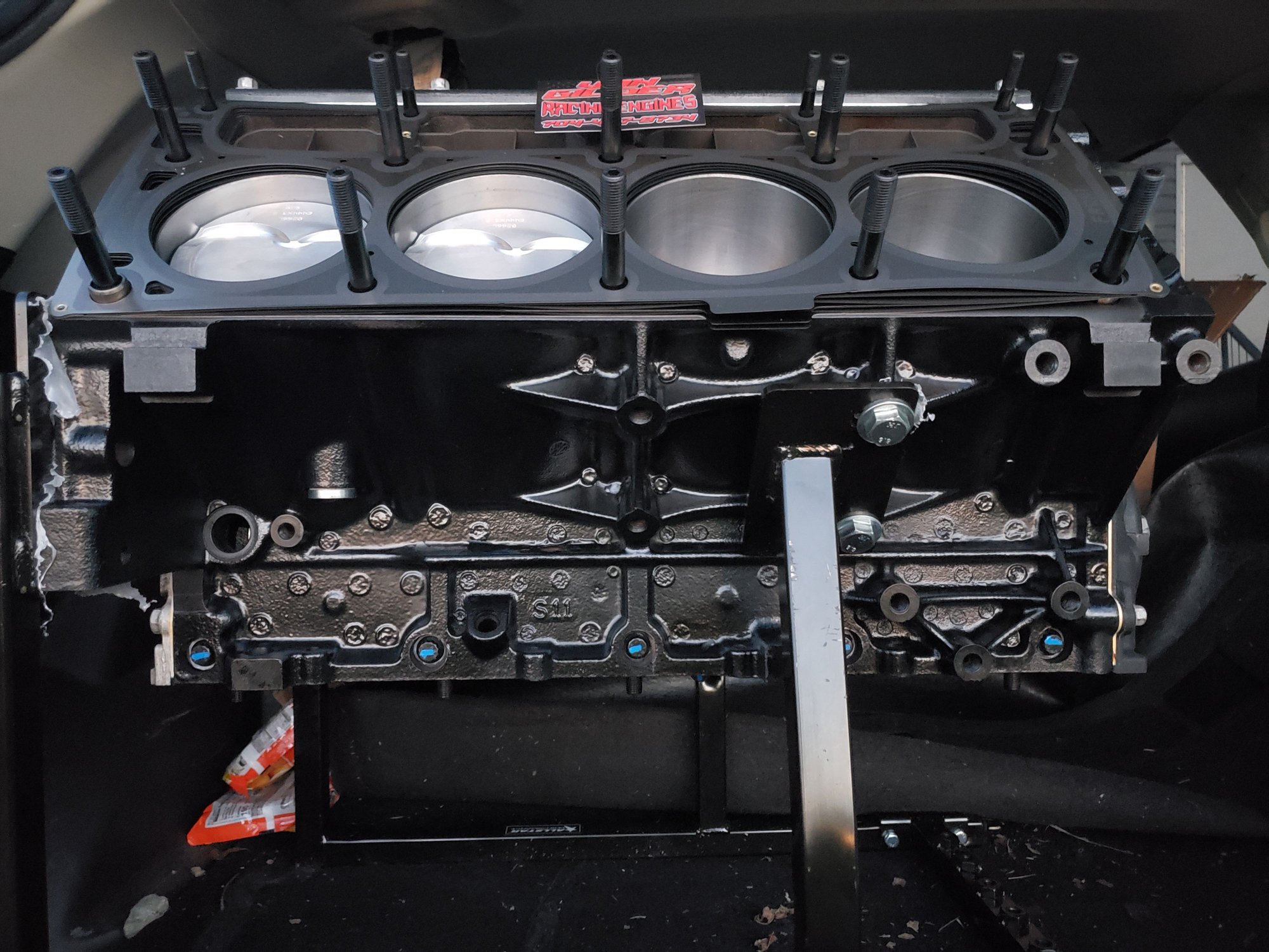

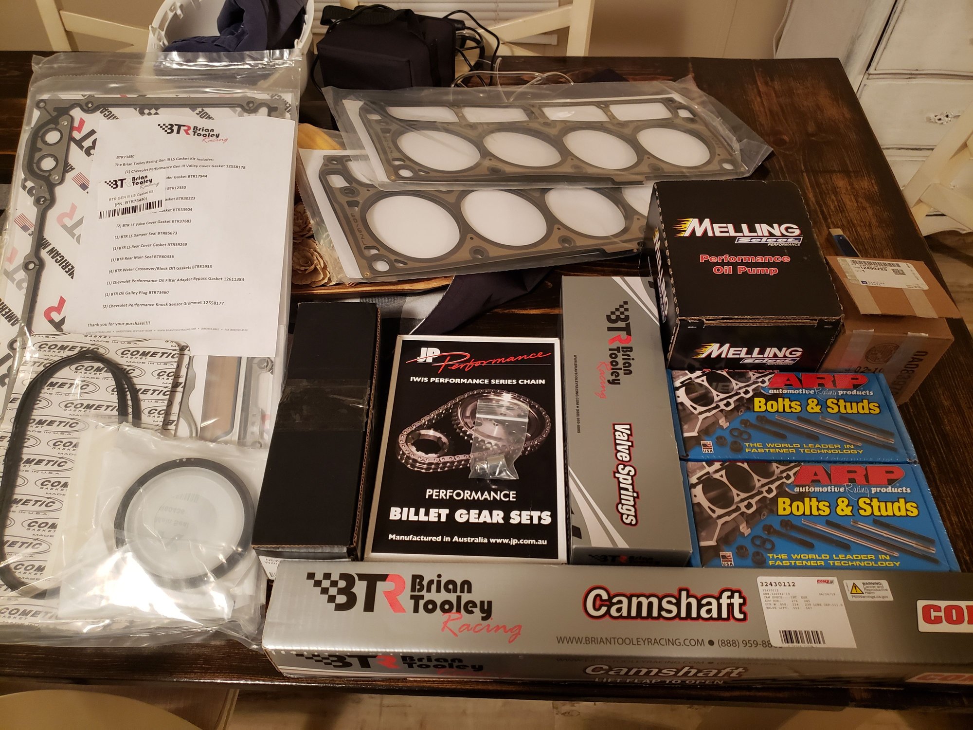

Default K1, wiseco, Btr

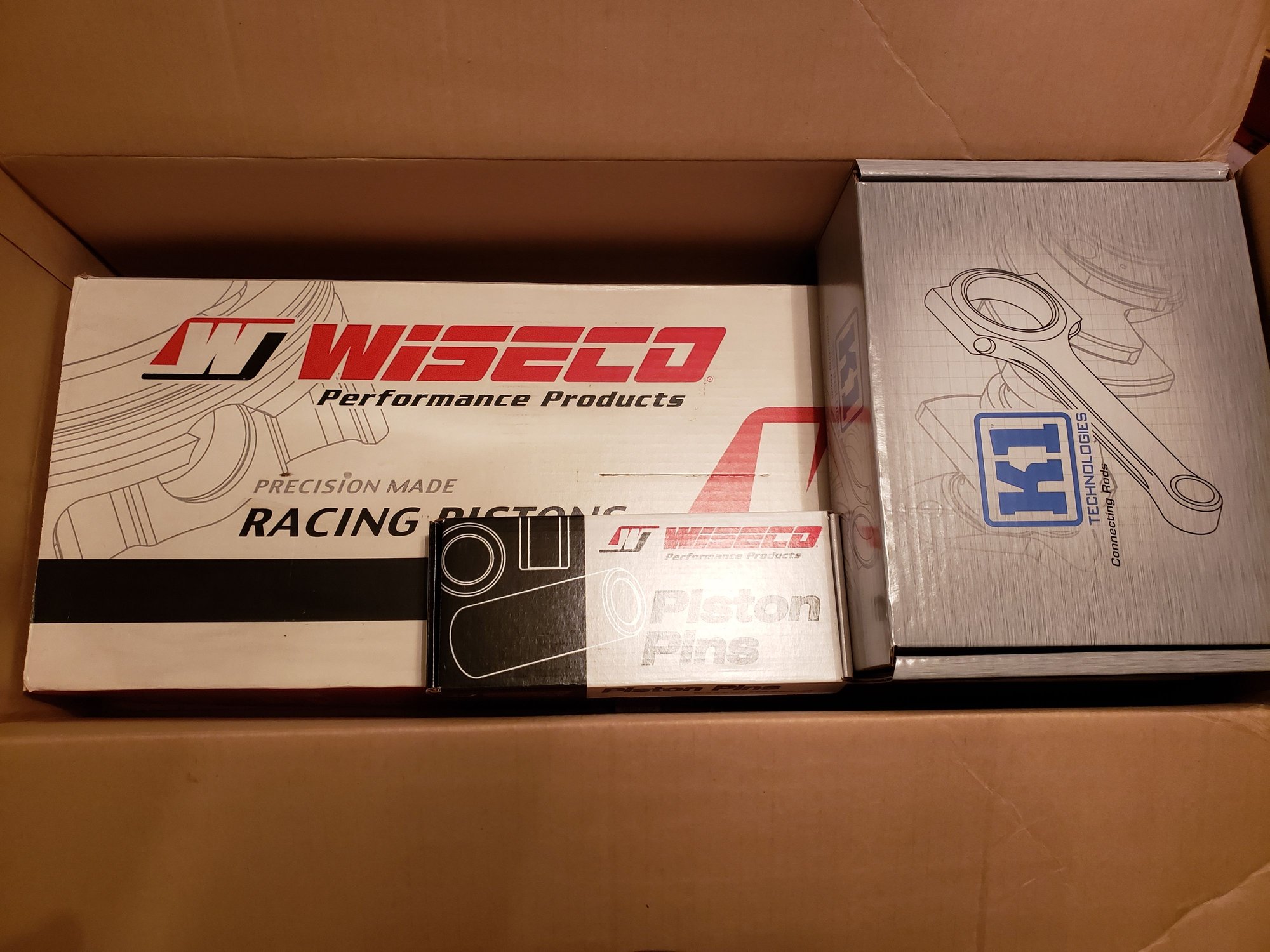

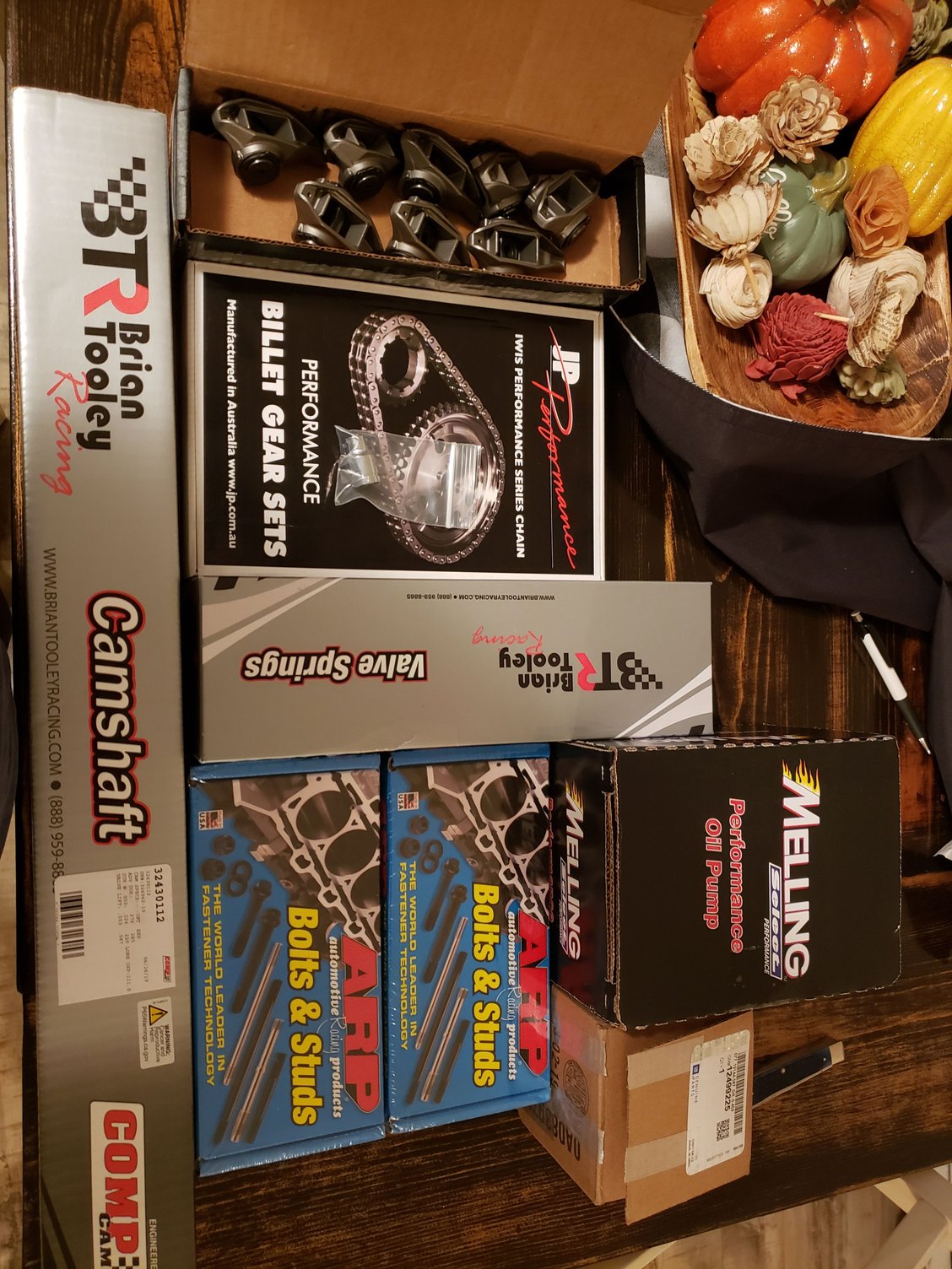

Btr stage 4 truck cam, which i swapped for a stage 2 turbo cam, ARP headstuds and main studs, melling hpop, dual .660 springs, ls7 lifters, BTR oem rockers with BTR trunion upgrade.
Btr gen 3 gasket set, ls9 head gaskets, jp performance billet gear set.

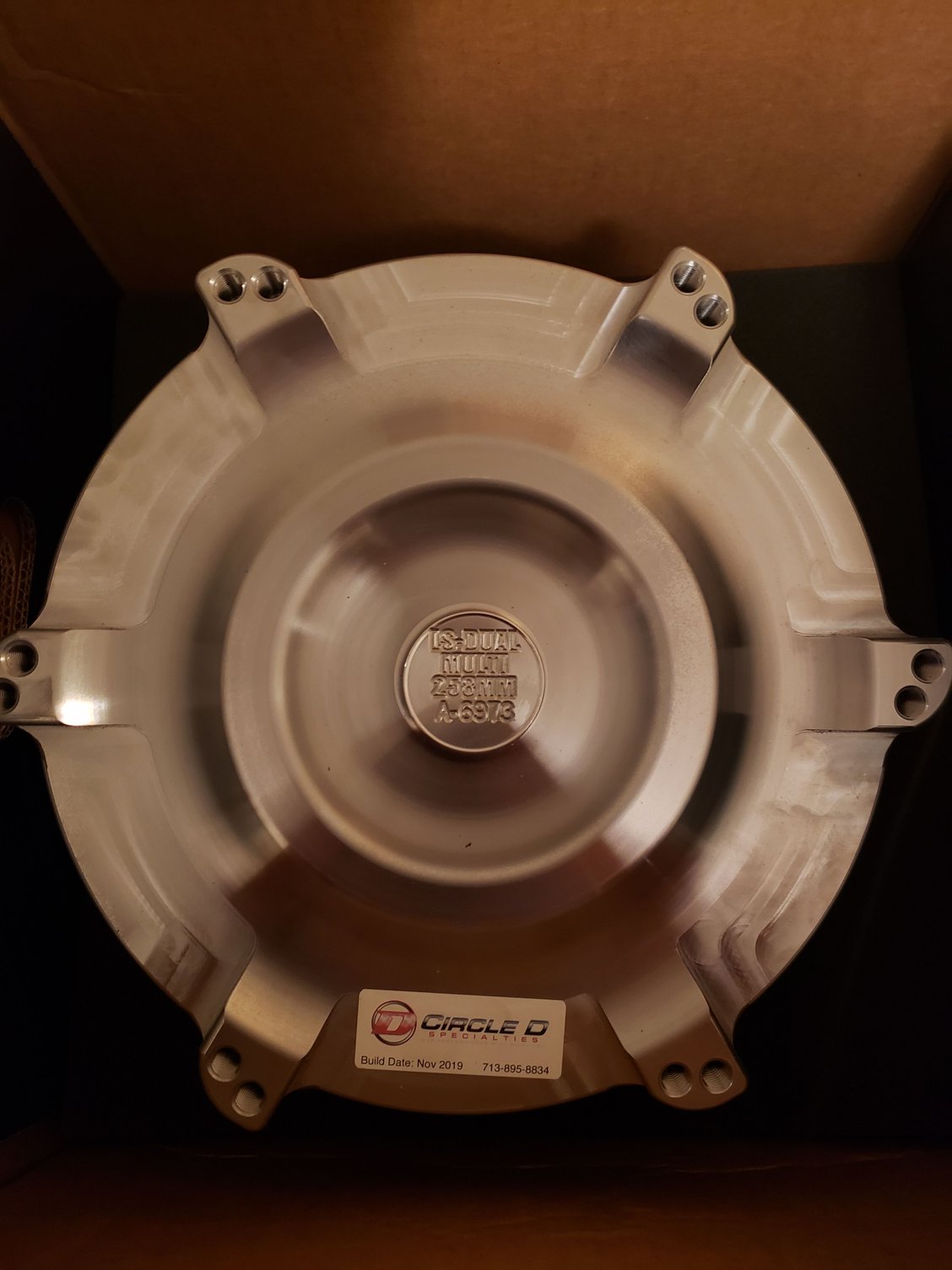

Circle D 3700 Billet stall for the upcoming 80e

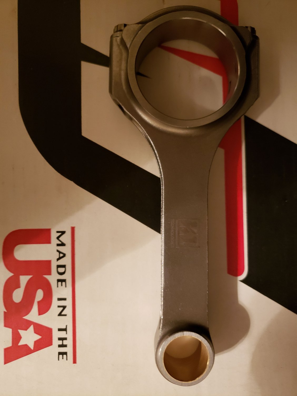

K1 forged rods. Wiseco dish pistons, Wiseco upgraded tool steel wrist pins.
Forged crank!

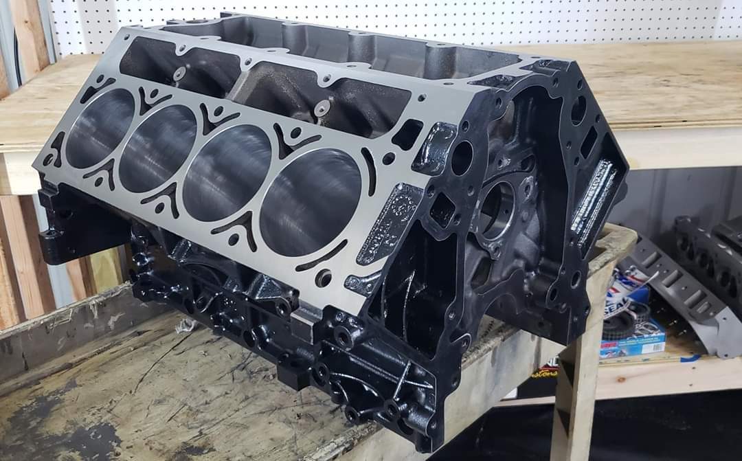

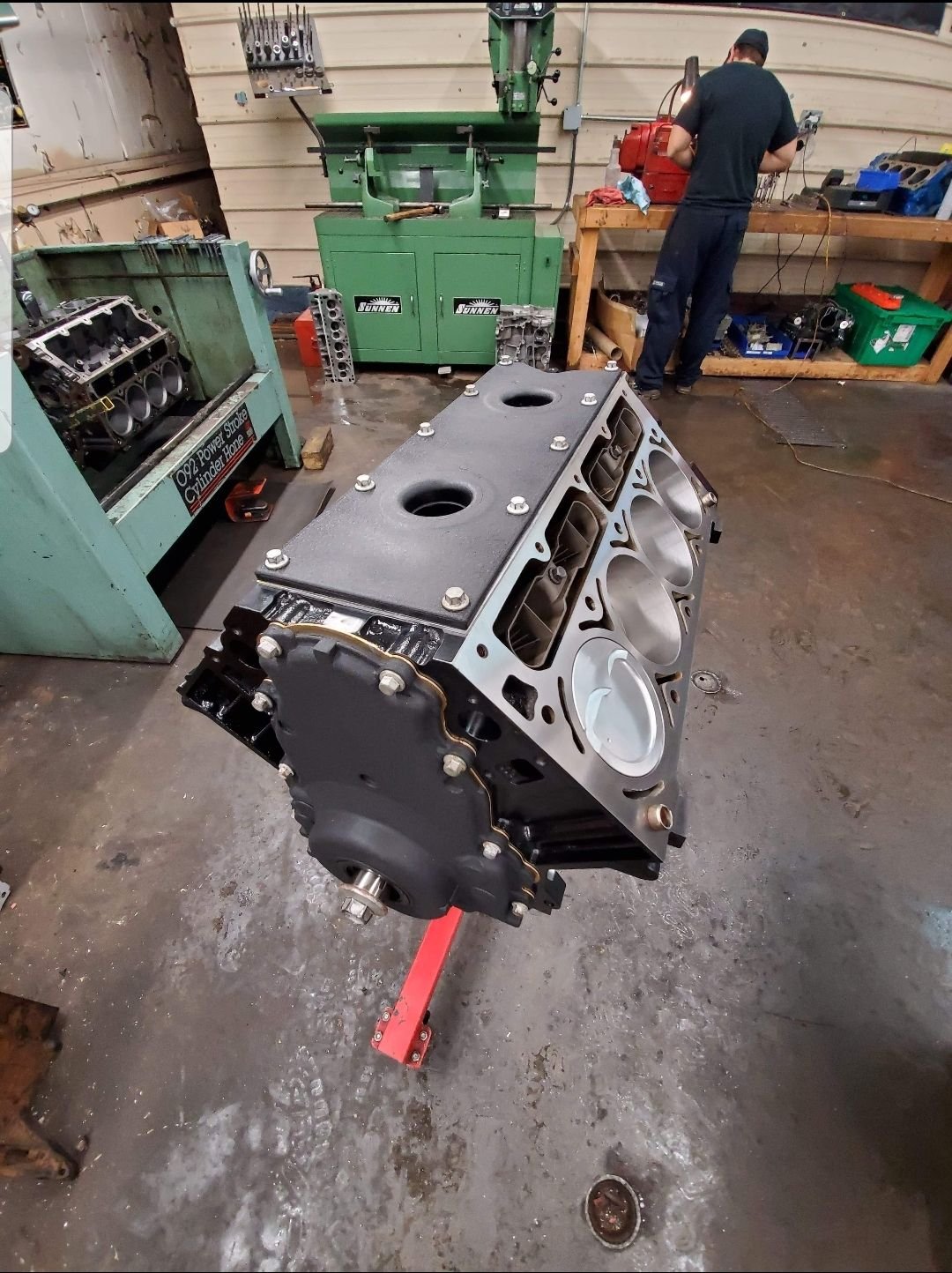

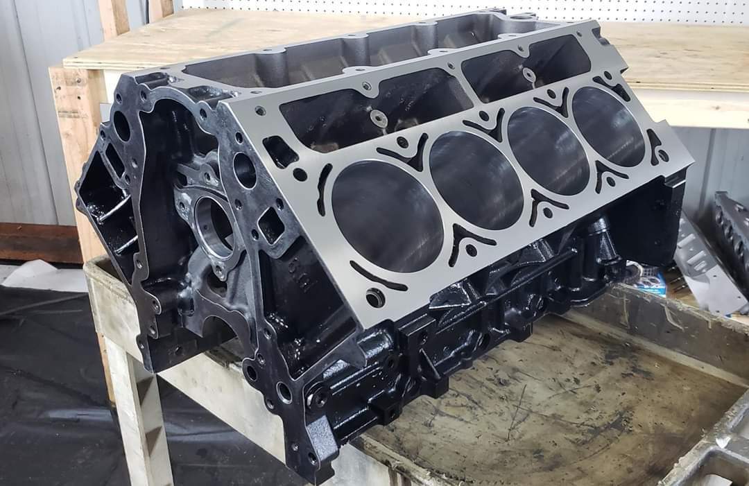

Default Machine shop

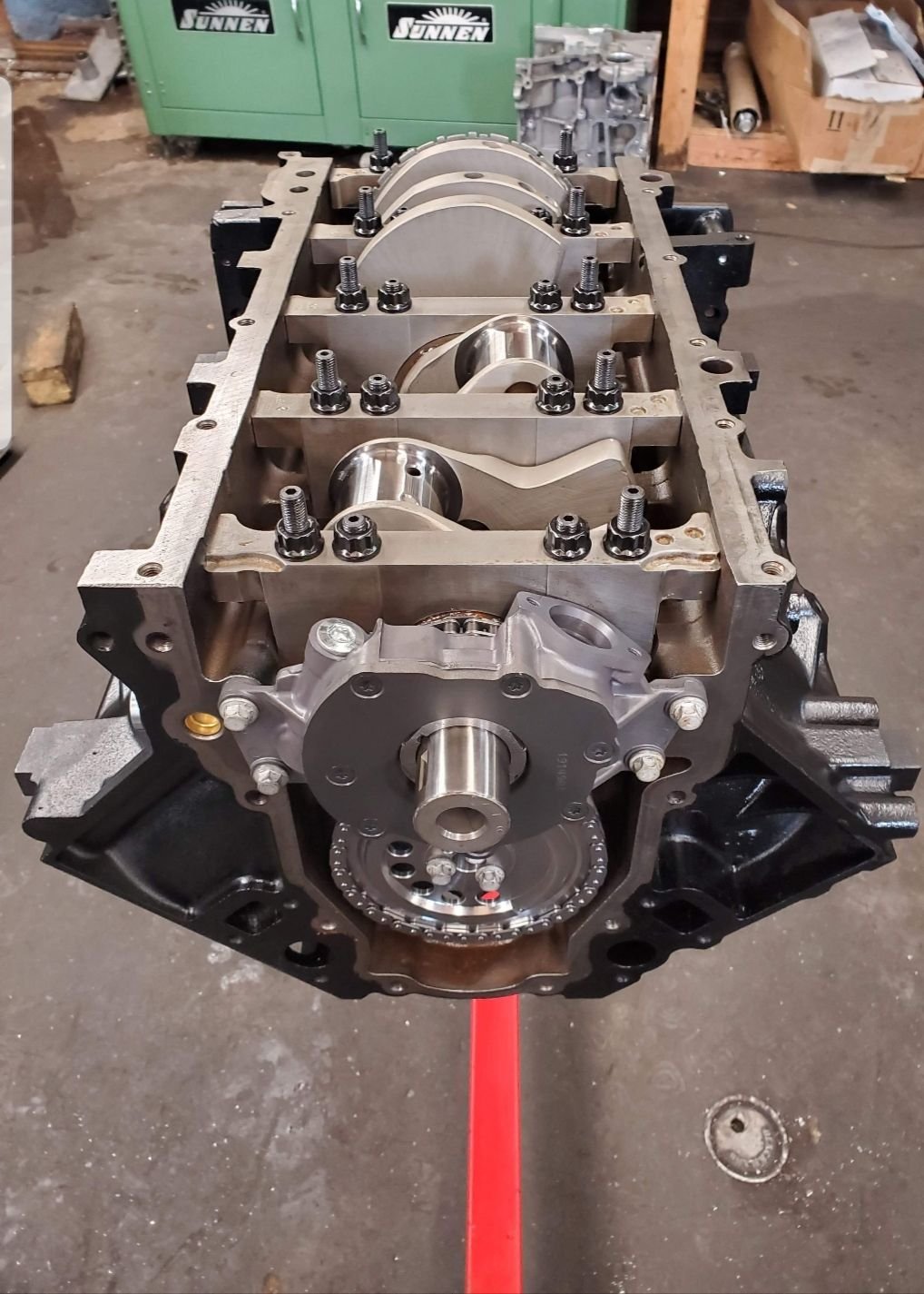

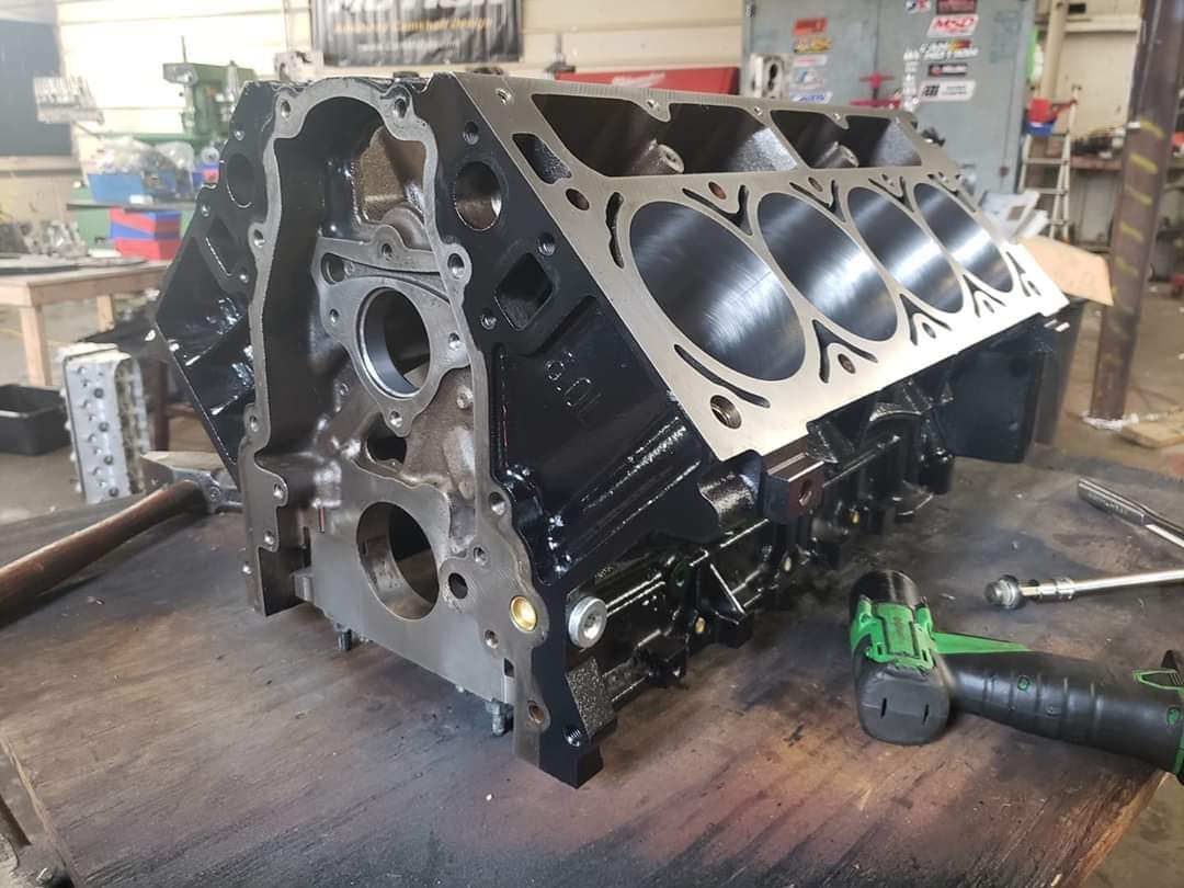

After machine work, 4.030
Classic black

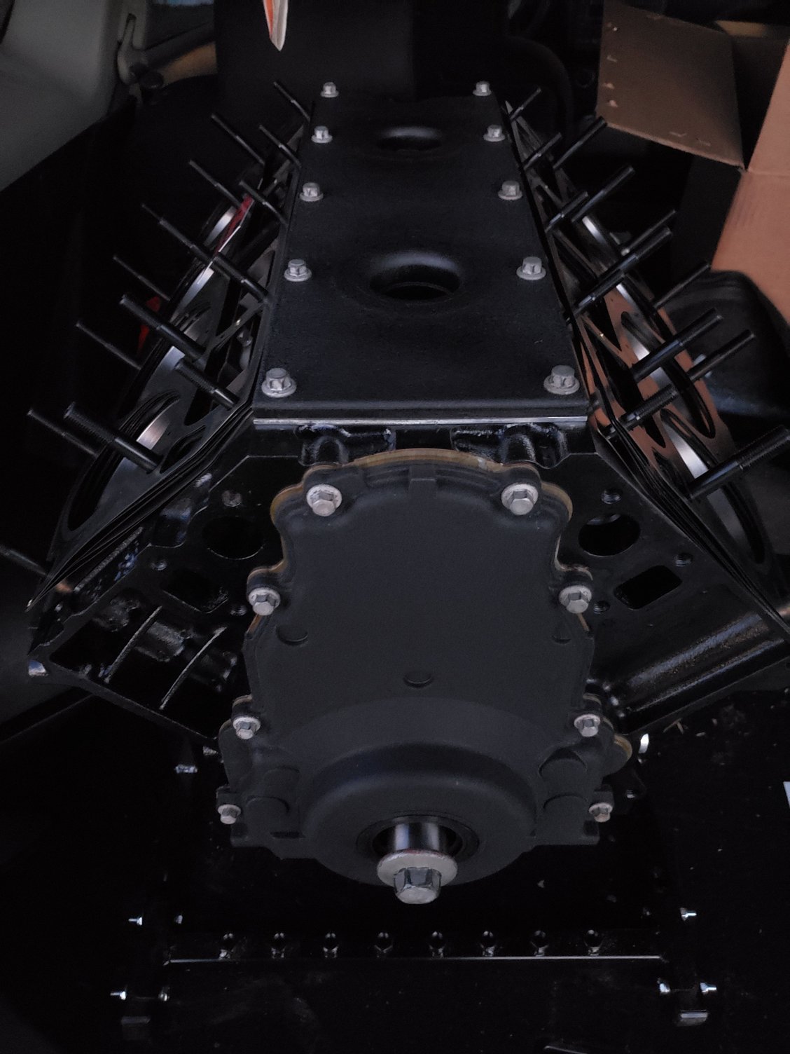

Throwing the turbo cam in and main studs

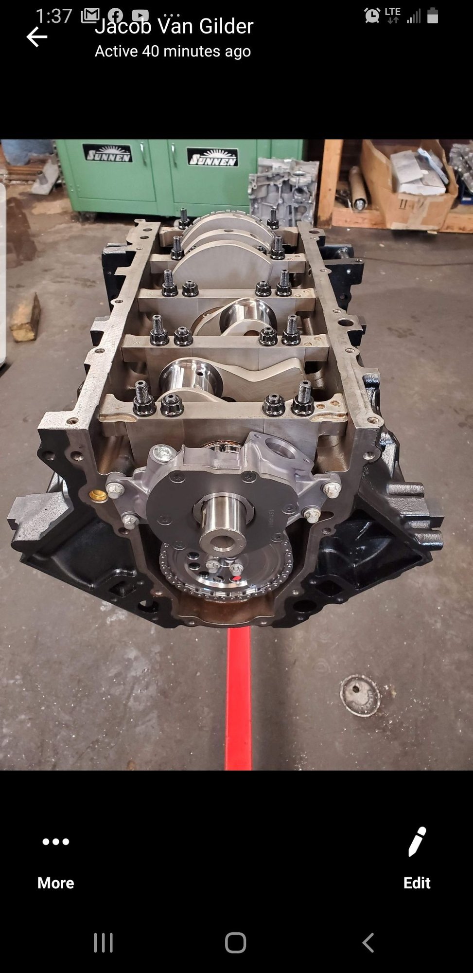

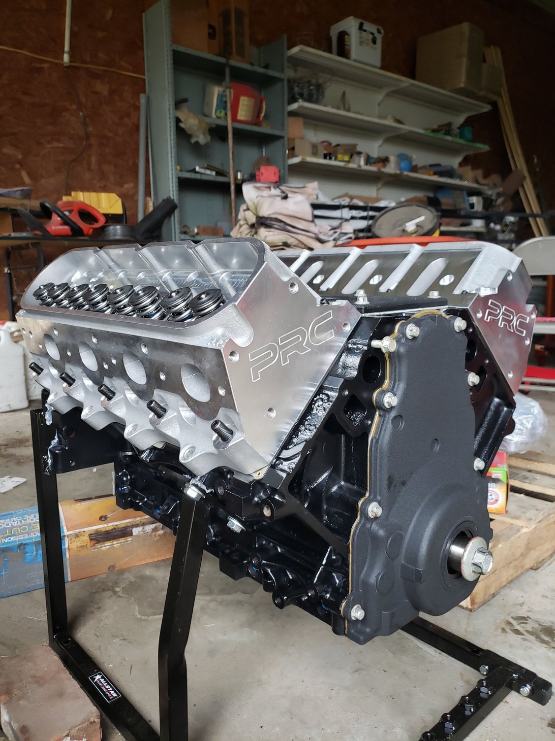

Default Finished up long block
short block was finished and ready to go got the prc heads in as well.

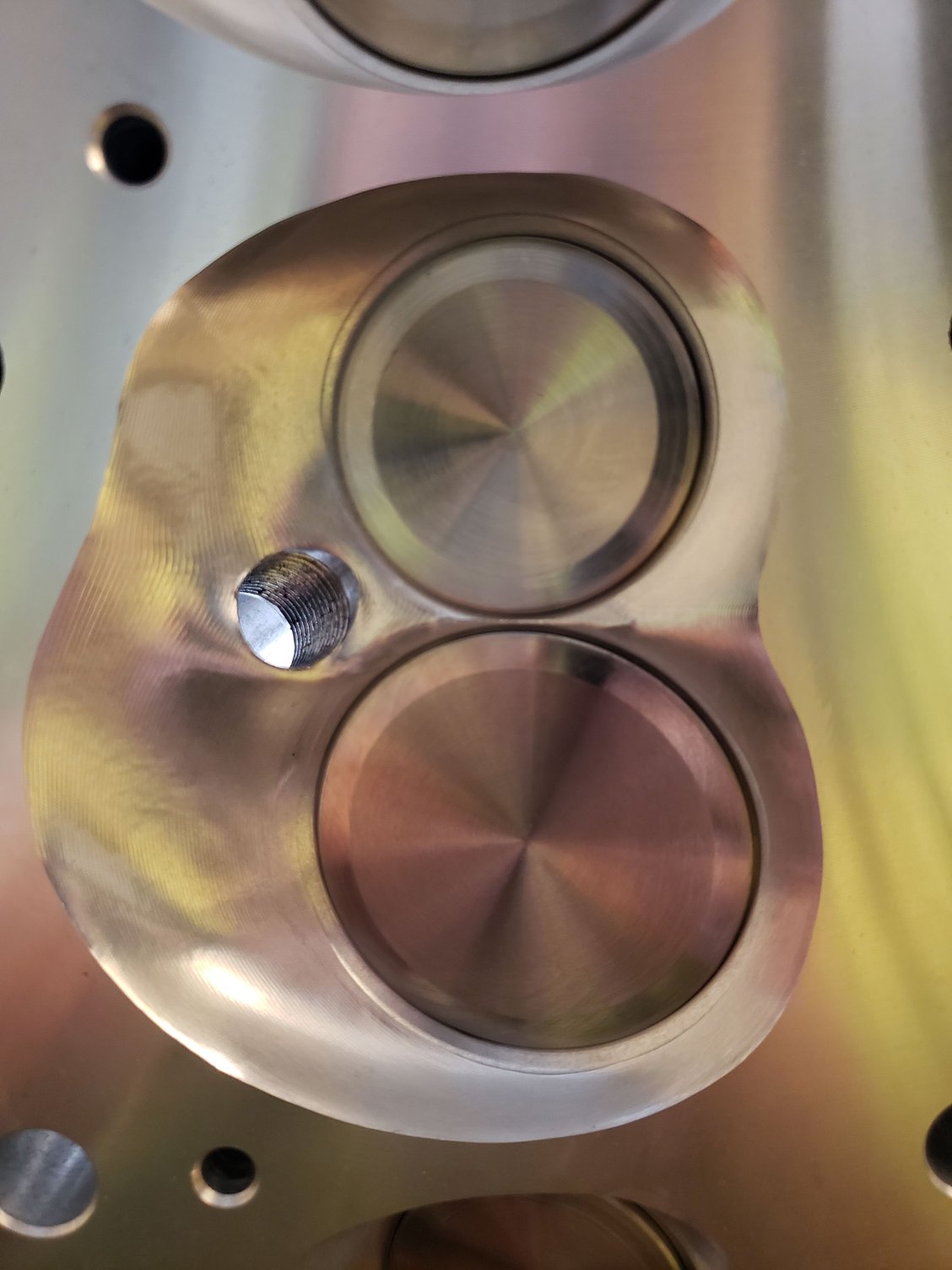

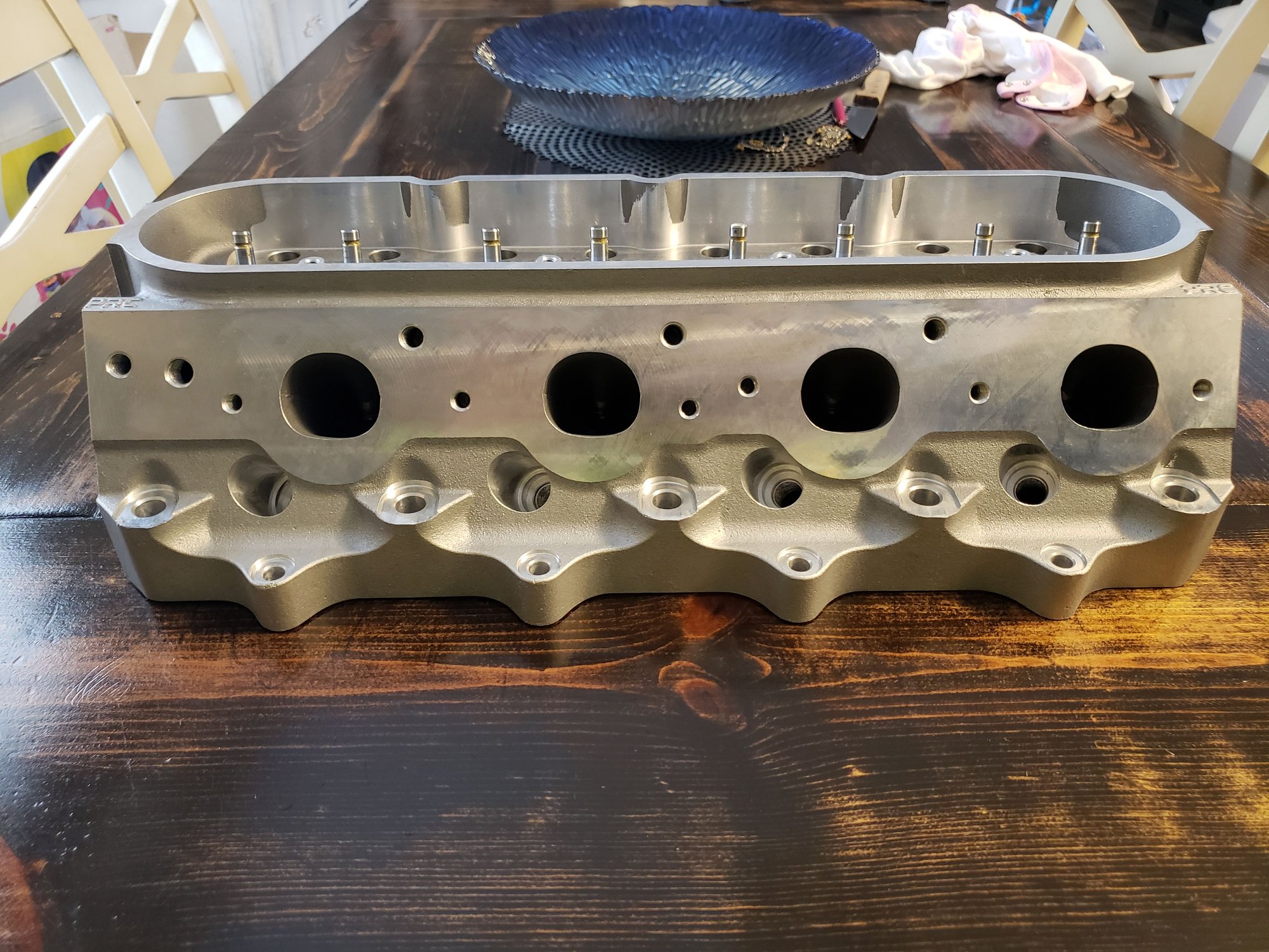

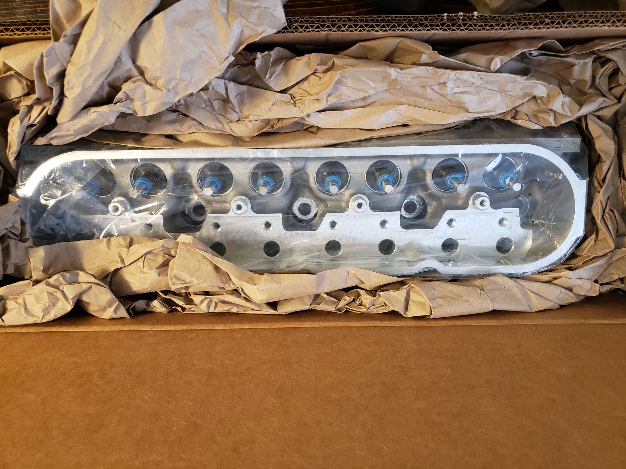

Default Heads and long block

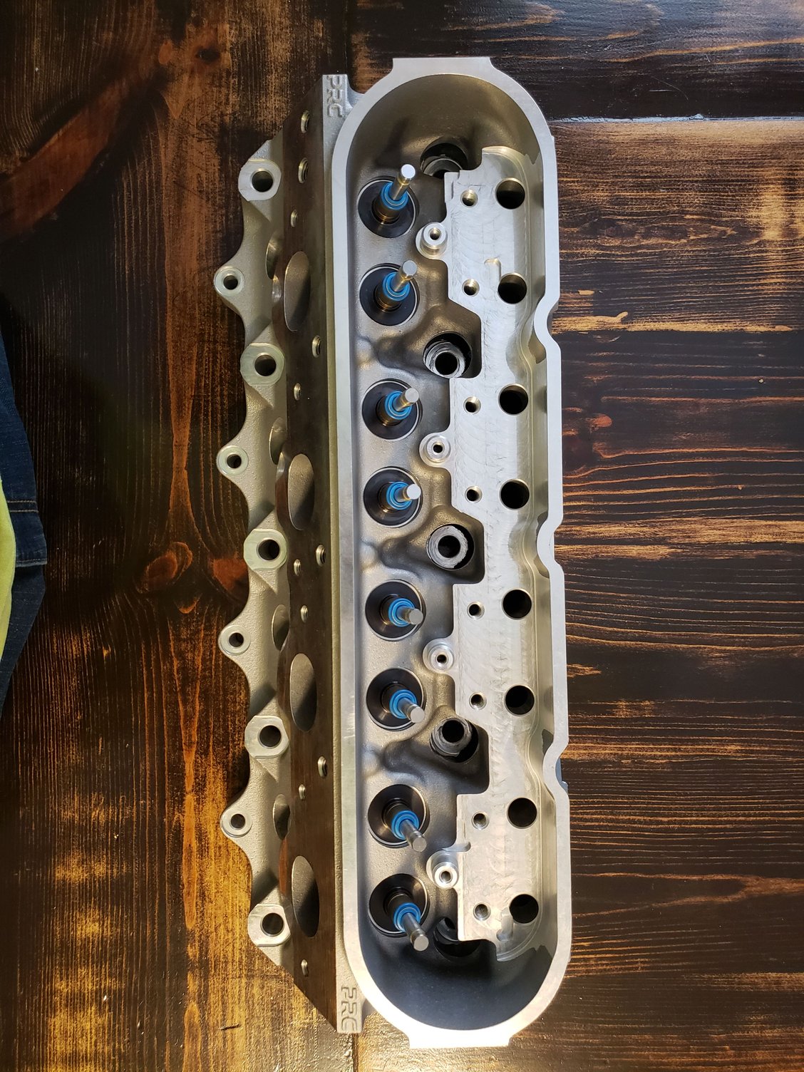

Prc as cast 225cc 68cc combustion chambers.
Texas speed.
Look at that deck!

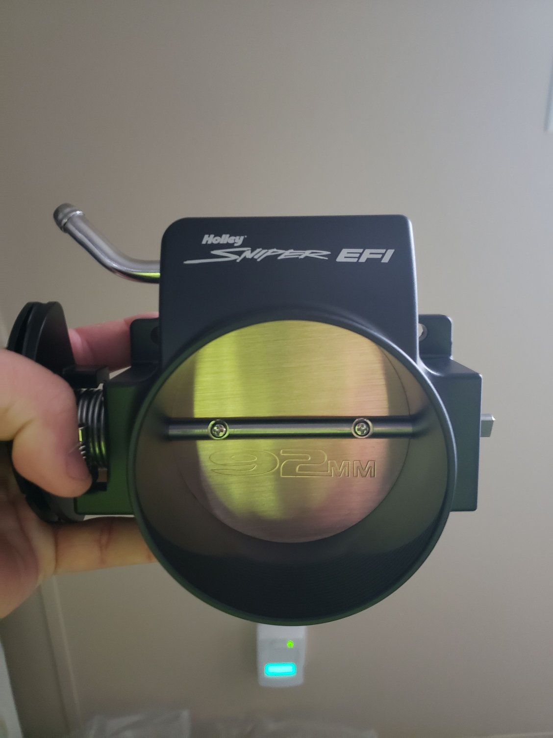

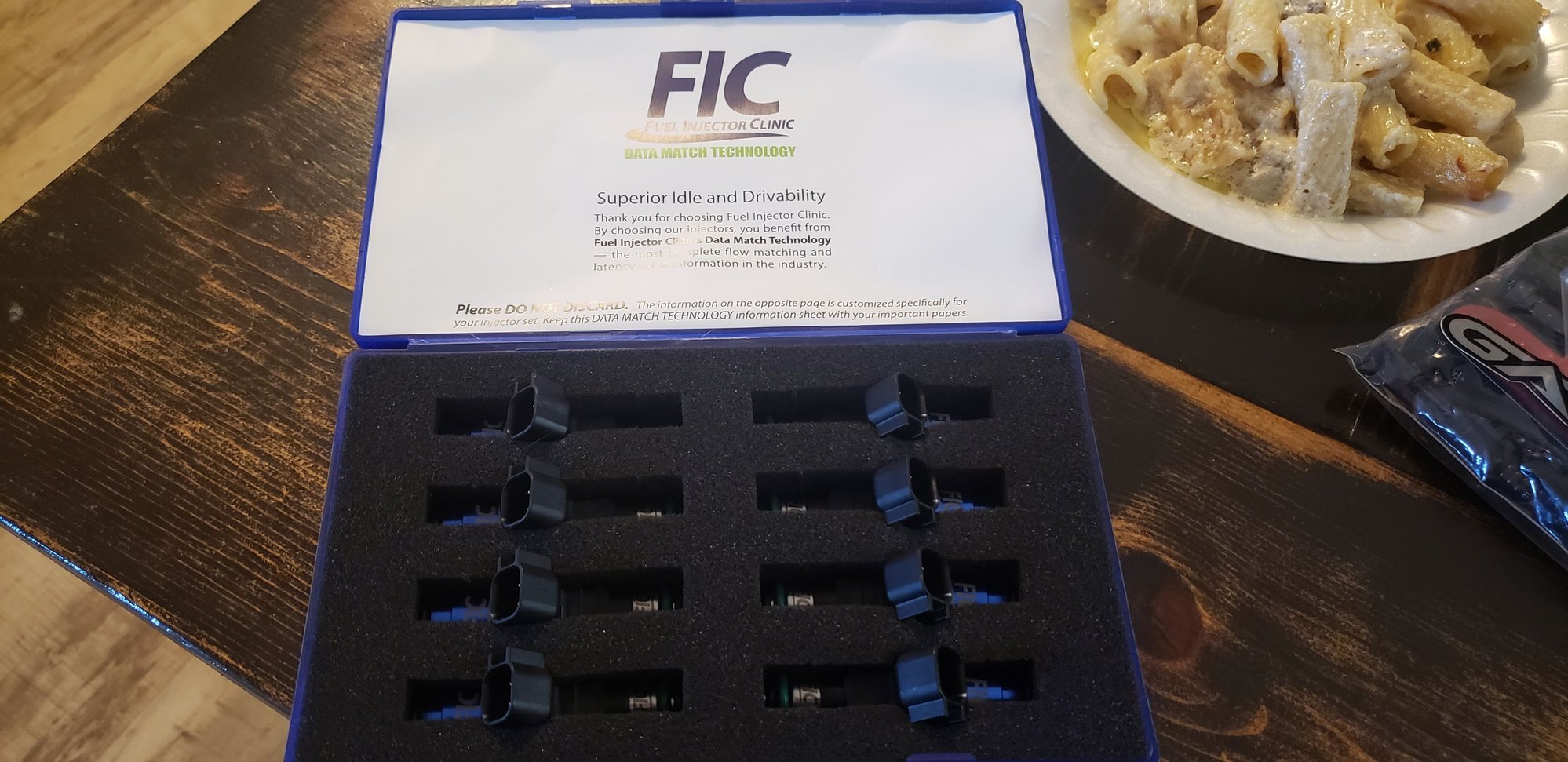

Default Random pictures and new parts

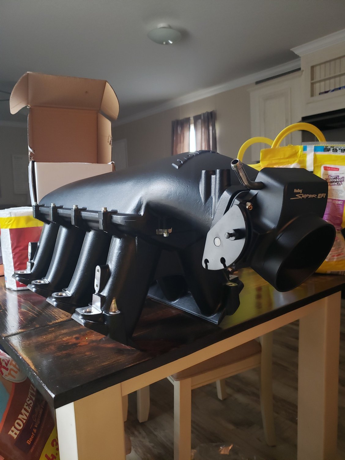

92mm
Hi ram

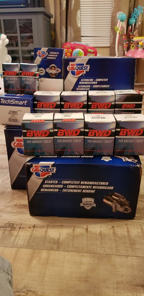

Alternator, waterpump, starter, coils, knock sensors and harness,
Trucool 40k

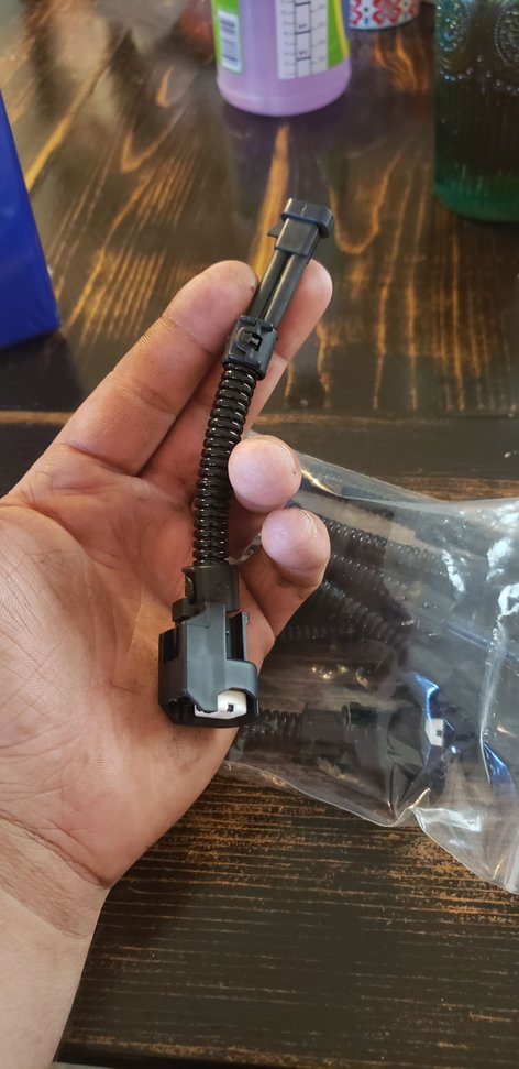

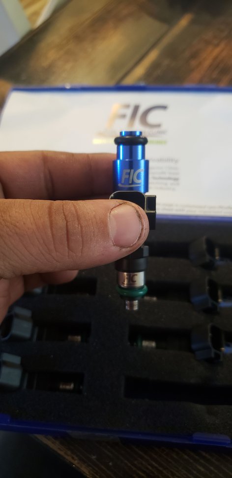

Fic 1000cc
Fuel injector clinic
Glenns auto performance plug and play harness
