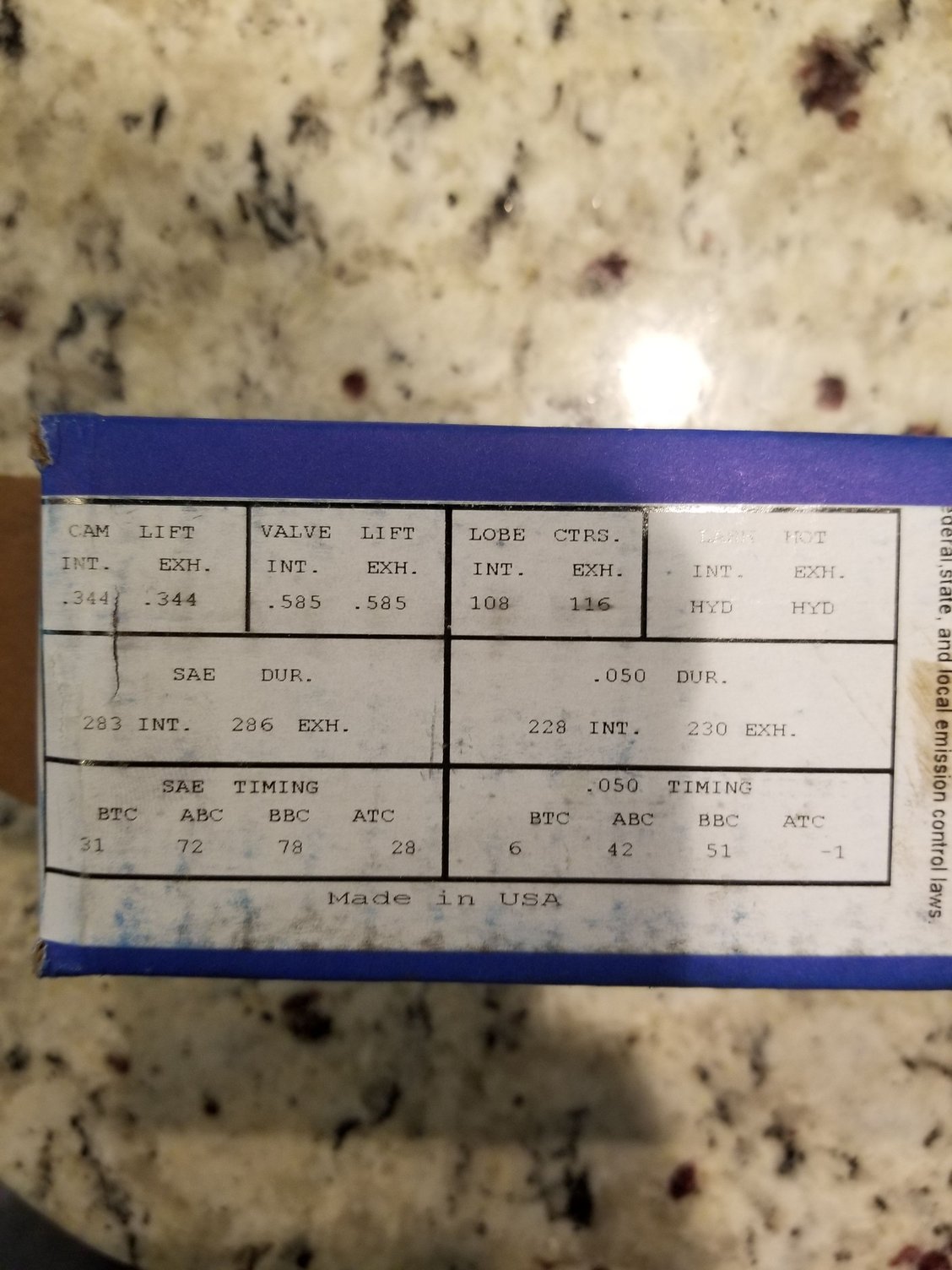

I have a 585 life cam in it i also have springs I can put in the heads anything else you can think of?
Old Jul 31, 2020 | 10:21 PM
01CamaroSSTx's Avatar
Joined: Feb 2015
Posts: 5,995
Likes: 2,286
From: Conroe, Texas
What is your camshaft duration?
Old Jul 31, 2020 | 10:32 PM
nicholashood's Avatar
Joined: Jul 2020
Posts: 6
I'm not sure right off I'll look in the morning and send you a reply
Old Aug 1, 2020 | 02:18 PM
RB04Av's Avatar
Joined: Dec 2017
Posts: 2,180
Likes: 969
Duration @ .050" is 228°/230°.
What vehicle is this going in?
Good cam for a light car with lots of gear and/or converter, in a 5.3; will be TERRIBLE in a truck. If the 5.3 is SBE, it will be gutless down low due to the drop in compression (243 has larger chambers than stock 5.3 heads), regardless.
I'm not seeing it as a real harmonious combo, in case you can't tell.
