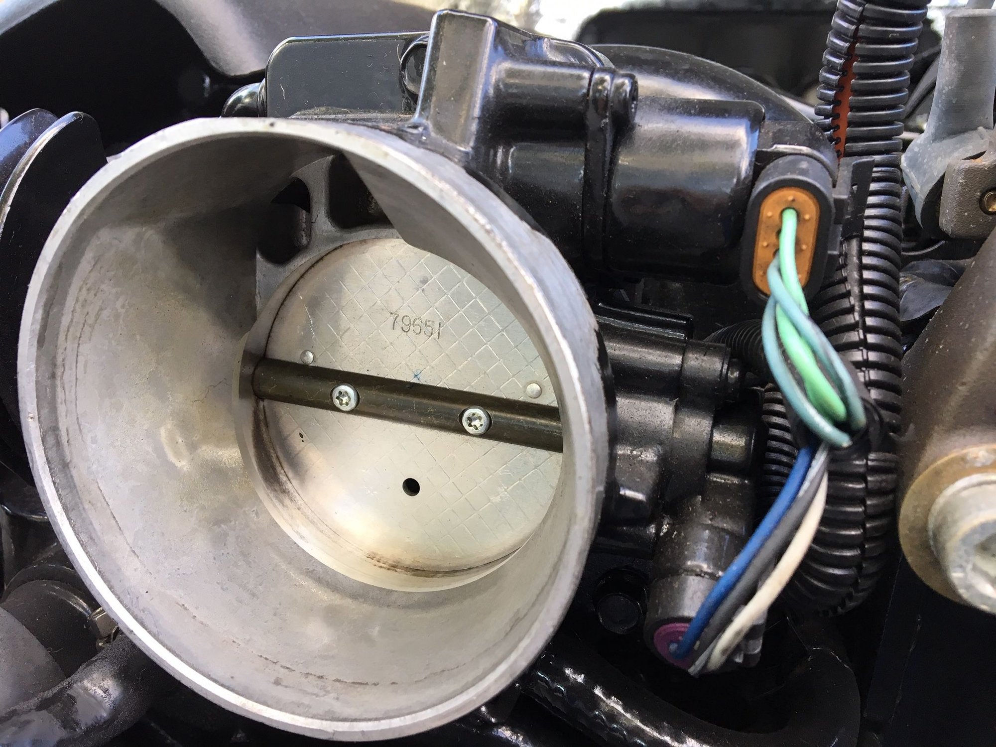

thank you - i will test the TPS. that is the bottom sensor with the purple plug in this picture, right ?
PS - old picture, i cleaned the throttle body since this pic.
Old Aug 20, 2020 | 01:08 PM
00pooterSS's Avatar
iTrader: (40)
Joined: Mar 2008
Posts: 4,920
Likes: 531
From: Dallas
That is correct
