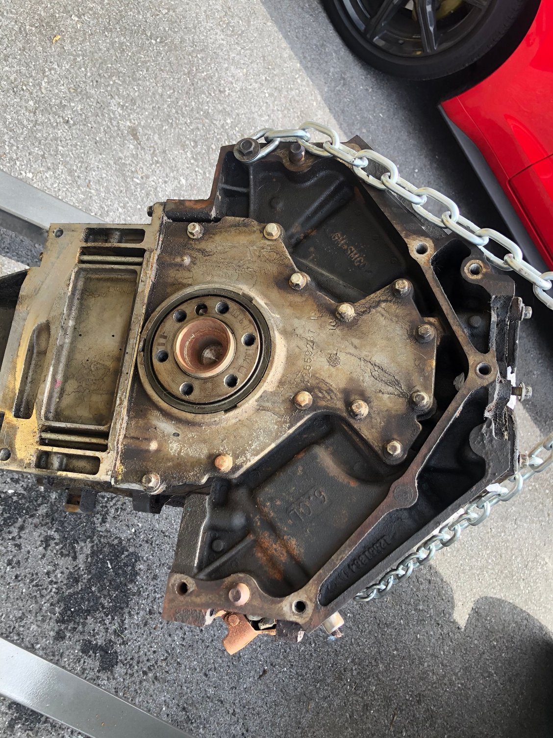

Is this one of the extended crank 6.0s?
Ive got a hydraulic TOB and trying to see if the spacing would be different going from the current Lm7 to this LQ4.

No it's not.

Originally Posted by 1FastBrick
No it's not.
^^^^^This^^^^^^^^^^^^
To add, the "long" crank hub sticks out about .400; very noticeable.

So I’m trying to picture the hydraulic TOB is measured from the face of the tranny to the clutch fingers it should be the same right? It’s been a few months since I originally measured it all and installed.
