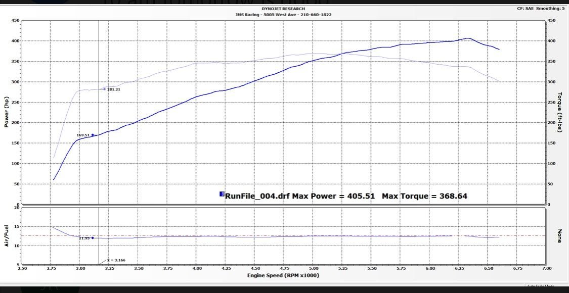

Last Dyno session @ JMS in San Antonio - 405rwhp

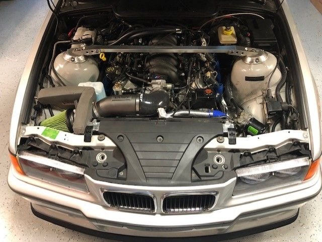

car was dyno'd with the MAS in place... he switched to SD.... I have not removed the MAS..... now all 4" pipe.
moved IAT from the elbow close to the radiator.... fear it was getting heat soaked. Move it into the end of the cone filter in the cold air box.
upgraded the cold air pipe from cobbled together al tube with dents.... to air-raid smooth 4"
upgraded air filter from 3.5" to 4"

Any idea why the power drops off so drastic up to? i would think that it would carry power out farther and smoother than that.
On a dyno jet I would expect to see more than 400rwhp with those heads, but again a dyno is just a tool.

LilJay - tuner mentioned the power drop..... was thinking valve float.... but these are box stock new TFS heads/springs.

The TFS dyno sheet peaks a little higher rpm @ 6500
https://static.trickflow.com/global/...60%202014c.pdf

I've "read" on the internet that the HS rocker are heavy over the nose and cause valve float if you don't run enough spring pressure, but I can't say from personal experience.

You should be alot closer to 450 wheel with that setup. Your horsepower peaks a little early but what really catches my eye is how quickly it drops off, most likely from valve float. From my own experience i can tell you aftermarket rockers require alot of valve spring to keep everything stable. On my own car with a 233/239 tsp cam, yella terra 1.7 rockers and tsp .660 springs the engine would hit a wall at 6500. With what you have i would run pac 1208s. With those springs you should be able to rev cleanly above and beyond where this setup is going to make power giving you a margin of safety in case of a missed shift or a money shift. As for the cam the lift is a bit low and definitely not taking full advantage of those heads. Duration wise i probably wouldn't change anything unless your looking for more of a max effort setup.
I would start by changing springs, dyno it again and see what happens.
fwiw my friends 01 ss has these TFS 215 heads, 235/239 cam with around .630 lift. Ls6 intake, 1 3/4 headers high flow cats single 3" with a cutout. T56 car, 9" rearend with 4.30s and puts down over 450 through the stock maf and unported throttle body.

I dont think you will be making 450 wheel with what you got. 400-420 is what I would expect. I would ditch the HSRR and get a set of texas speed rockers which are supposed to be way lighter. Leave the cam and springs alone and get a fast 102, 102 nw tb, ls2 rails, 102 maf and a ftp lid. Pretty pricey for all of this, way cheaper to run a plate kit and make more power but if NA is the way you are going then these little things add up.

1 - change out the 90 deg elbow intake to a c5 style air bridge
2 - change out the LS6 intake/tb to a Mamo Ported 92mm Fast intake/tb
3 - change out HS rr's to YT rr's..... see if I get my last 500 rpm back.

420 wheel threw a t56 with that setup is low. That is bolt on stock long block ls6 territory. Or even a cam only ls1 with bolt ons. Fwiw a stock ls1 cam makes power to 6200 then nose dives.

1 since this in an ls swap into a bmw m3 the air intake has a sharp 90 elbow at the Tb. Also I had a cobbled together dented intake pipe that necked from 4” to 3.5” filter.
2 when I last dyno tuned I had the iat right behind the rad and it was heat soaking bad.

Also 420 isn't that bad depending on the dyno, I would ask what other vehicles are making on said dyno and compare. I have TFS 220 heads with the BTR bowl blend a 232/236 .600/.600 lift cam with stock LS6 intake and throttle body stock MAF and made 421 rwhp 416 Tq on a mustang dyno, other cars on that same dyno for example a gt350 made about 390 stock on it. I've run a lot of cars that say they made 460, 450, 480 on other dynos and walked em……. my car is a full weight WS6.
