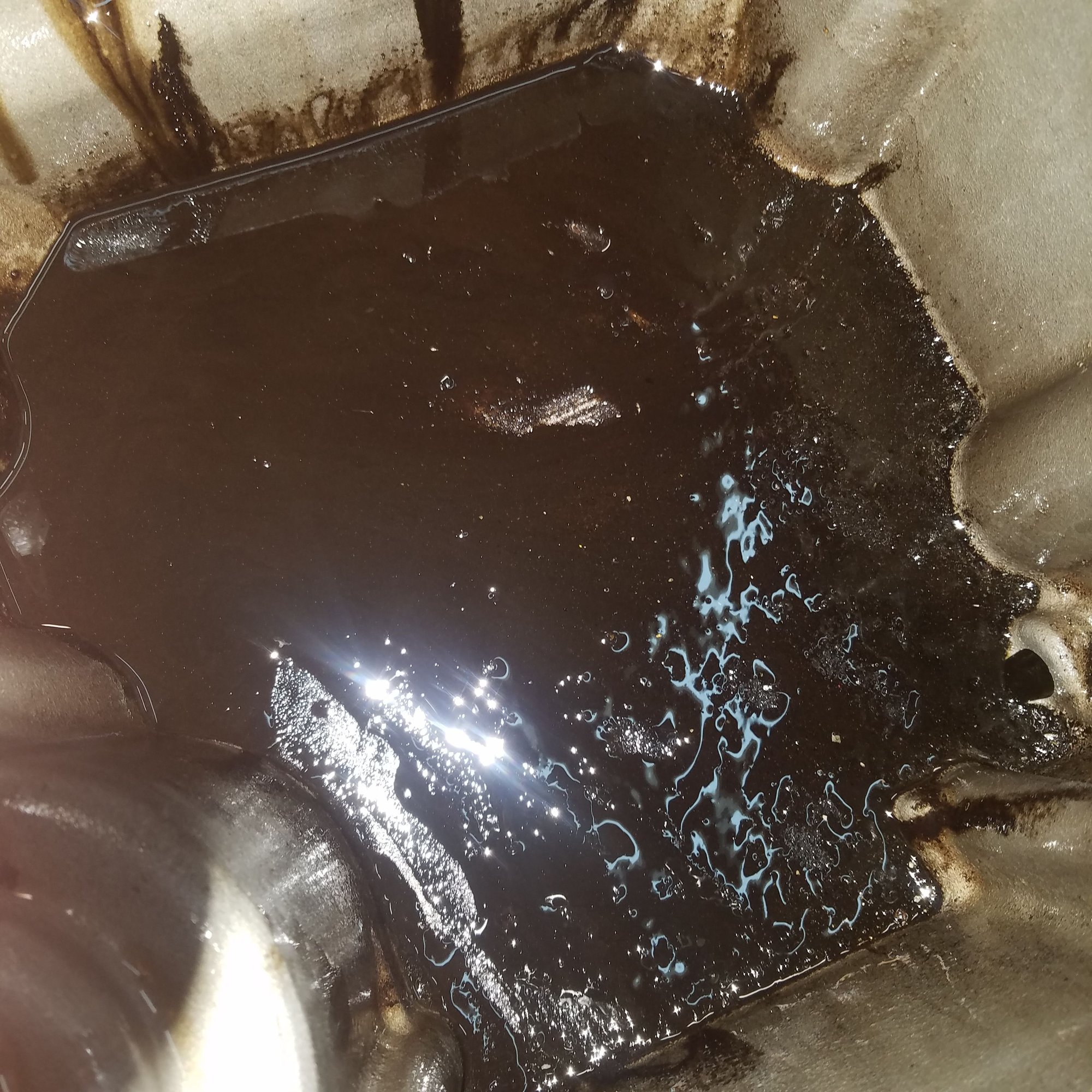

Drain the oil and see how it looks. Cut the filter open as well
ok. I'll do that whenever i get home this evening.

Not the lifters. Lots of shavings. Sucks. But it is what it is.

Bummer. Same thing happened to me last year, sounded like a lifter, oil pressure was the same, number 6 rod bearing went.

.......... and judging from the look at the oil this is not a fresh build...
Oil looks to be crude....
