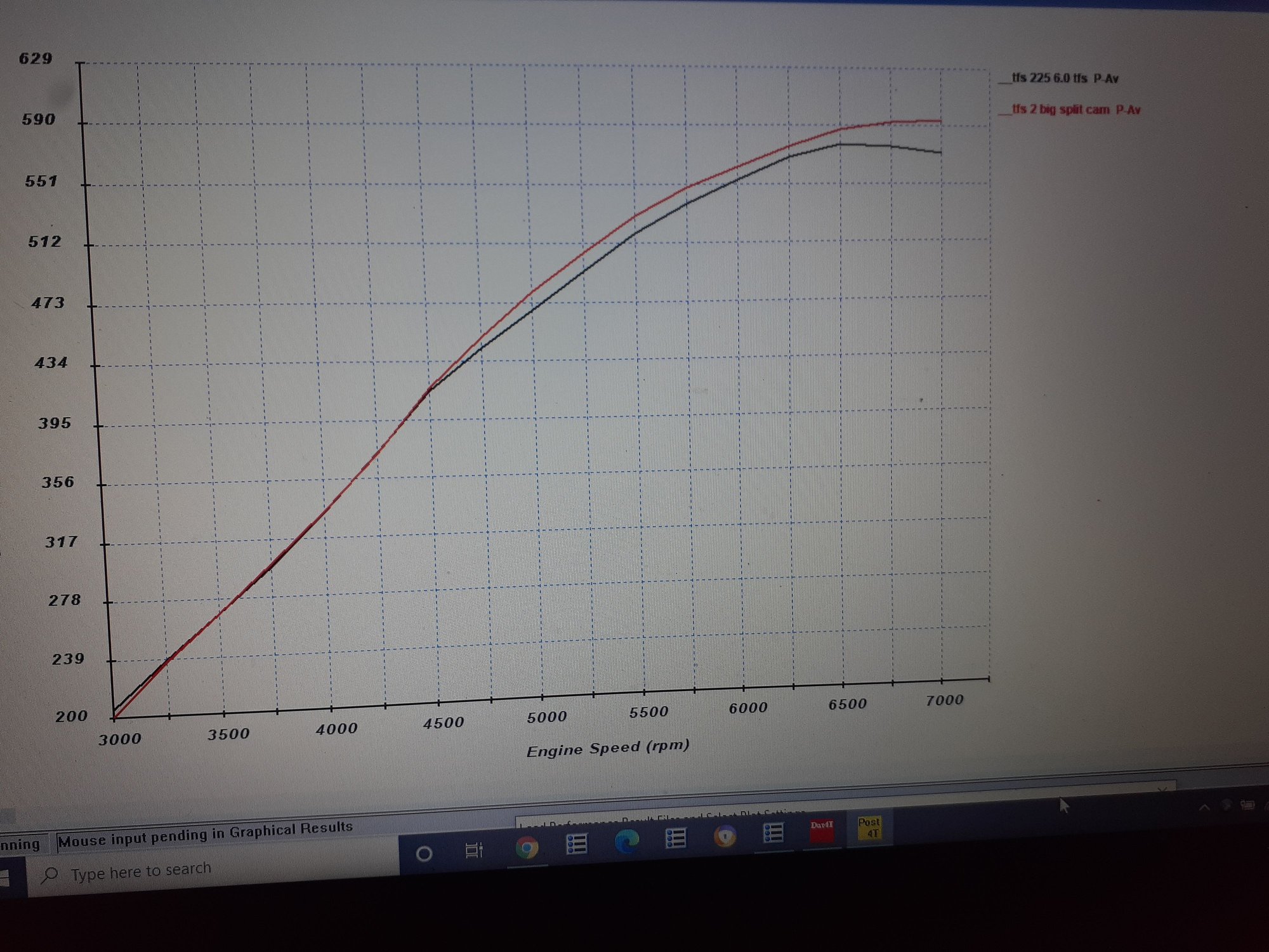

So anyone that cant get your head around why .
here is tfs , fast, 231/239 113 cam.
574 or something hp.
i matched his curve exactly in sim.
same head,flow #s Intake runner length and volume ,everything is the same!
then i changed to a off the wall cam.
at 228/250 112. It was hard for me.not to push the overlap.but ididnt. I am sure some of you know this has been done. Nothing new. Its just not normal. So its ignored.
i could show why in the pressure traces . Its just to much to post. To indepth. Valve timing will always be a question thats never answered 100%.

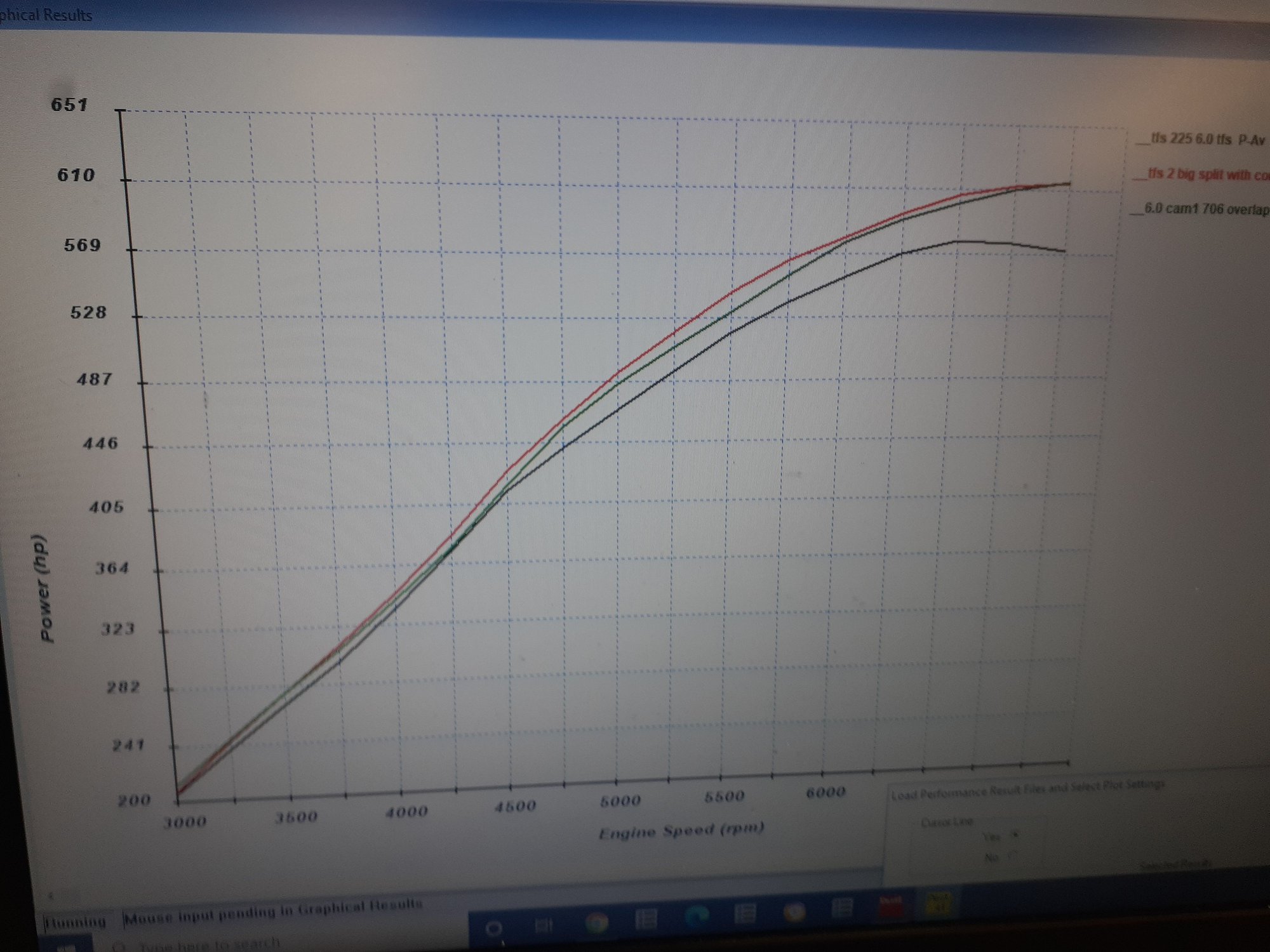

To answer op original question.
Hopefully your exhaust works as good as it looks. Small valve,smaller seat typical 300cfm flow curve head. Went 612hp at 233/253/110 . At 11.5 comp. 23 overlap
green line
Redline , Adding 0.9 point comp ,11.1 228/250/112 cam and high flow head went 610hp.red line.
(was showing signs that was limit of comp with that cam)
They both have close to same delivery ratio.
I would assume your intake valve side of head is even with the bore.
If anything this will show u guys what does what.
