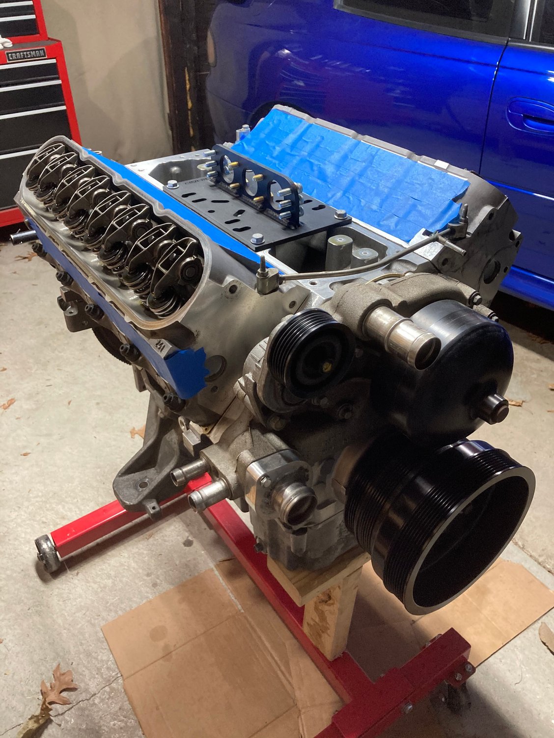

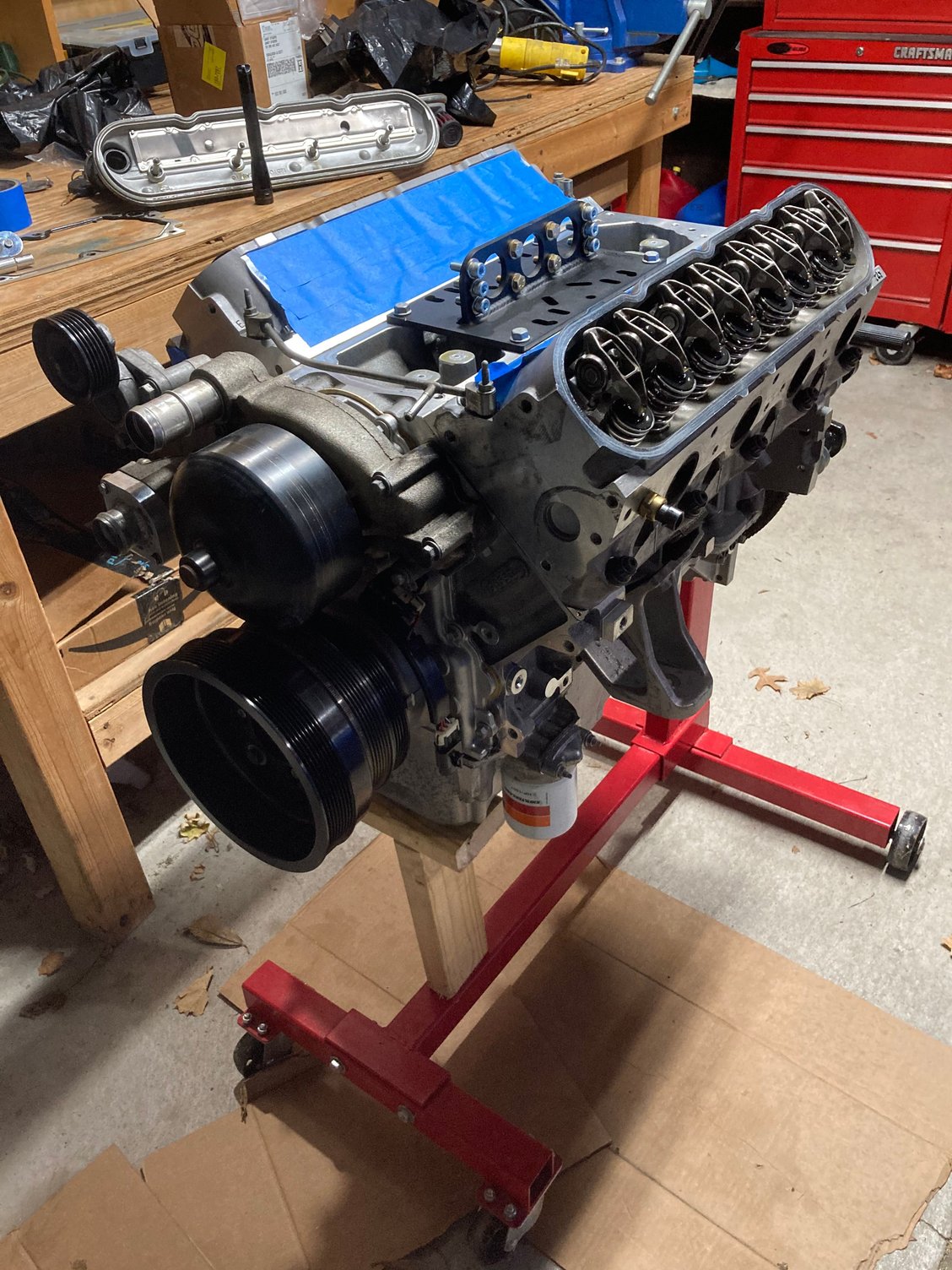

So last year around this time I built my motor starting with a forged rods/pistons LS3 block from TSP. I used my stock ls1 top end and a budget valve train to include...
Custom cam from cam motion
Ls7 lifters from BTR
11/32 0.120 wall pushrods from Summit
Ws6store max effort rockers
I’ve been over 800 rwhp and probably closer to 900 rwhp by the end of the year with a D1x procharger. I shift at 6950 rpm.
Have the motor out to change a leaking oil pan gasket and go over things. Plan is to push for over 1000 rwhp next year with no changes except bigger injectors and more boost.
Everything in the valve train checks out perfectly fine. I’m very happy with all the parts I’ve used. Already reached my intended goal when I picked these parts, but I’m not a bracket racer so let’s push it further and see what happens.

And they say LS7 lifters are trash What springs? Whats the cam specs?

Just a .660 lift spring kit from BTR and the cam is aggressive for a procharged 377 its 232/248 with over .620 lift on the intake side. Super simple setup, but effective. That's why I like prochargers easy power for simpletons like me LOL. I used a preload of .080 to .085 they were all consistent within that range.

A lot of thought went into this combination and I had a limited budget. I already had the procharger on my stock ls1 and wanted to make a lot more power reliably. With my budget it came down to a forged short block or a good top end, but not both in one winter. I decided to go with the forged short block and reuse the top end I already had. This also allowed me to sell a good running ls1 short block. This would also leave the option for the following winter (which is now) to upgrade the top end. Well everything is working so well I decided to leave the heads on it and reuse the top end again while continuing to add more boost. I'm not really concerned if it takes 20+ psi to reach 1000 rwhp since I'm on ethanol and have not yet experienced any high IAT issues. I've seen people make 1000 rwhp on 8 psi with top of the line stuff on a 427 which is cool, but if I can make 1000 rwhp with 241's, an ls6 intake, and a stock throttle body that's cool to even if it takes 20+ psi.
This is kind of the opposite of what is common as most seem to put better heads, intake, and throttle body on a stock bottom end and push it to the limits. If I hurt the motor it's less pain when the heads are throw aways rather than some really nice $3500+ heads.
