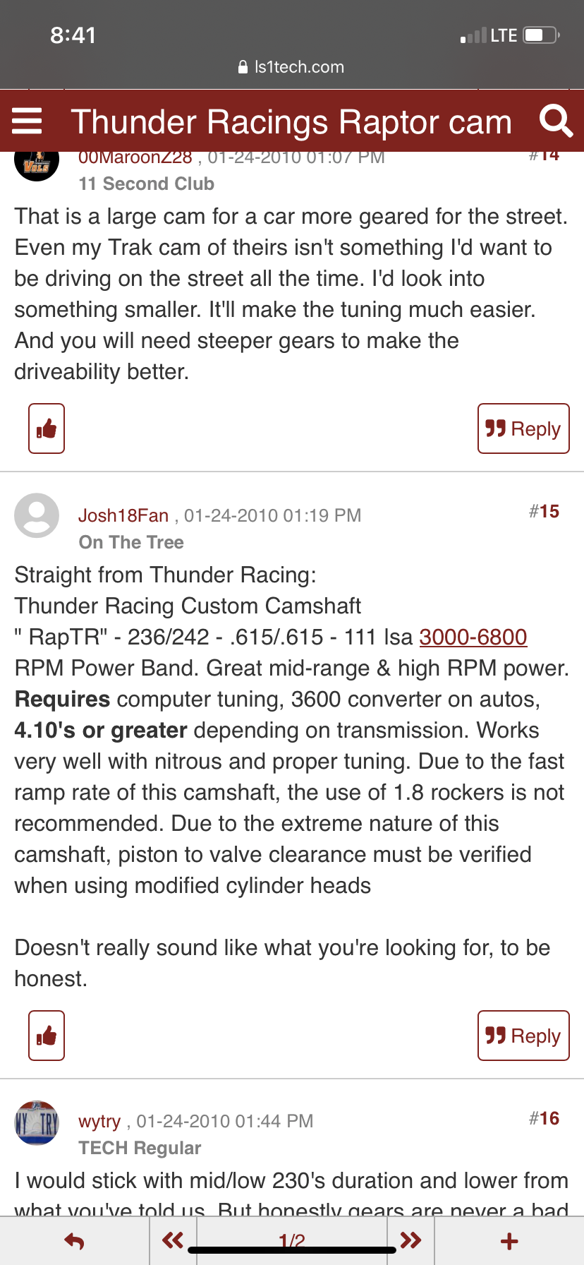

I want to put the cam in because i have it and it’s still good. The car is an m6 and has 150 shot of nitrous in it. I know everyone will say it’s too big of a cam for the 5.3 and the small stock heads that are on it.
my question is will I have any piston to valve clearance issues?
I attached the cam specs and what was found on this site about what thunder racing suggested on an ls1.
