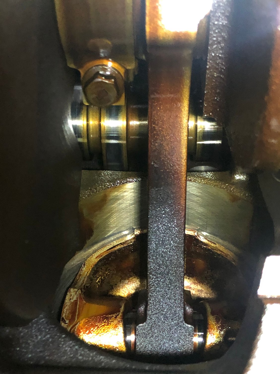

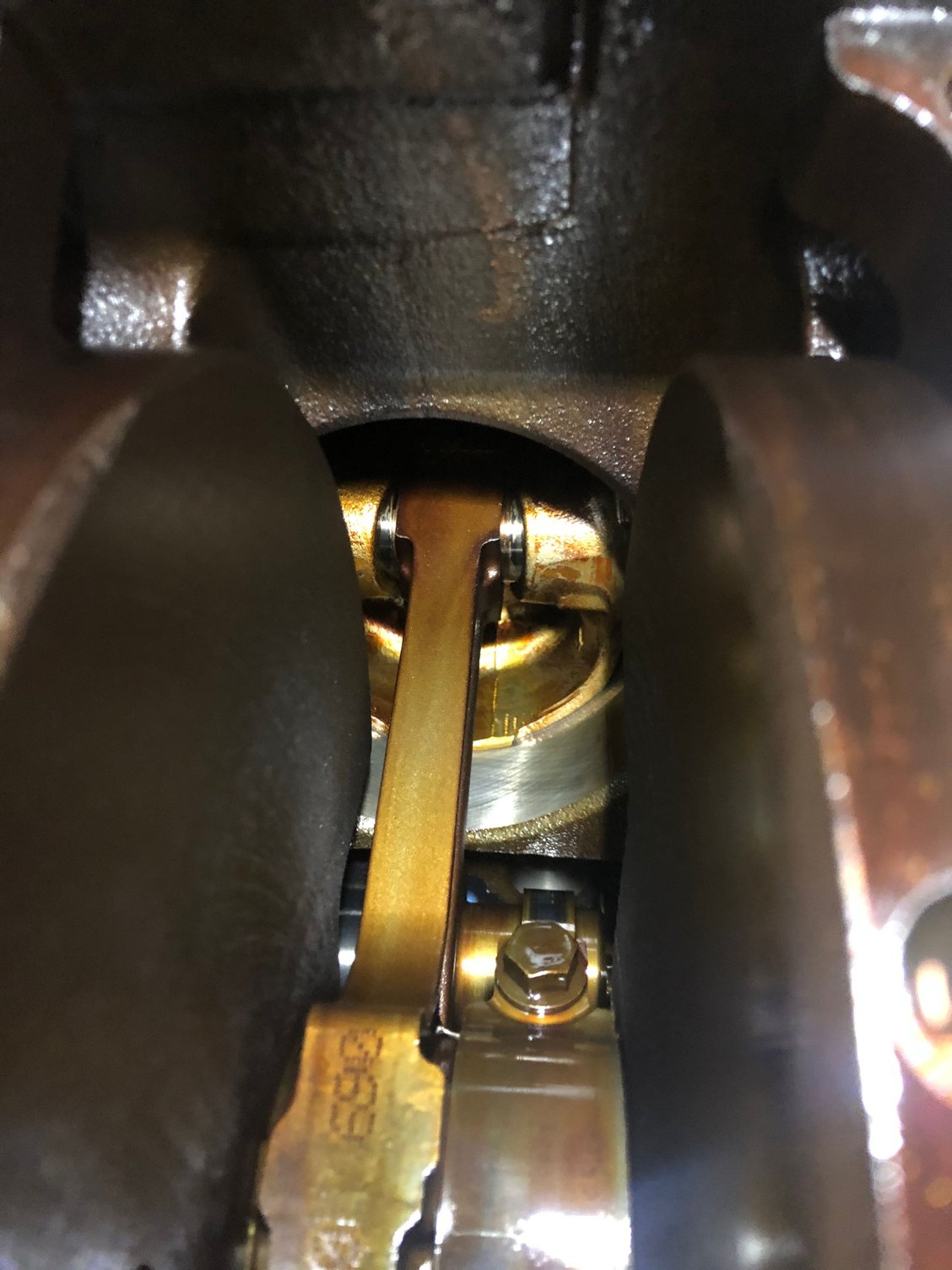

However, now that I'm down to the block and rotating assembly, I found something concerning that I don't understand. There appears to be burnt or caked oil on the connecting rods, only on the odd bank. Here's pics a good one from the even side (2):
And the worst from the odd side (5). Most appear very similar:
Is this a known cause issue? Common? Other thoughts???

If the engine spun the other way, it would be on the other side instead.
Roger that... so expected and not concerning? That's what I like to hear
