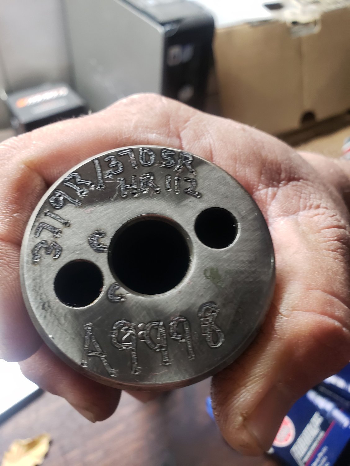

Anyone know what cam this is came out of ls1

Those are Comp lobe part numbers. You can look it up in their lobe master catalog online.

What I came up with was a Comp Cam 232-236, 575-578, on a 112 LSA.

I didnt see it in there
COMP Cams Lobe Catalog
Both lobes are on page 30
