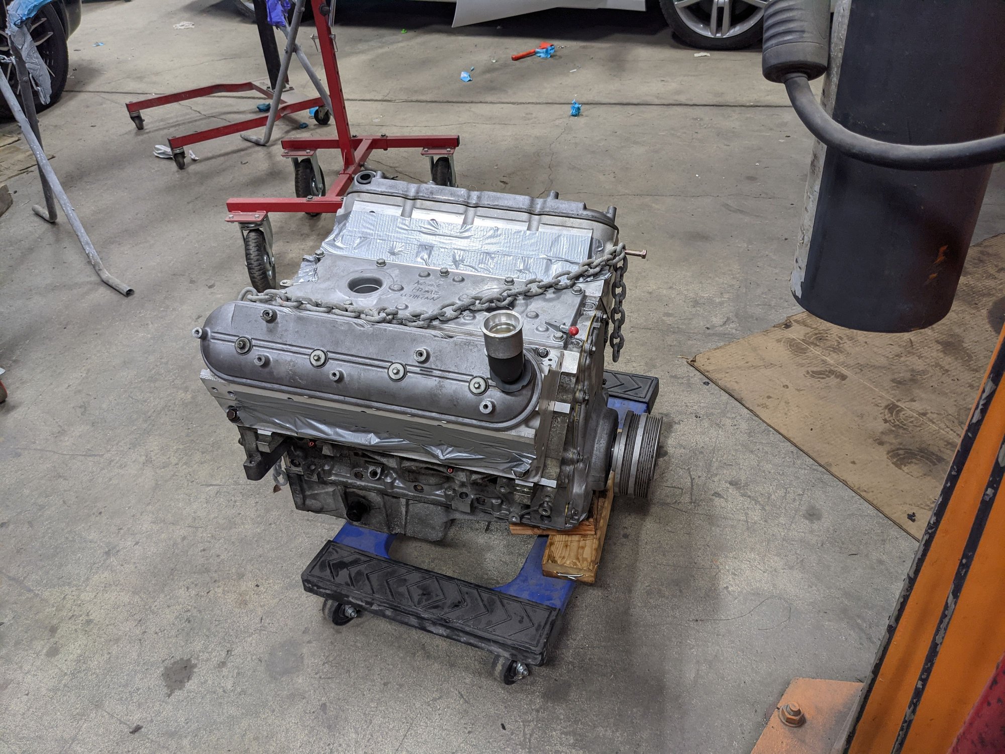

The Engine as I said was already modded and forged but I had to make a few changes. It is now:
LS1 Block at 348CI with Mahle 3.910 pistons with 4.1cc valve reliefs, Lunati Pro Billet 6.125 rods, Stock nitrated crank. Was 3.905 diamond pistons before. These turned out to weigh exactly the same. lucky for me.
TFS 220 Fast As Cast Heads milled too 61CC, these were on there but had them cleaned up. Valve job and such.
650 lift springs with Ti retainers. These bring me to 10.5:1.
Coming from a Futral F13 cam 230/232 .595/.585 on a 112, I went back to Futral to spec me something better suited to my heads as I was cam only before the heads. This is the grind Allen came up for me: 234/240 .620/.612 112+4
The LS7 Lifters are gone and now have a set of Johnson 2110 slow leakdown lifters preloaded to around 40 thousandths. Paired these with the Texas Speed steel roller lifters.
Added a Melling 10295 high-pressure standard volume oil pump.
ASP pulley with overdrive alt pulley, LSX 90mm intake, Nick Williams 92mm TB, 85mm z06 maf, smooth bellow, 85mm fast toys lid and K&N filter.

I do all my own work, well except for the engine rebuild this time. I was working way too much to try it this time but I have an awesome local spot that did it for me. I picked up all the parts but they did a great job of putting it together. Lab Engine Specialists on long island

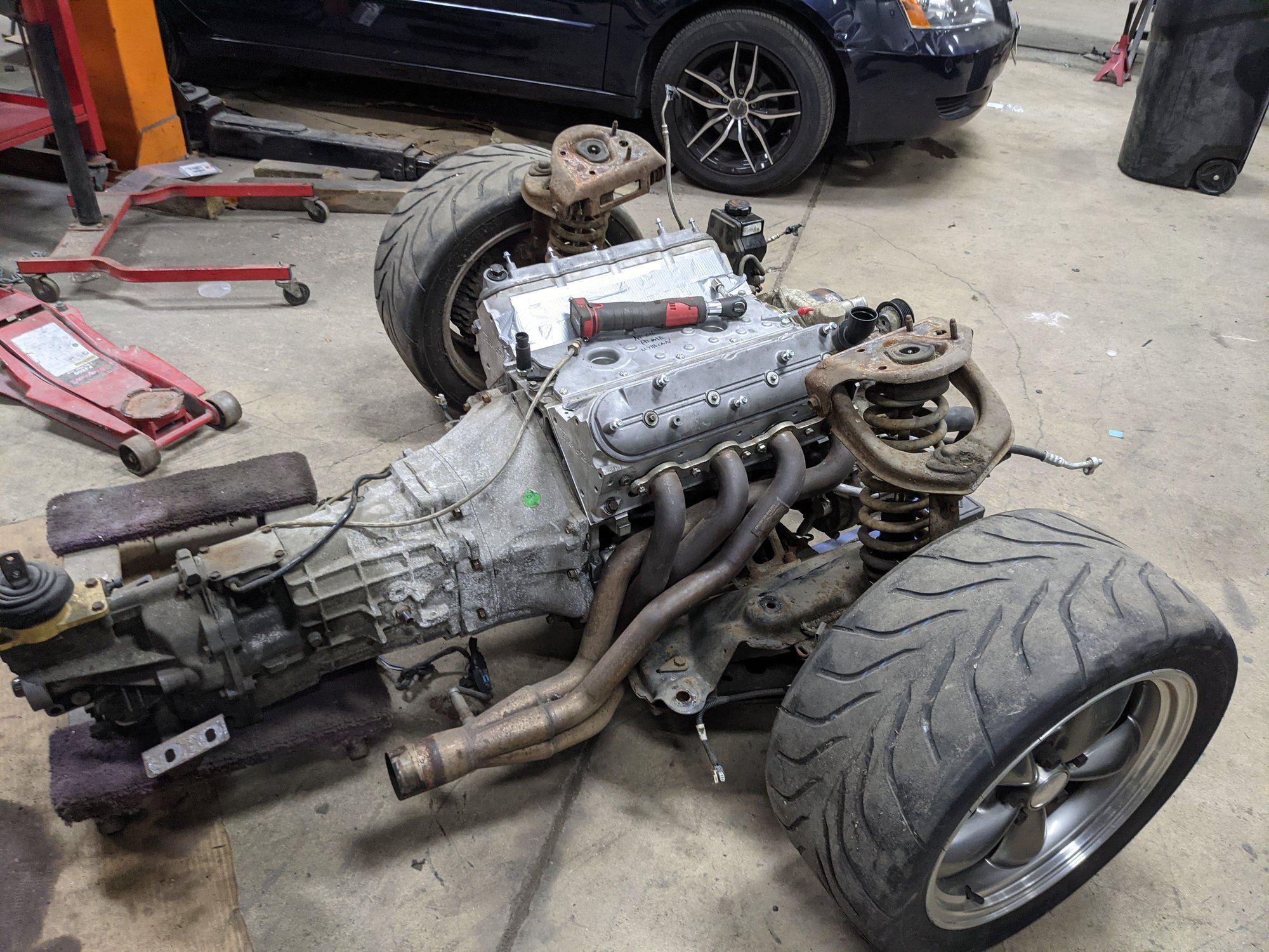

Lucky for me I have a buddy with a shop, I do some work there for them from time to time so I had lift access for the week. Got it all back in there on my own pretty much. Beats the hell out of doing it on the ground like when I was young lol.
It is all back in and Running awesome! The valvetrain is super quiet and feels like it is running almost perfectly. I have HP tuners and I have done some tweaking on the days that it's been nice out. Be Great to get it on a dyno in the spring.
