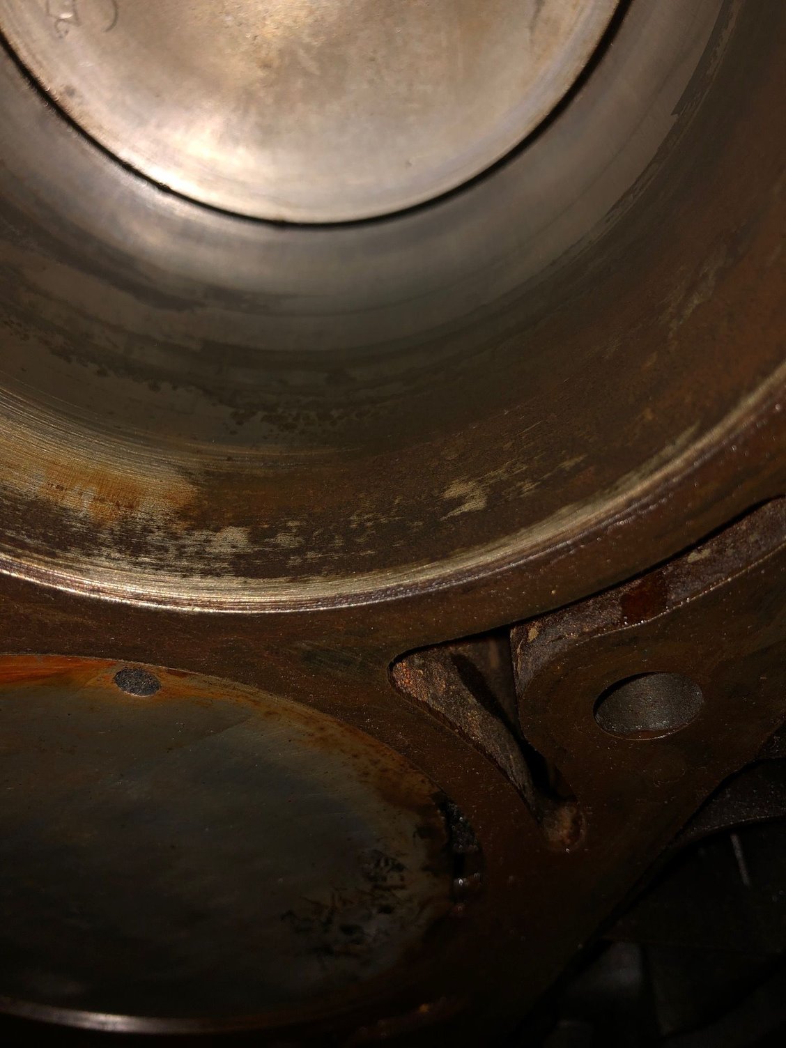

I picked this LQ9 up, has some rust on the cylinders walls, and a broken piston. I'm not sure if a garage hone will clean the walls up, what are your thoughts.

I'm just hoping it cleans up, if not, I'm thinking of having to bored 0.06" for an iron 6.2.

Exactly what I would do with it, only I would go .065 and use LS3 pistons because im cheap.. lol

What grit of ball hone to buy?

For my LQ9 (standard 4" bore) I used the Brush Research 240 grit GBD40024, bought it from Summit Racing IIRC around $50. Worked well putting in a nice cross hatch and the rings sealed instantly... still running strong with no oil consumption. Used it once then sold it here in the classifieds to get most of the money back.

240 grit Is correct.
I have used 320 if I am reusing the old rings.
