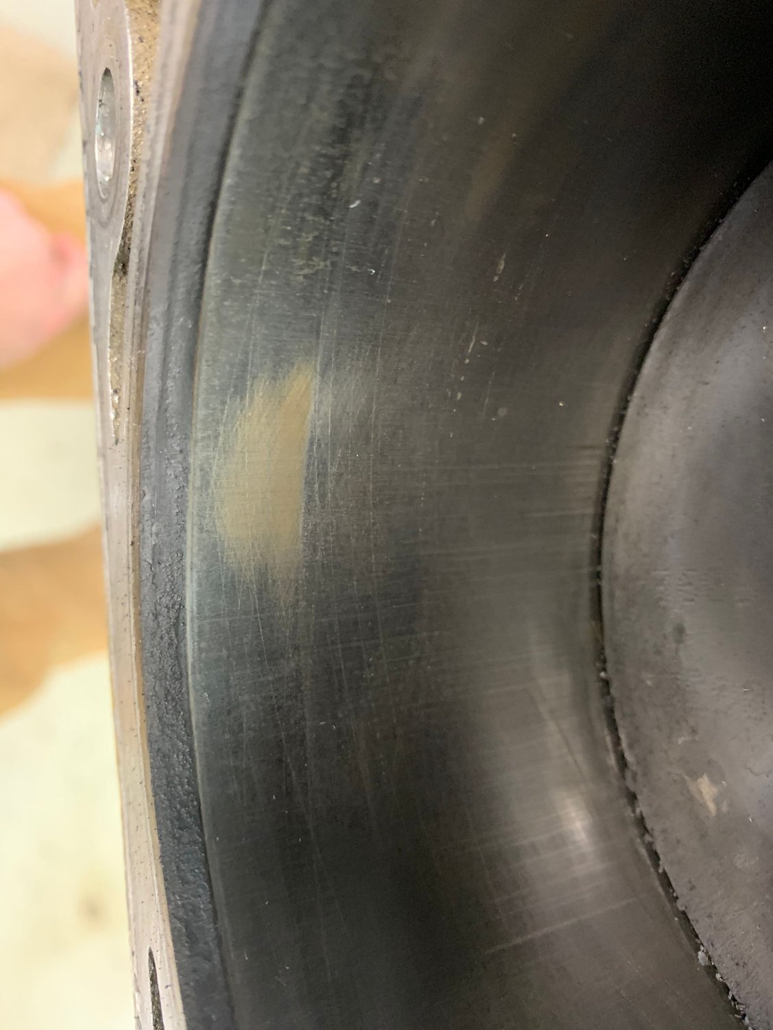

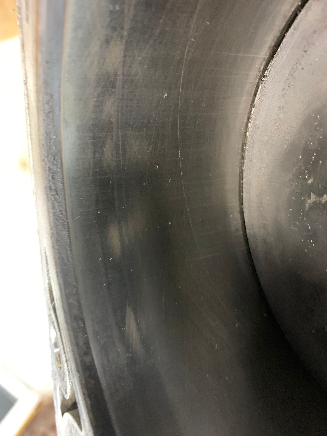

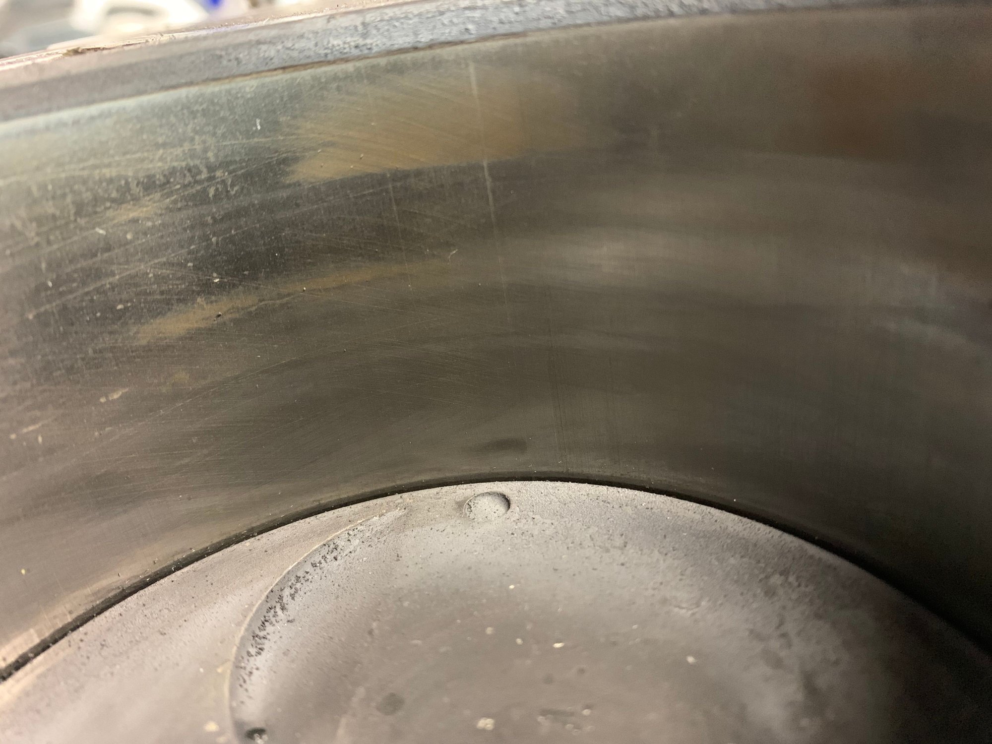

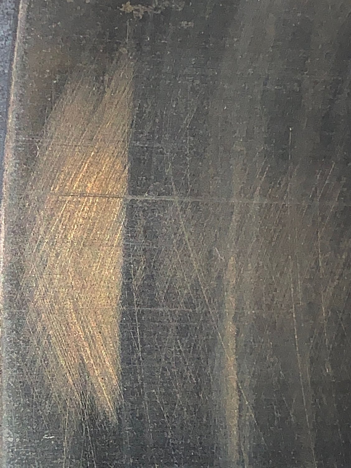

I just tore down my engine for a head/cam upgrade. I last had it tore down 4 years ago and everything looked great. The car has been running fine and I haven’t been having any problems. When I pulled my heads I noticed spots on the cylinder walls yesterday, almost all of them. They don’t catch my fingernail, appears more superficial. Anybody ever seen this?

Corrosion

You think? The cars been ran pretty consistently. You think it’s good to keep running it like this?

Looks to me like what happens when you hone a block without a torque plate.
Those are spots where the rings don't touch the cyl walls.

I completely agree. However the engine has never been honed or bored. It’s all factory. I wonder if that’s just a poor job from the factory.

It’s common on factory untouched stuff. Run it.
