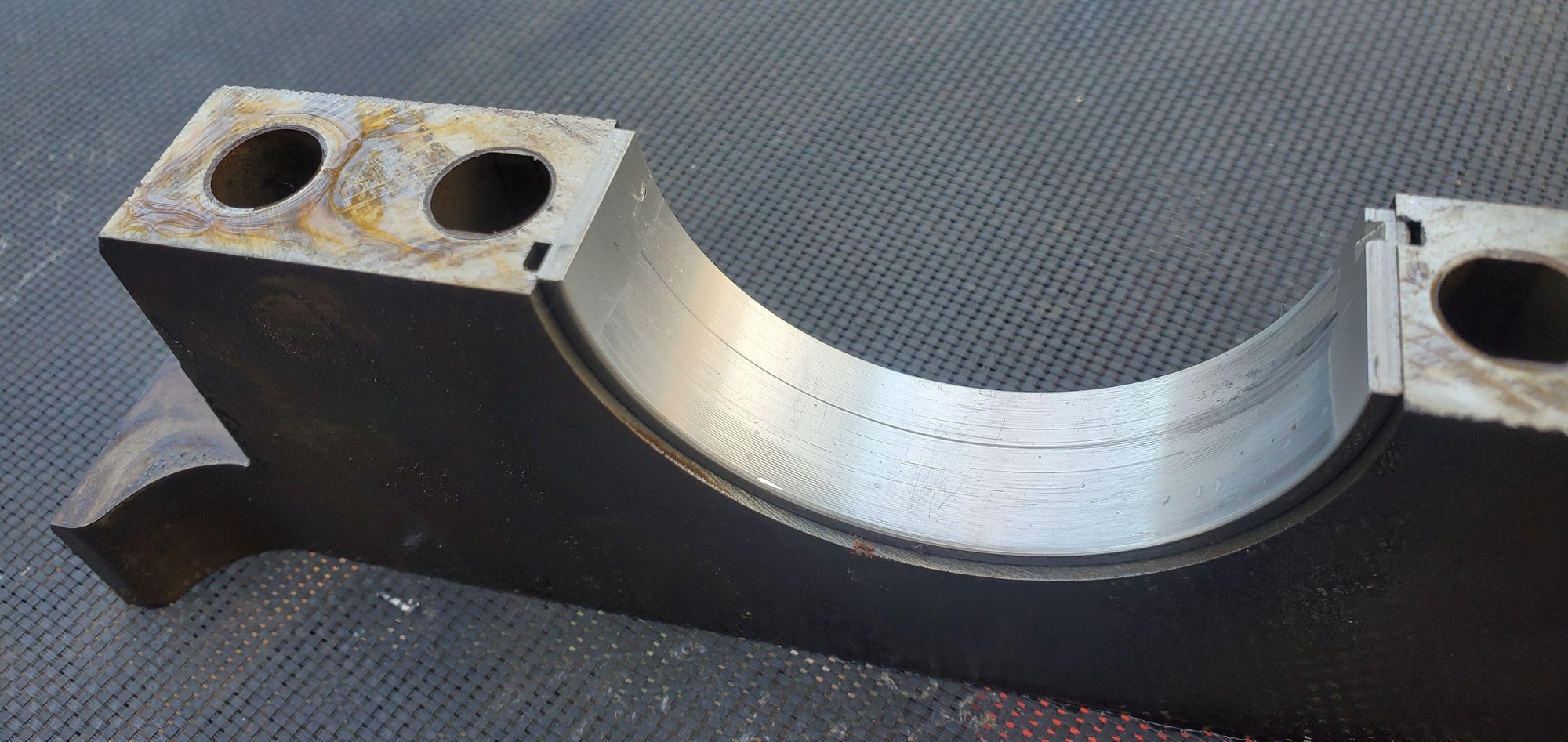

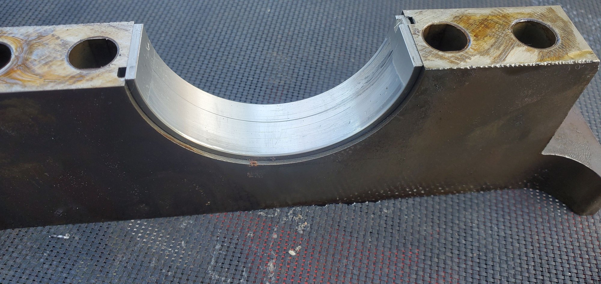

Have my L59 pulled apart in preparation for a cam, decided to check a main since the bolts are reusable and I had to pull the pan to get the pickup oring(thank God I did, that oring was plasticized and broke just pulling it out). The main has a weird wear pattern and a slight scratch that I can just barely barely feel with my nail, crank feels smooth and doesn't appear to have anything embedded in it.
Should I just run them or should I get replacements? I'll be putting in a sloppy stage 2 and a HV oil pump so it's not going to be making all that much power.

How many miles on it? Actually looks like someone spun a crank in it dry before it ever started. Otherwise looks OK.

Is it just one? I would replace it.
Donor had 187K on the odometer, PO said the trans was rebuilt but I think it also had head gaskets or heads done, tope end is way too clean for 187K
Haven't pulled the rest yet, ran out of daylight, I'll pull them tomorrow and take a look.
