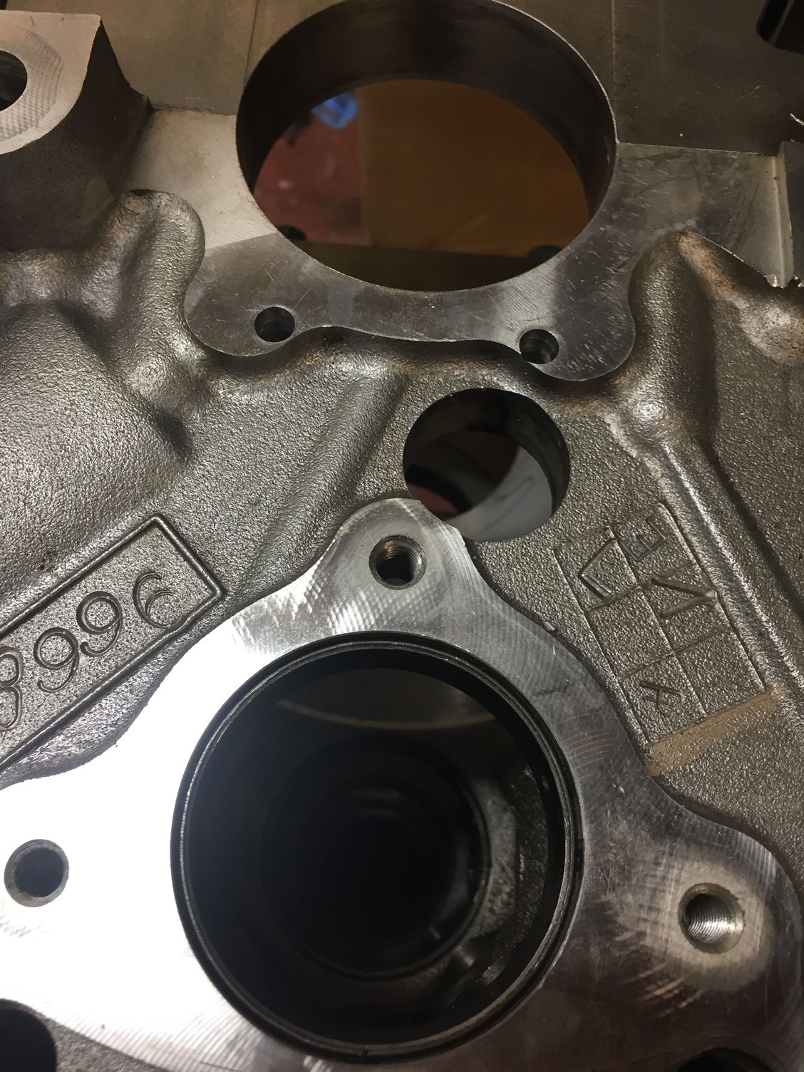

This is how it ended up.
Old Mar 5, 2021 | 04:35 PM
RB04Av's Avatar
Joined: Dec 2017
Posts: 2,180
Likes: 969
Mine came out looking just about exactly like Ron's. Except that his isn't tapped yet. I just put the LS2 piece (wasn't a stock one but I forget where I got it) where it needed to be, marked the holes with a punch, and went to town with a hand drill. Piece o cake and works beautifully. That kit does look kinda slick though, definitely reduces the chances for error.

It doesn’t fit the bosses very well. Which is why it wasn’t tapped yet. I made a tap guide to ensure the tap started correctly.

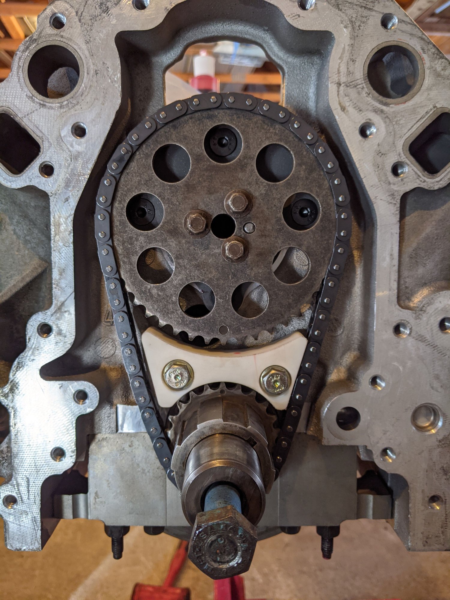

Didn't turn out too bad, could have moved a little more to passenger side but it's pretty tough to get perfect. If I had to do it again I'd rather do it with a bare block and the fixture.
