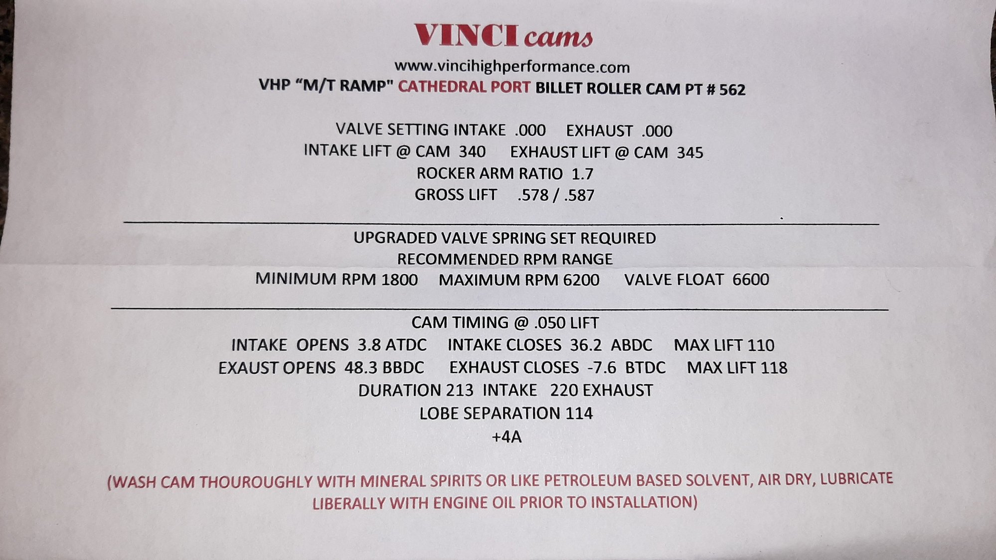

I am about to tie up a build with cam in card pictured below. Goal is to have a 6.0L torque motor at well. I put in the LQ9 flat top pistons... and used 317 heads altho have a set of the 5.3 heads as well. I want to run 87 or 89 octaine.
If I had the money would have got AFR 205 mongoose heads. Roger Vinci at vinci performance helped me spec the camshaft.
I also got manton pushrods, installed solid bushing trunions, dual valve springs, balanced bottom end within 1 gram, etc etc etc
Building up a 4L60E in my garage to take the torque after motor is done. For now going to dial back power a bit and use stock 4l60e

The flat tops are a good move to boost compression. That will improve power and torque across the range. With the 87 or 89 requirement, we'd stick with the 317 heads. You'd be right around 10.2:1 with stock head gaskets. We'd recommend 89 fuel, especially when towing. Even then you may get some unwanted knock when towing and find that you'll have to pull some timing. It’s not a good idea to constantly pull timing. The chance is there that you'll have to up the octane or toss in some octane booster.
That cam looks pretty good for a balanced driver and tow-rig. The almost 4* IVO will certainly provide a noticeable idle/lope if that's something you're after. Good move on the supplemental valvetrain parts to help keep things stable. Also, a solid plan for the stock trans and future upgraded 4L60E.
