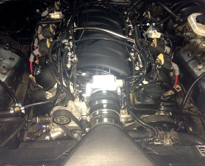

I know there are already many threads out there on this topic, but I have something new. So basically I have a LQ9 crate motor and I’m swapping it into a third gen f body. The pickup tube that came with the motor had the recessed part for the thick red o ring at the end. My new Holley 302-2 kit does not. The o ring that came with that kit was no where close to ever being pushed in and I don’t know why. I took the stock red o ring (the fat one) and it snapped right in. I threw everything back together and had great pressure while priming the engine with the starter at 35 psi. Then after looking into it more I started panicking since the fat o ring isn’t meant for a straight pick up tube. I ripped everything off again and now I attempted to put in the blue o ring. It doesn’t snap in at all and does not sit flush with the pump unless you tighten the bolt. Any ideas on where to go from here? The red o ring that I pulled out was just fine so I probably just wasted all this time and money. The red o ring also took some pressure to get it over the pickup while the blue one is fairly loose fitting on the tube.
