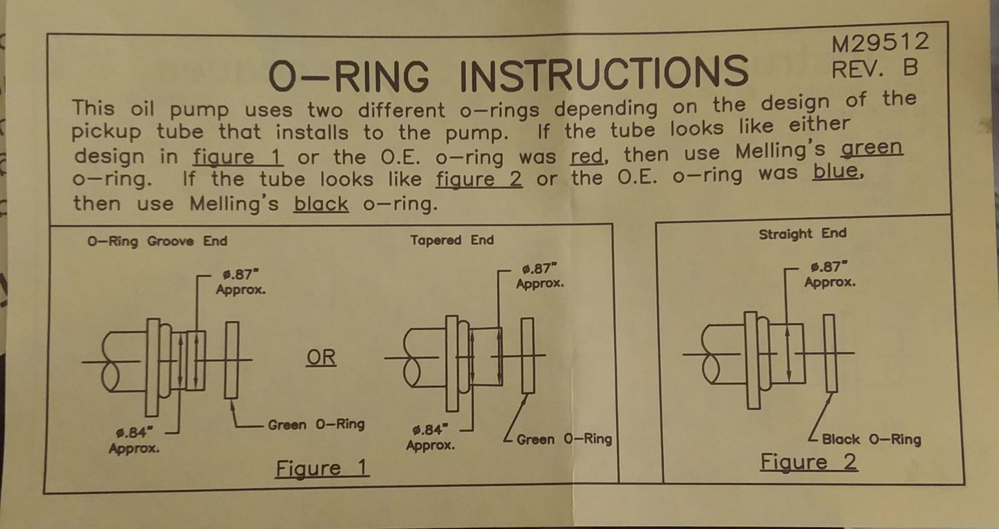

Very possible you have a clogged oil filter and/or screen on the pick up tube and just make sure you install the correct o-ring on the pickup tube and lube it well before installation.
See post 107 on the link below.
https://ls1tech.com/forums/generatio...earings-5.html

Thanks, putting that pic here for future reference. man that crank is done.
