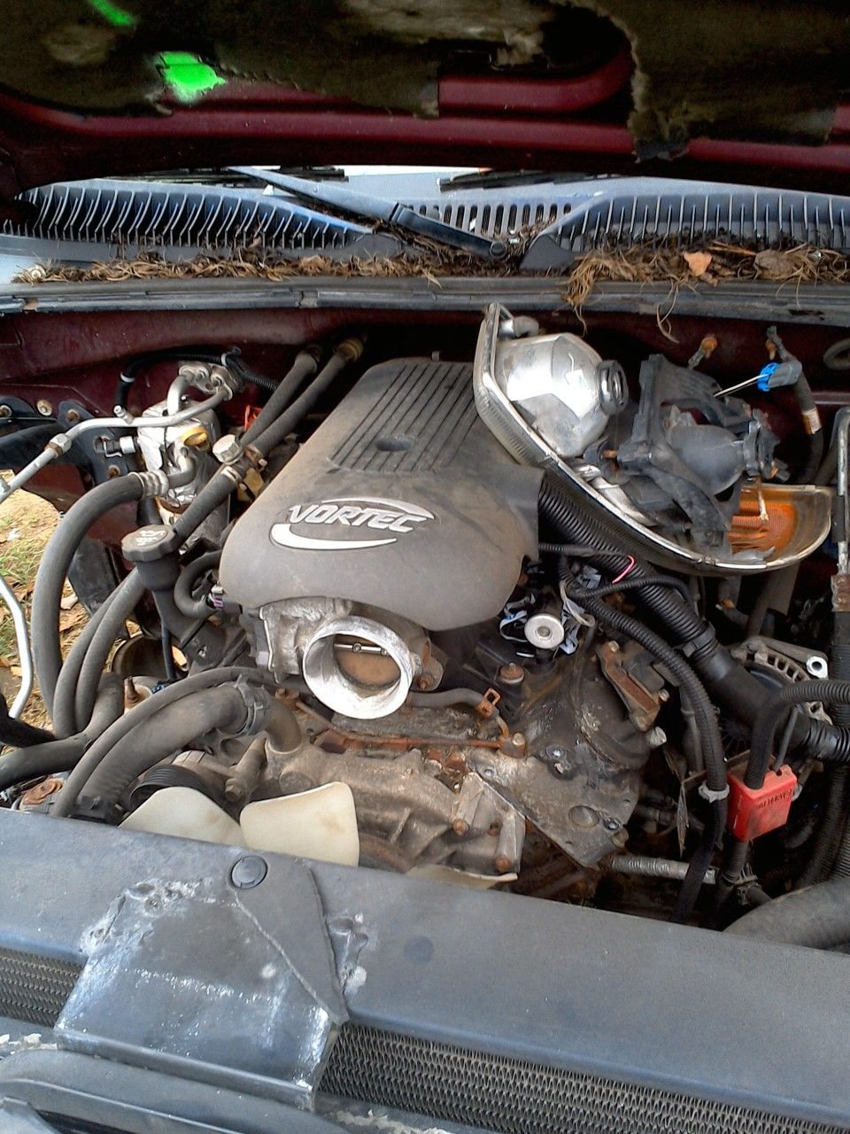

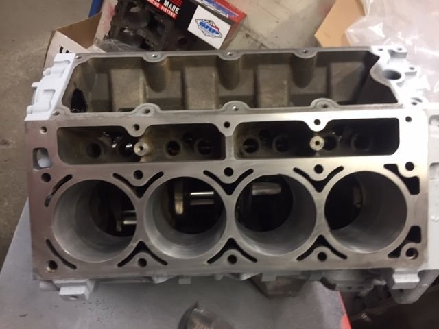

If you look around there are some good stuff at reasonable prices. Picked up a complete LQ4 for 700.00. Sold the 317 heads, ECM, wiring harness, intake with injectors and even the exhaust manifolds. Total cost to me for the block and crank, front & back covers........300.00.

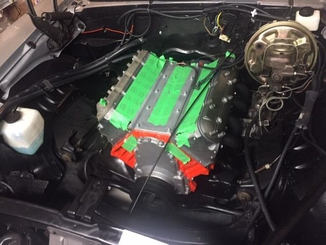

Had the block machined and added some Gen 4 rods and new SRP pistons.
Added some LS3 heads and there you have it........long block done.
