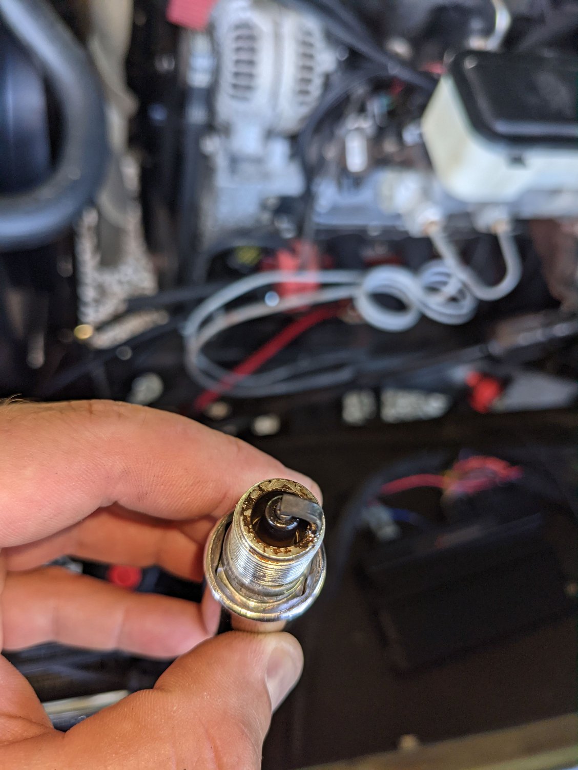

This weekend I took it for a short drive and brought it back home and parked it while I went inside and left it idling. When I came back out it was putting out a significant amount of blue smoke on the left bank only. It has a true dual exhaust with no crossover pipe. I pulled the plugs and the plugs on cylinder 1 and 3 are wet with cylinder 3 being the worst. I plan to do a leak down test when it stops raining.

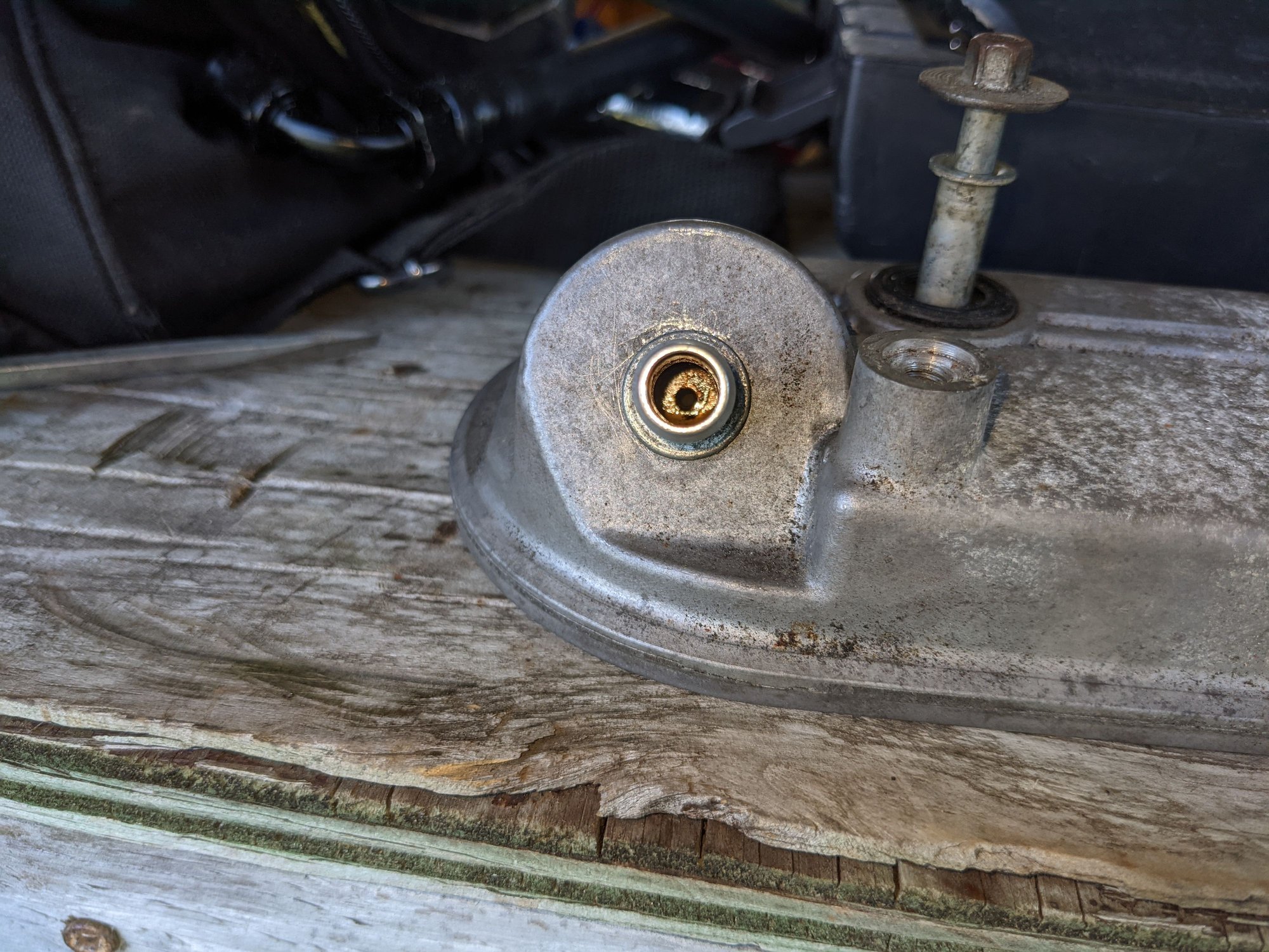

Wouldn't the pcv show up in both banks? I know it feeds into the intake on that side but I would expect faint smoke on the passenger side bank. I can try plugging the intake and exhausting the valve cover to atmosphere though.

No. I just ordered the leakdown tester from Longacre Racing. I keep the truck at my family's farm which is about two hours away. I only go down there to mow grass and work on the truck every two weeks or so. All my troubleshooting will be next weekend. I bought a new PCV valve just in case. I misunderstood the PCV system. I thought the baffle in the valve cover behaved like a reed valve. I didn't realize there was one in line on the hose.

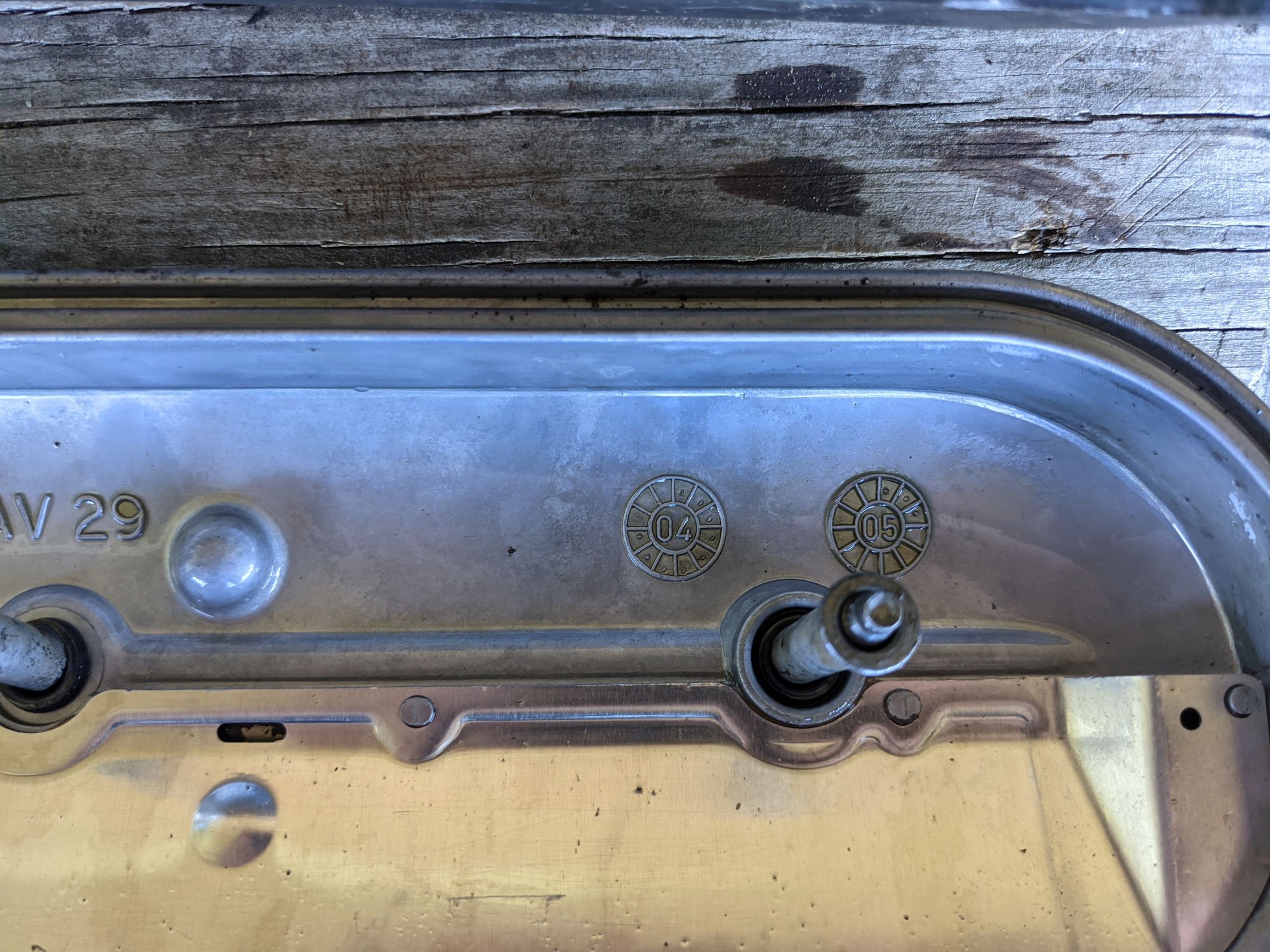

Alright, to update this I did some further diagnostics. Either the Longacre leakdown tester I got is not sealing correctly on the spark plug seals or cylinder 3 bleeds down immediately.
  • The spark plug for cylinder 3 is also covered in oil after cleaning and running for a few minutes
  • Oil is clean so I doubt head gasket
  • Coolant is clean so I further doubt head gasket
  • Still burns oil with intake blocked off where PCV would pull in air
  • PCV fixed orifice does not smoke or have any appreciable blow by as far as I can tell
  • The valve cover baffles look clean
  • As far as I can tell the fixed orifice (PCV) in the valve cover is not replaceable
  • The valve actuate normally and nothing looks amiss in the valvetrain
  • No air comes flying past the valve guide into the valve cover

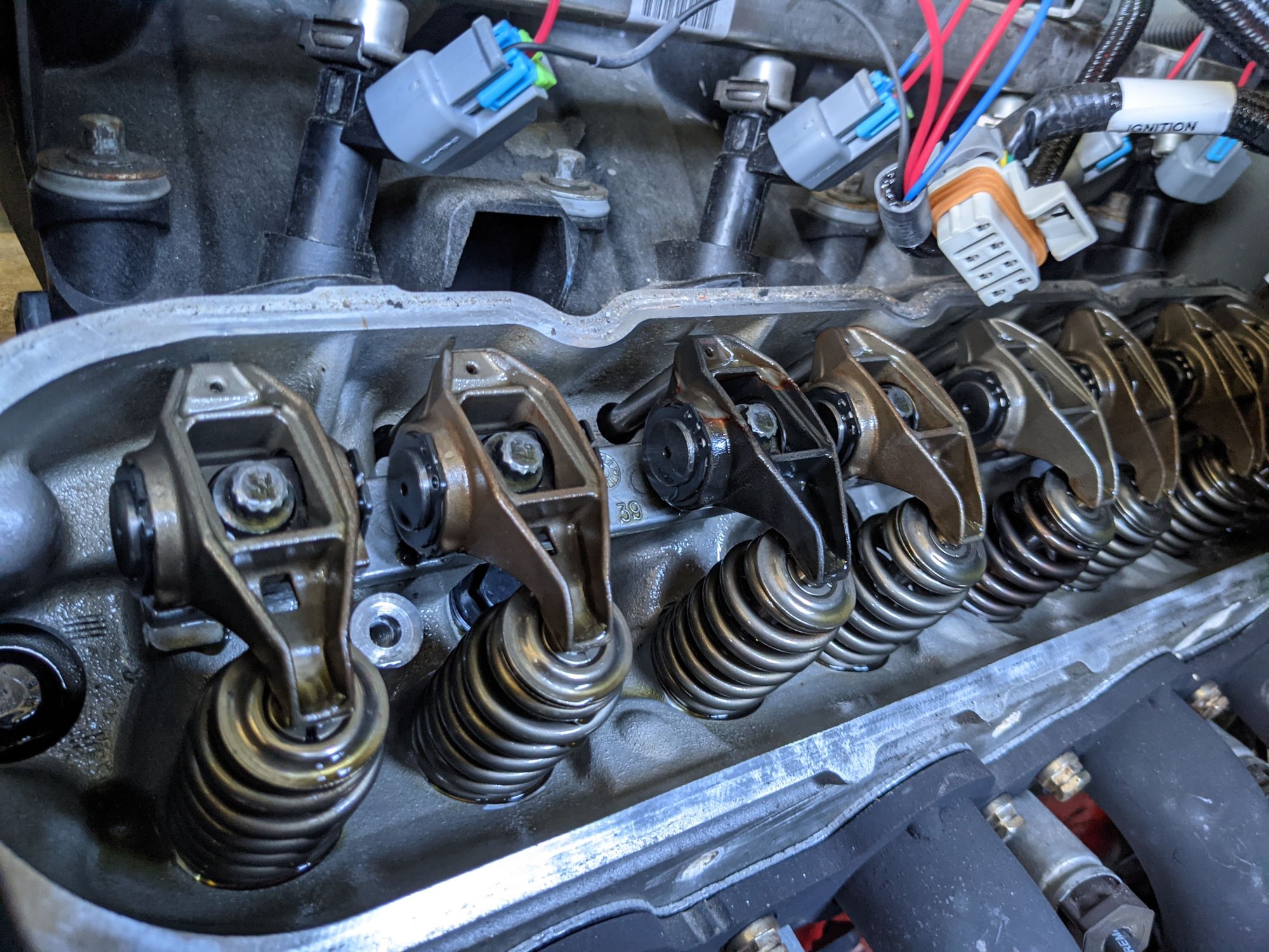

Is that No.1 intake rocker arm that looks to have burnt oil on it and I'm wondering if the oil is leaking through the valve stem seal?
I will have to look harder at it. The intake rocker on cylinder 3 is darker than the rest. Not sure if I mixed and matched parts or if it got cooked when the lifter turned sideways and ground down the cam lobe. That is what necessitated the rebuild in the first place.

What I meant to say was that the No. 3 intake rocker arm as its valve stem seal could be the reason your getting oil like that and its leaking into the combustion chamber. Did you have the heads checked out, especially the valve guide for the No. 3 intake?
I replaced the valve stem seals. Did not replace the valve guides though. If the air comes hissing by there I will just opt for the cheapest AFR heads like I should have the first two around.

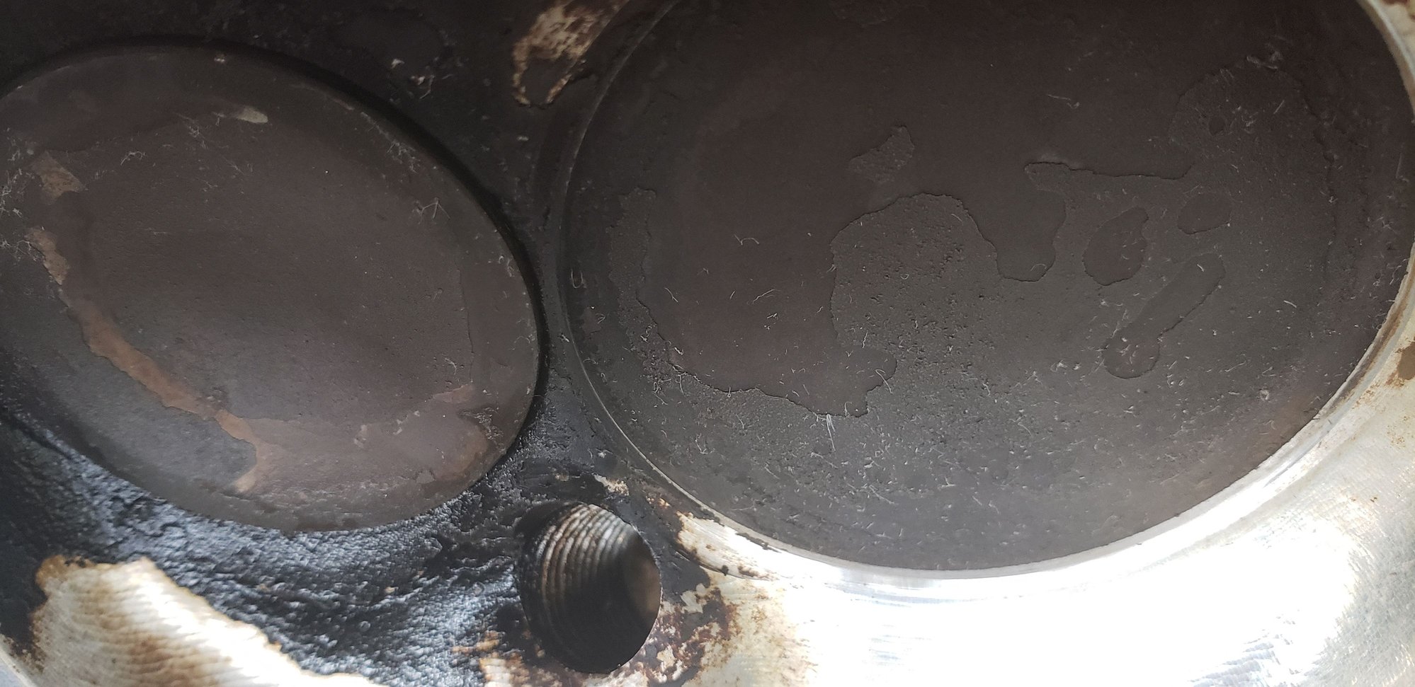

You wont get air thought the guides, but typically on the ones I've chased you'll see a lot of buildup on the stem right below the guide on the valve head if its blowing oil through.
Ah. Good point. The valves will be sealed against the head at TDC.
