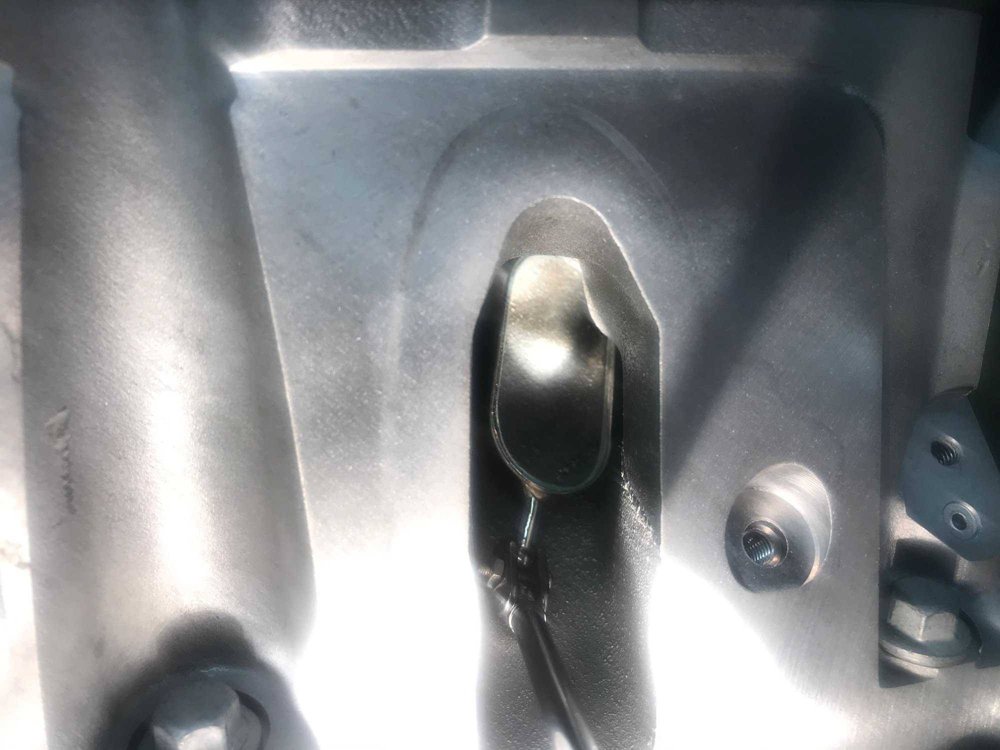

Today I had a really big senior moment, I installed the push rods and rocker arm without the rail and torqued both sides down before noticing what I had done. Please don’t be to rough on me because I’m 63 and this is my first LS rebuild. My question is, could I have mess up thing. When I noticed what I had done I removed the rockers and pushrod then put it back together with the rail installed and it seems ok, but I just wanted to ask.

I dont think 22 Ft lbs hurt anything.

I’d check the intake ports if you don’t have ported heads. Make sure the bolt didn’t crack the heads

I’ll check that today hopefully everything is fine.
I can’t believe I did that.

This motor is out of my work truck with only 120k miles. I finally found my small mirror so I could see inside the intake runners and I think I’m ok.
