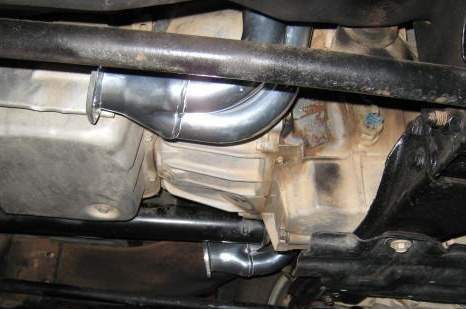

Wink Tri-Y
Originally Posted by Hardcourt
Thanks folks, I’m keeping a list of this stuff to share with whoever I find for another tuner.
RonSSNova I don’t know what’s going on with my private messages, it won’t let me send you one either. Wish I knew a way to get in touch. Sounds like you’re a good local resource.
What are y’all’s opinions on adding Tri-Y headers? Typically they are helpful for lowend torque. As I’ve said, I don’t want long tubes (noise, install hassle, smog problems) but maybe Tri-Y (like Thorleys) would help this cam on the exhaust duration, and help wake up the low RPM torque…thoughts?
Just in case you are looking a Doug's Tri-Y headers. I put a set on my 2002 4X4 Sierra back 2007 when they were ceramic coated. Had to cut back the Y pipe to move the cats back to make them fit. Only headers I could find to keep stock ground clearance as they fit where the stock pipes go. Just a few bottom rust spots from scrapes.
Performance wise, never had the truck dino-ed , but it runs good.
Hope this helps.
pic below is the cut back Y pipe
you should see the grass fly!
