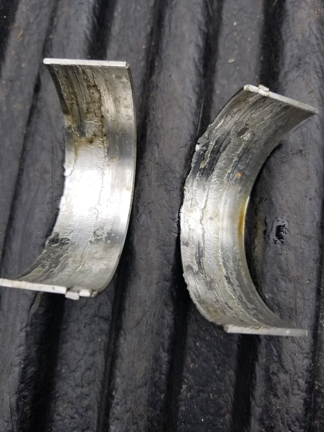

Tapping/ticking can absolutely be a bearing it happened to me. Did the lifters over and sound didn't go away. Ended up being a bad rod bearing.
https://youtu.be/n4DpzoXnfn8
Agreed. The key to help determining the source of a knock or tap location, is the speed or rhythm of the noise in conjunction with idle speed. A bottom end sound will be in rhythm with idle while a top end noise will only be half speed because the camshaft is turning 50% of crank speed.
I’ve heard plenty of rod bearings tick or tap as they start to come apart. Once the rod bearing spins for a few seconds and dissolves basically, the noise will turn to a knock.
