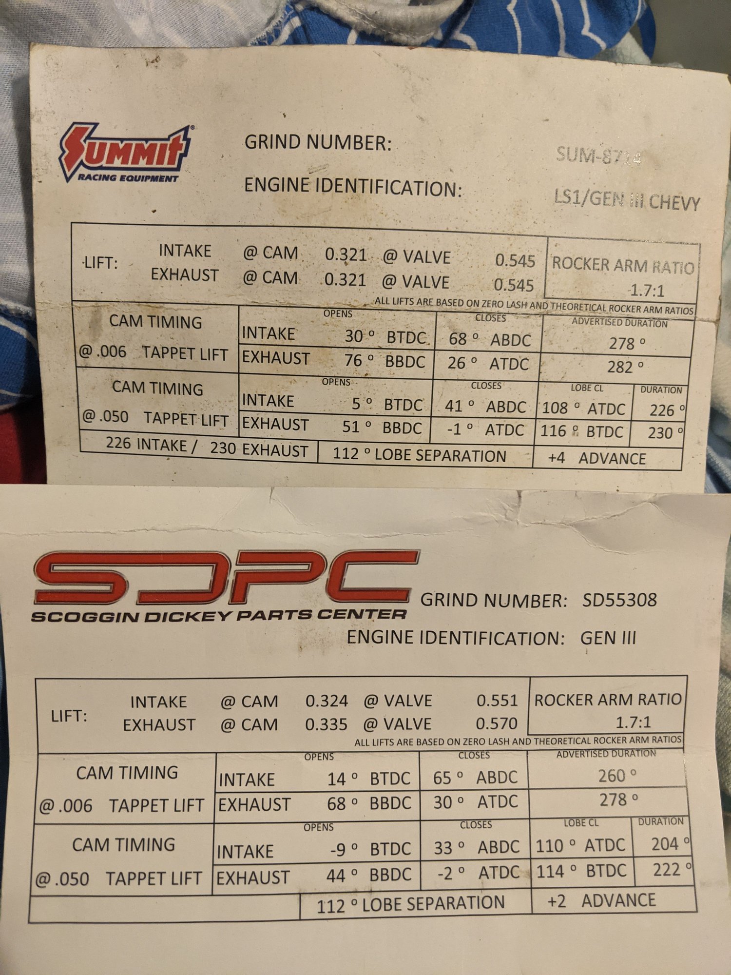

Whats your thoughts on this swap?

Notice the "smaller" cam closes the exhaust valve 4° later at .006, I this is an awesome lil grind
Yea but look at the intake....it looks like it closes after the piston is going back down.......is that good?
Old Nov 18, 2021 | 01:42 PM
  #45
Posts: 22,295
Likes: 3,617
It's closing 33deg. After Bottom Dead Center, so after the piston is just starting on its way UP. Just as it should....

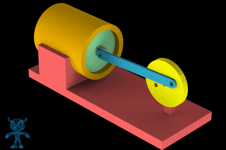

Yes, it's good for getting a little more air in the cylinder before closing the valve if the cam guru knows what they are doing.
Here's why.
Looking at a moving piston animation, we can see several degrees of rotation occur after bottom before the piston barely moves.
The air moving into the cylinder has some momentum and will keep moving into the cylinder briefly even after bottom dead center is reach. Delaying intake valve closing slightly allows a little more air into the cylinder.
The piston isn't moving up enough for several degrees of rotation after bottom dead center to change the direction of the air and push it back out the intake valve.
Carried to excess closing the intake valve would be bad as there of course is a point the piston could push air out if the intake valve is left open too long.
