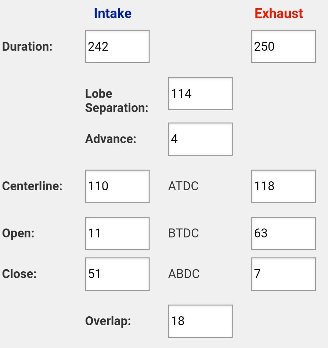

Just wanted to get others thoughts on a cam that I was suggested. I reached out to both Cam Motion and Texas Speed for recommendations on a camshaft. The following is what was sent to each:
"Looking to get a recommendation on a cam for my build. I'm currently putting together an LQ4 block that will have a 408 stroker kit installed, running 11.5:1 cr to keep it on pump gas. Still looking at cylinder heads but will be running something like the TFS 225 or PRC 227 heads from Teas speed. I would be interested on hearing a cylinder head recommendation, if you can make one. Motor will be going into a 3100lb m6 car with 3.73 gearing. The goal is a reliable HP for the street somewhere in the 550-600 neighborhood on pump gas with enough vacuum for factory power brakes. Would you you be able to recommend a cam that would work well with the suggested heads? I am willing to sacrifice some top end power for more under the curve and crisp throttle response. Please let me know if there is any additional information you might need. Thanks"
Bobbie with Cam Motion suggested the following:
242/250 Duration @ .050''
114 LSA, 111 ICL (114+4)
.621''/.604'' Lift with 1.7 rockers
I have not heard back from Texas Speed yet, but I think they are at an event this week.
I am still looking at all the different cylinder heads. This is absolutely a street car first with maybe an occasional run on the autocross. There are so many good heads out there that seem to perform very closely to one another, even within the same brand at different port volumes.
Give me your opinion on the suggested cam and any other cams you think might be suitable for my application. Also any cylinder head suggestions would be great.

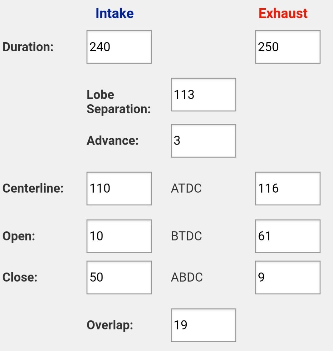

I like the Cam Motion suggestion. I'd run it
Here's my version, based on a Doug Herbert mild solid roller 240/250 I ran in a SBC stroker. I would probably be brave (dumb) enough to try in my planned LS2 cathedral headed stroker.
240/250 Duration @ .050''
113 LSA, 111 ICL (113+3)
.62x'/.60x'' Lift with 1.7 rockers

Damn that's pretty similar. I'm still trying to absorb as much as possible about all the different cams specs and how they change engine operation. The duration numbers seemed pretty high based on what I know so I wasn't really sure how the would effect idle and throttle response/power. When I plug the suggested cam numbers into a calculator, I get a DCR of 9.1:1 with a static CR of 11.48:1. Based on what I've rear, the DCR would be a little high for 93 pump gas.
Cylinder Bore (inches): 4.030"
Stroke (inches): 4"
Cylinder Head Chamber Volume (CC's): 67cc
Piston Dish/Dome (CC's): -3cc (enter negative # for dome)
Head Gasket Thickness (inches): .051 (.038 is a typical value)
Head Gasket Bore (inches): 4.20"
Deck Clearance (inches): 0.020"(.020 is a typical value)
Connecting Rod Length (inches): 6.125"
IVC @ .050": 51

Which calculator is that?
Summit's, courtesy of Cam Motion
