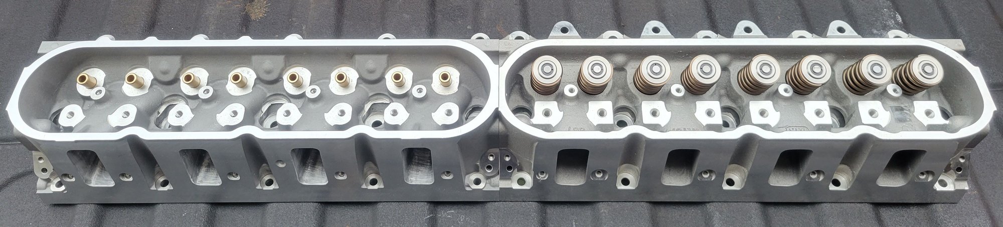

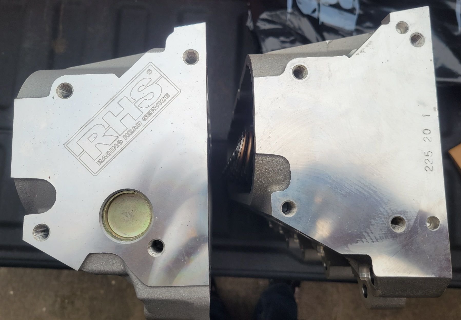

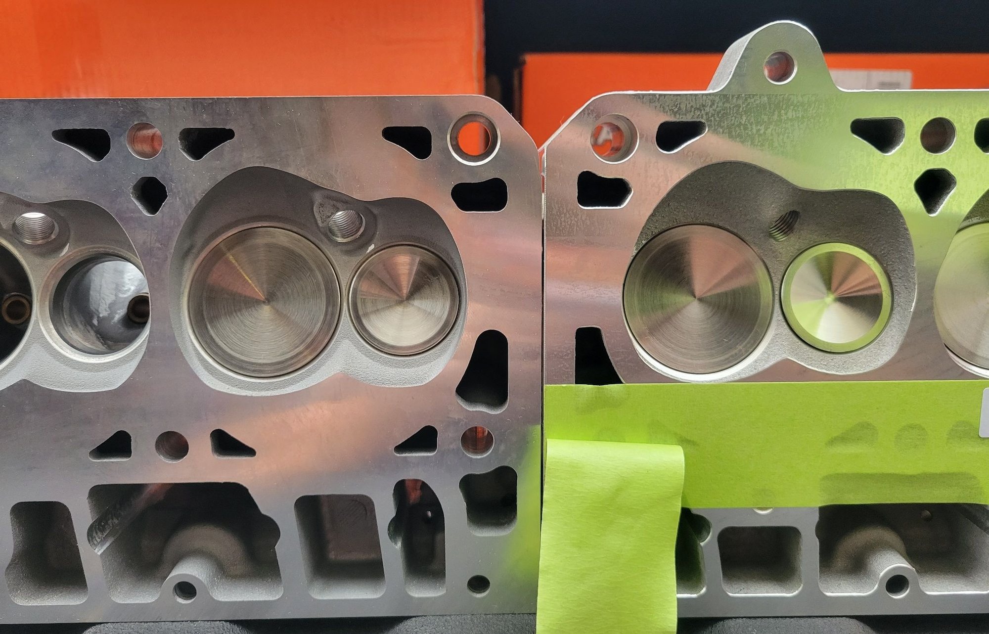

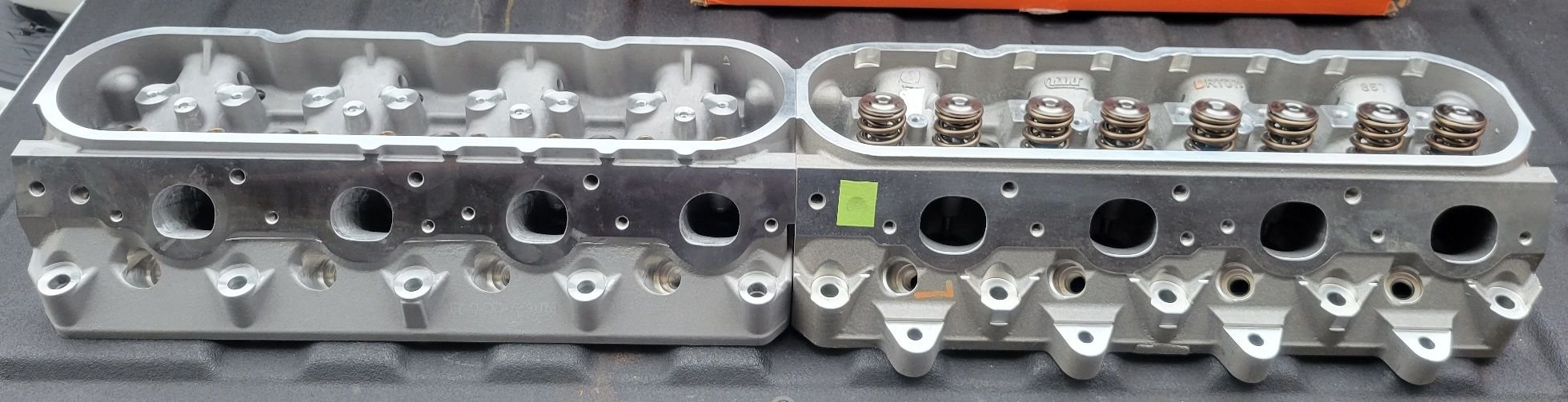

I put the RHS LS3 heads up next to my Dart Pro1 LS3 heads just to show a comparison between the two, in case someone else comes across this post looking for information. Both are the as cast models. Keep in mind, the RHS head is 260cc intake runner and about $500 bare and the Dart is 280cc intake runner and about $900 bare.
