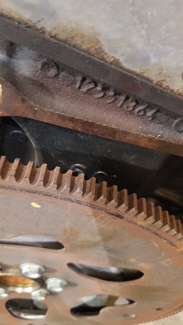

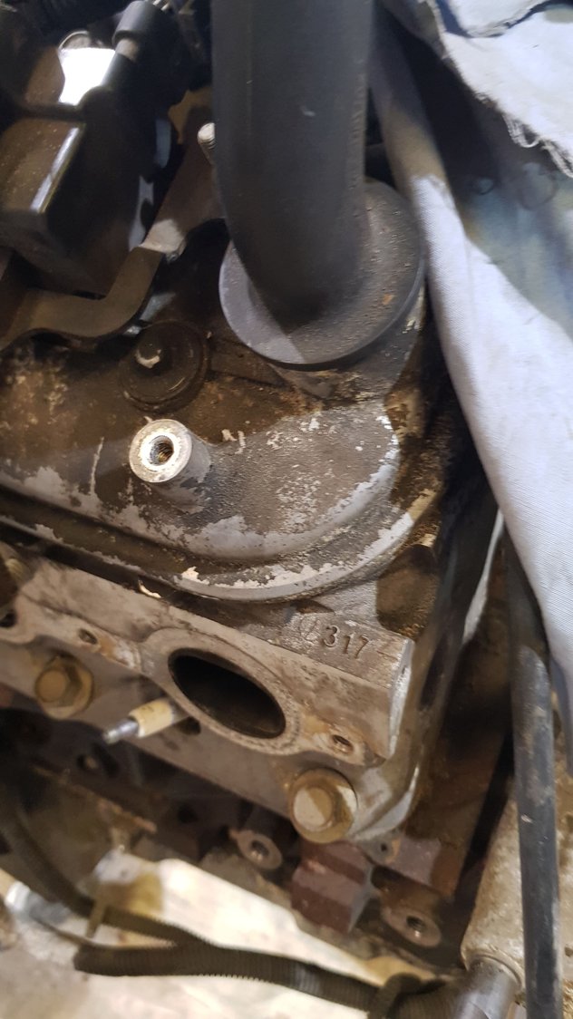

Thats the question... the engine was sold as L96 but when I look at the casting no 12551364 it should be a LQ4. Heads are 317 and look like cathedral ports for me.
Can someone confirm that it is the LQ4?

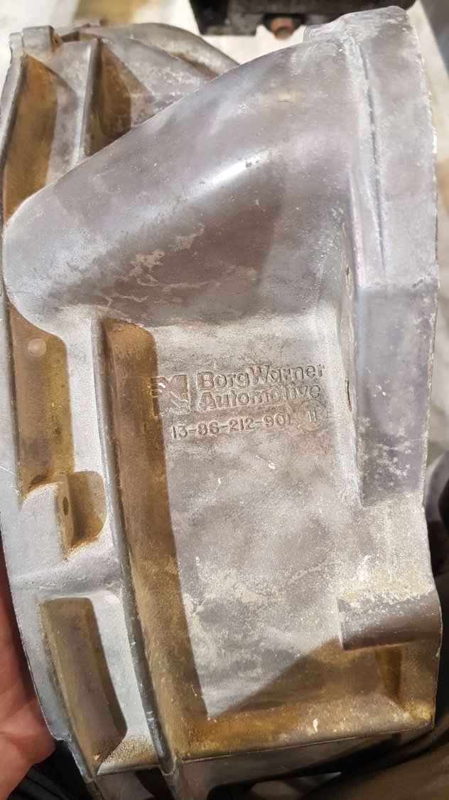

Reason is to identify and find a suitable manual gear. I have a T56 which doesn't fit. The bellhousing seems to be too small.

317 heads are definitely cathedral ports.

The bellhousing is a separate piece, so that has no bearing on which engine this is, which IS an LQ4 or LQ9, strictly by having 317 heads.

L96 is a GENIV with rectangular port heads, 4 bolt 87mm throttle body, and the block casting should be 12576181.
Your picture shows an Intake, heads, 78nn throttle body, fuel rails are all from a GENIII. Probably also has the knock sensors in the valley cover too.

Looks like an LQ4 from the flexplate.
