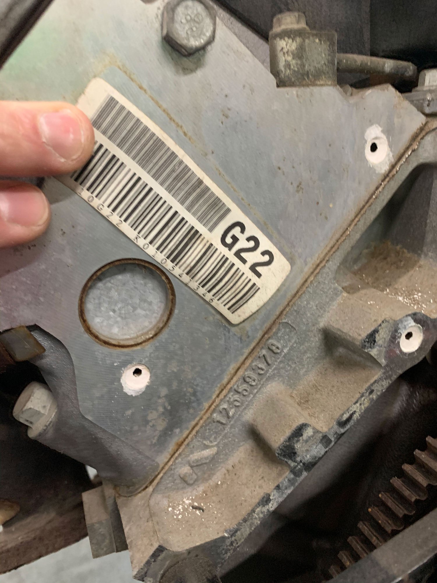

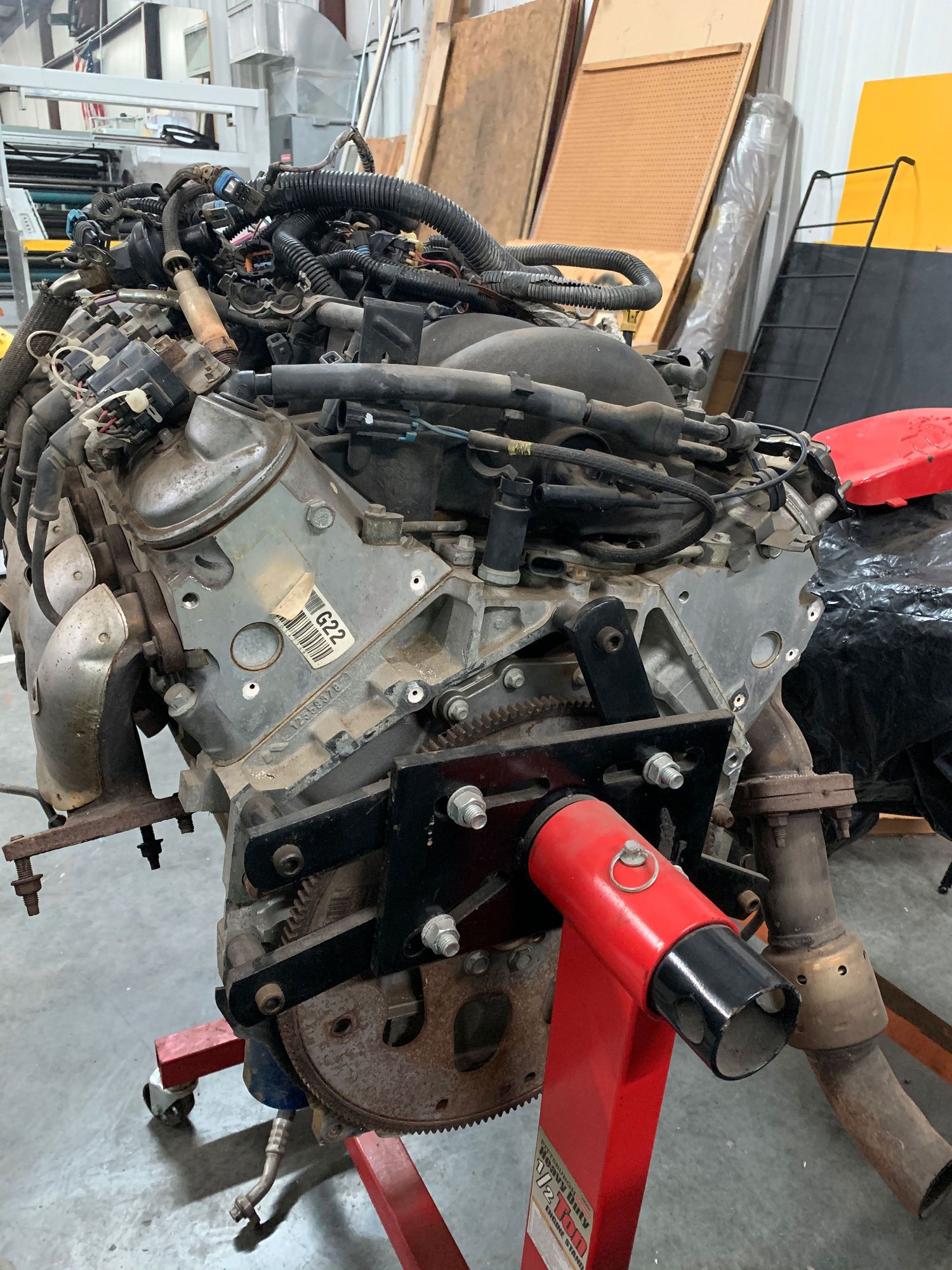

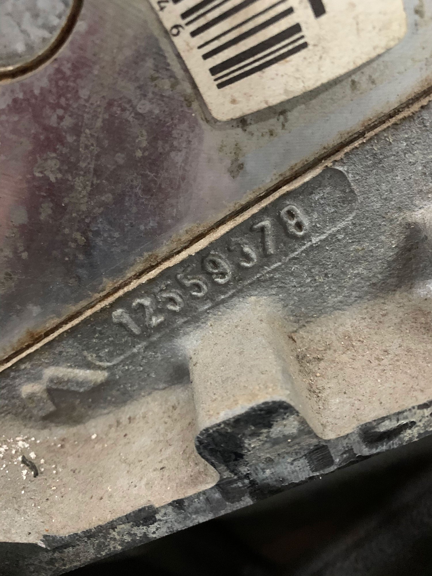

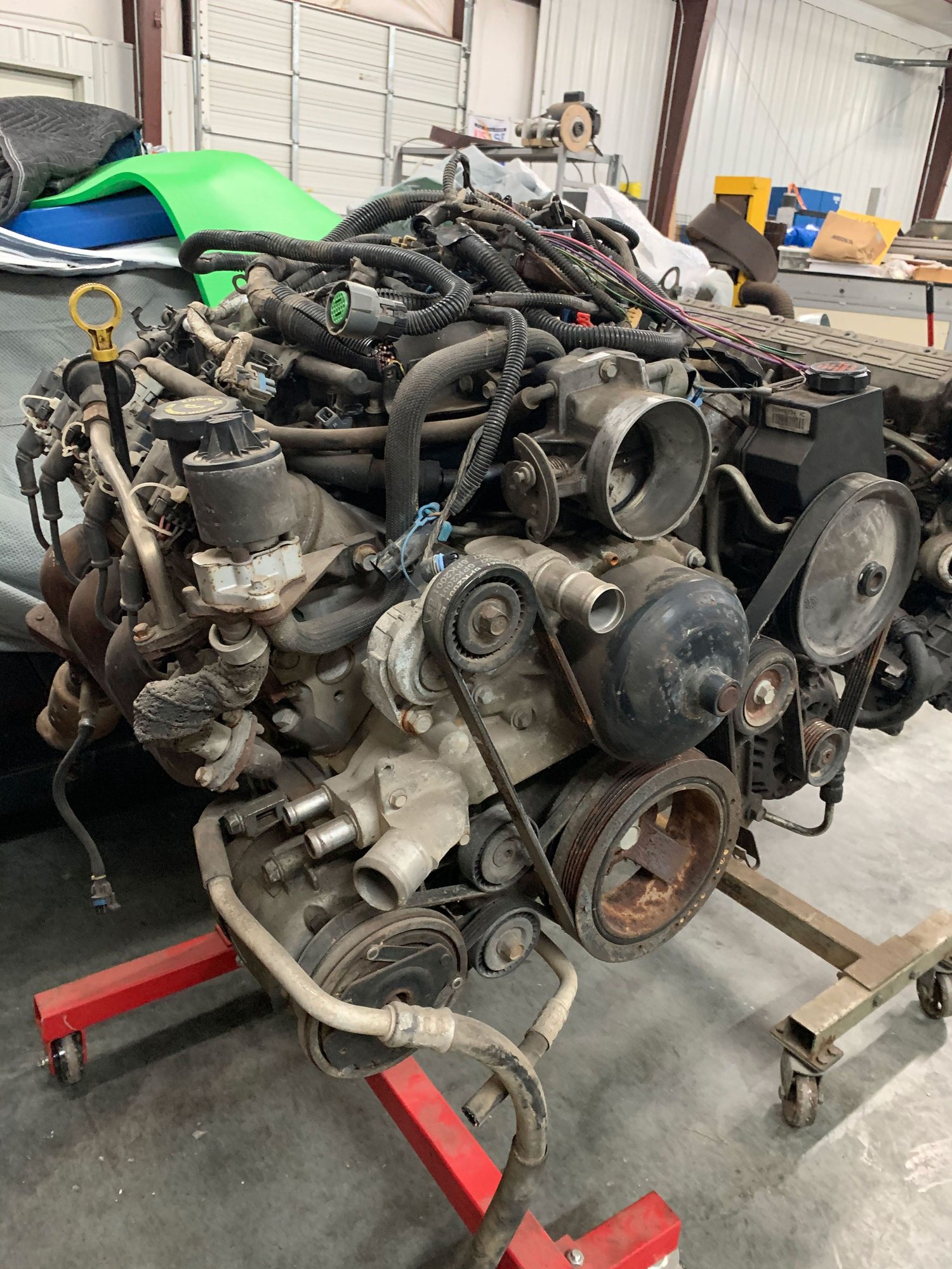

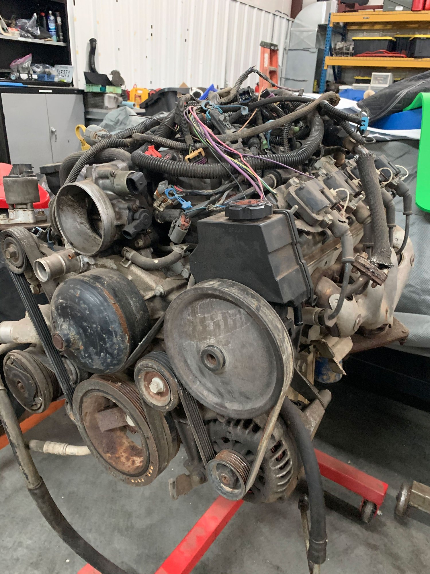

This may have already been discussed here but I don't see it after searching. I have a 2000 C5 Vette with over 240K on the stock motor. A friend bought a 99 TransAm LS1 about 10 years ago to build for a Porsche 944 transplant. He has offered me a swap, his low mile LS1 for my 240K LS1. Since he is building the motor he doesn't care which one he starts with.
I know there are some differences between the motors, the oil pan, the cam. I figure you folk will know the truth here.
1. If I do the swap I want to make sure I'm NOT losing HP. I really want to add it.
2. If I don't do the swap I will fix the rear main leak in my engine along with some other issues and hope it holds together for 10 more years.
3. The Vette is not a race/track car, it's my road dog.
Oh, and I can't spend a crap ton of cash on this either.
Thanks in advance

The pulley spacing is different between the two engines. You'd need to do some swapping around of parts.
